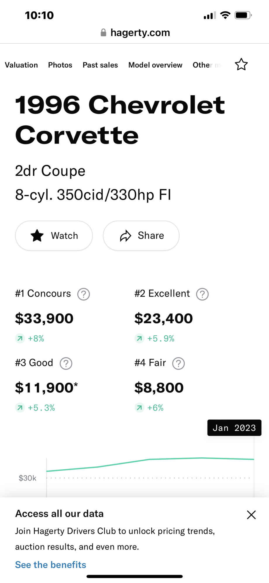

thanks for the info I think the price is good on it it’s just under 30k miles. What would you say a fair price to pay for a clean classic white/red 96 LT4 car? I don’t know much about these as I’ve only owned a 2002 z06 and that was cammed and tuned so it made considerably more power. I’m tempted to pick it up I just don’t want to overpay or be disappointed. I’m not expecting ls6 power but I just know these are a bit more “ “finicky”. They used 1500 more parts on the c4 if I recall over the introduction of the c5 generation.

I would think 18-20K would buy a REALLY NICE 96 LT4 car good luck, I think the 96 LT4 is the best C4 everything considered.

Sorry, I'm not a good judge of price. The only C4 I've owned was heavily modded and bought under special circumstanced. JD's post is probably a good guideline. As far as driving, it really should feel a lot like a stock 97 LS1 C5 in terms of engine power and manners.
