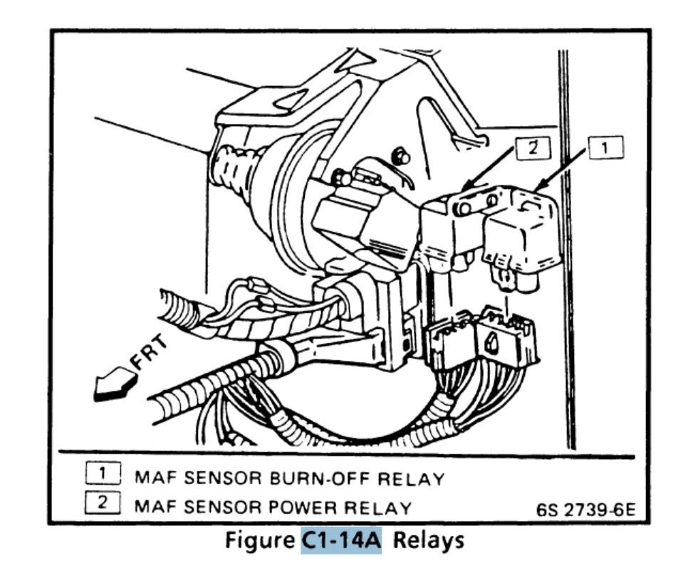

If code 34 check for short to ground in circuit 998 which is the dark green wire going to the (hot wire MAS module. If this wire is NOT shorted to ground then the ECM is faulty.
***The burn off relays are located behind the battery on the firewall next to (C100) the large bundle of wires going through the firewall. I'm not sure which is which since there are two relays at that location. The wire you are looking for is dark green and at the center post of the relay.

""I'm not sure which is which since there are two relays at that location. ""
86 FSM.
