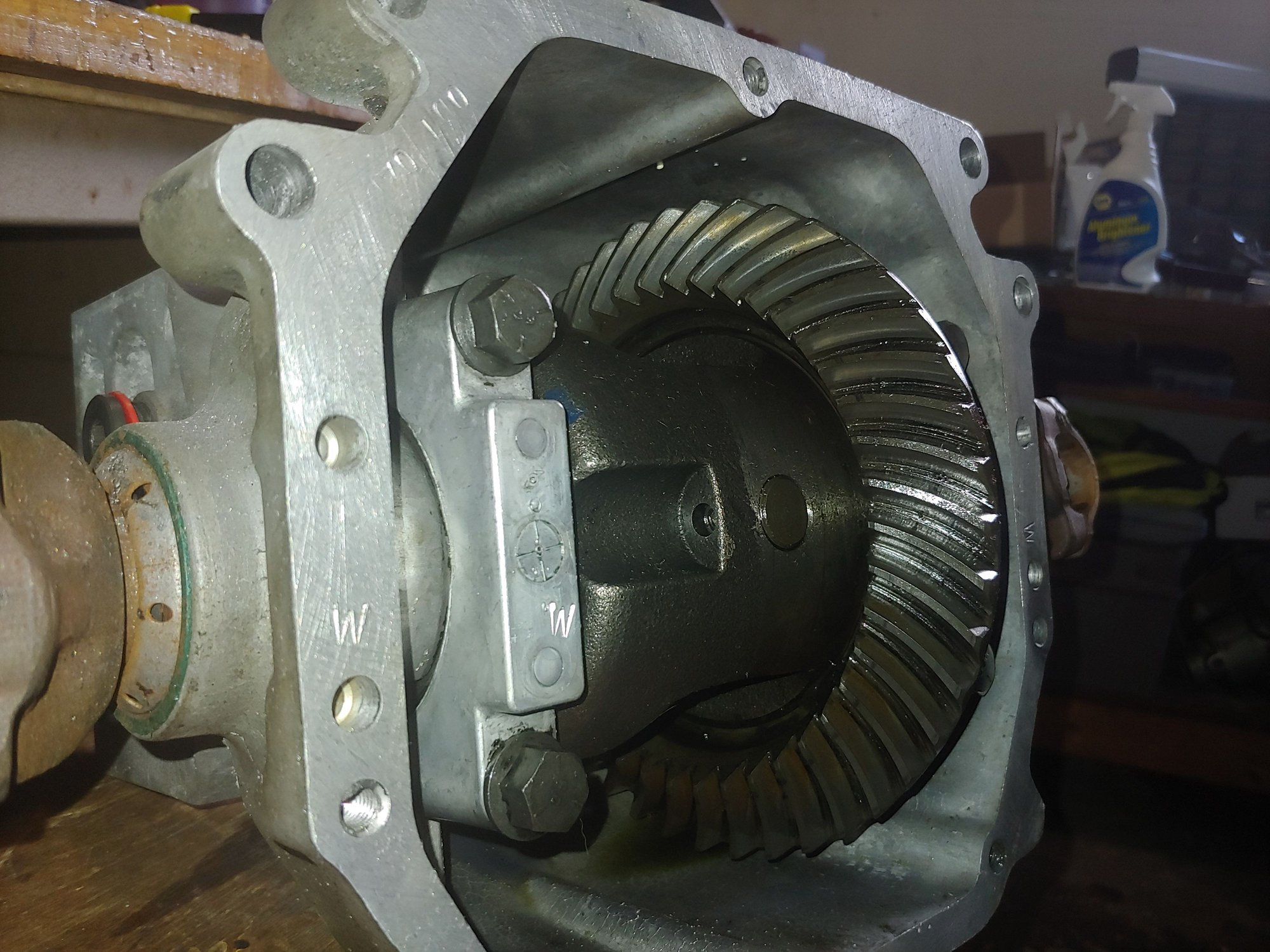

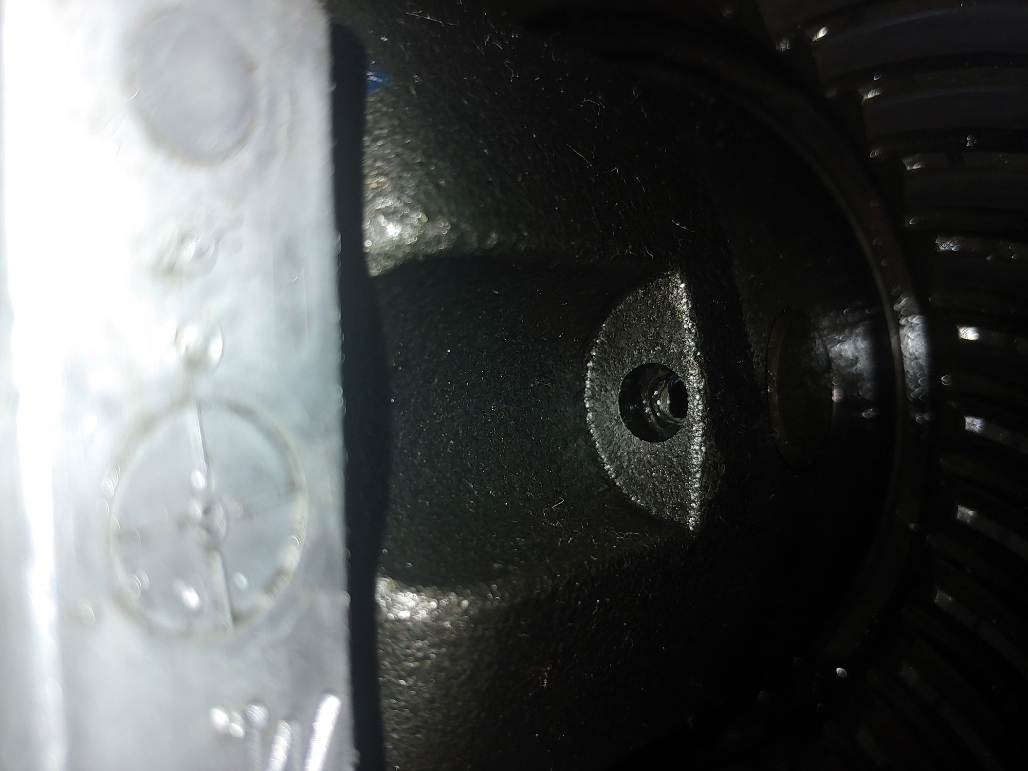

But not just any bolt, the D36 crosspin bolt. I bought a diff here on the forum some time ago and am just now getting around to putting it in my car. When I got to looking at it the crosspin bolt is broken off. I'm a little leary of using it anyway. No telling if it might work it's way out under use so I need to get it out. Problem being, there is no straight shot at it with an easy out since it is below the surface of the diff housing. How do I get what is left of this bolt out? Thanks in advance!! And now I need another bolt too......

Can you post a picture so we can see?

OK, I'm an idiot. It isn't broken because my old diff is the same way. I was expecting the same bolt like any other GM carrier. So the FSM says to knock it out using a punch but has the diff out of the housing first. Is this thing supposed to be a PIA to put new seals in? At this point I'm thinking toss it in the car like it is.

Have you already bought the seals etc? Did you clean it or did it arrive like we see it? How many miles were mentioned when you bought it? Was there any seeping of the seals noted when you received it? There wont be a more appropriate time BUT ............
**** Rock the short-axles back and forth. If you see no play/wobble etc. with the pinion shaft maybe you do just 'go for it' . If you decided to reseal it there's 2 small pinion washers that here we would normally replace and consider it maintenance.
