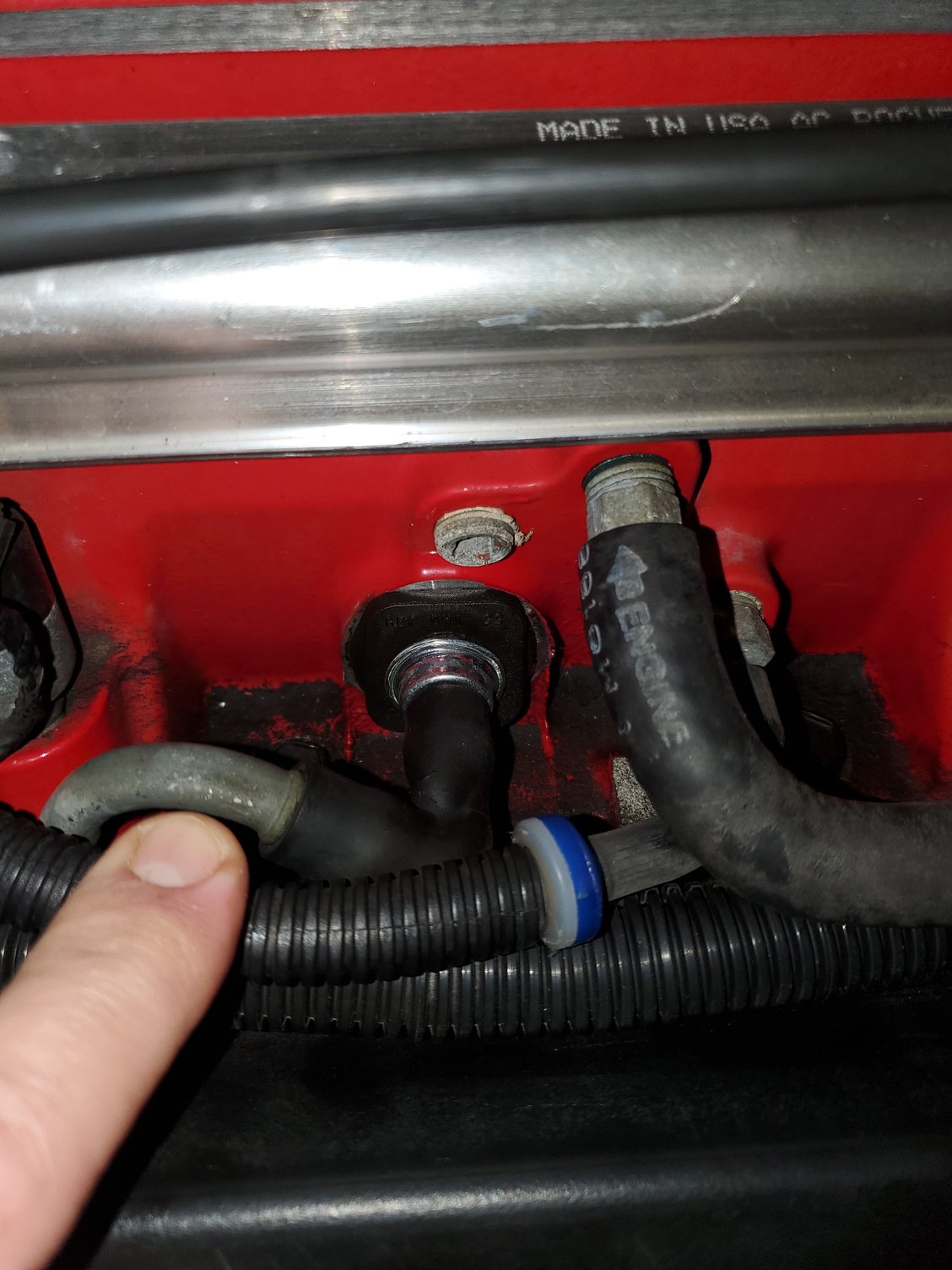

Team,
I need to replace old and cracked PCV pieces in my 96 LT-4. Would you please guide me in the right direction?
See pics below.

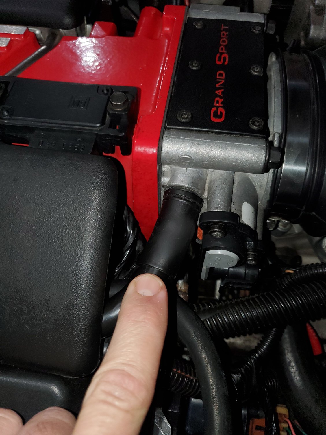

90* PCV hose
Rubber hose connetor piece on passenger side

The elbow (1st snapshot) I don't believe was ever offered for the C4 by itself and was part of the pipe GM# 12556257. There's likely something that could/should be out there.
https://www.wholesalegmpartsonline.c...roduct=2665068
Does the pipe in snapshot #2 go to the right valve cover for PCV control or where? The elbow & pipe from throttle body I thought went to the Purge Solenoid. That originally is a GM# 12551611
https://www.wholesalegmpartsonline.c...roduct=2664232
My man!
The first part looks like part 561 on the exploided view.
The second part (tube) does go into the side of the passenger side valve cover...looks like part 547
I wonder if I can find a piece of hose or replacement elbows at the local autozone.
Ric

By the way, the purge solenoid hose is right below the one I'm pointing to on the 2nd pic. It's imossible to see in that picture though.

Originally Posted by rremesal
By the way, the purge solenoid hose is right below the one I'm pointing to on the 2nd pic. It's impossible to see in that picture though.
GM# 12550624 is the PCV to the right valve cover. See eBay and use the part number.

For picture 2, I just bought this red 15/32” (12mm) hose to replace the heater hose and worm clamp from the PO on mine. I know it’s not original but I like the red to match the intake. https://www.ebay.com/itm/17472533178...mis&media=COPY
