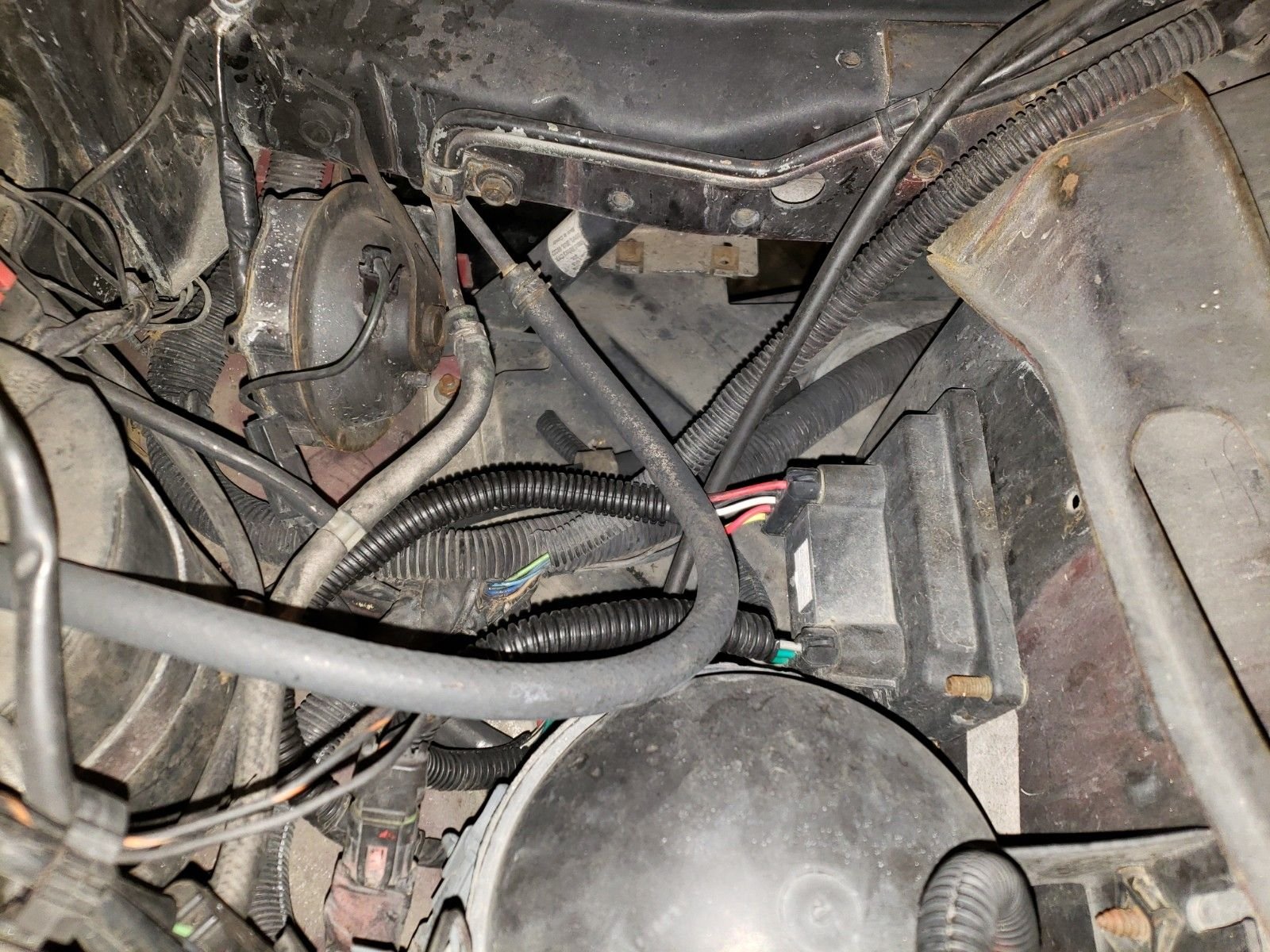

I swapped my 84 headlights with mid-90s back in the mid-90s. As I recall it bolted up, no body modifications, you only need to replace the old headlight controller with the newer one, located in the front/left/driver corner of the vehicle. I *LOVE* the sound of the newer headlight motors, and they haven't been touched since I installed them so long ago, very durable. ZERO downsides, its all good.

Some pictures showing the new controller mounted where the old was and the new motor.
