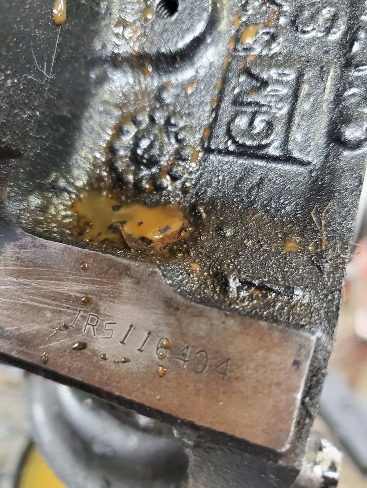

1.) It would be good if someone with a known Corvette LT1/4 'out of car' would post a very good image of the VIN Derivative. Regardless a Corvette LT1/4 the first 3 digits of the VIN Derivative would be 1X5xxxxxx with 1=(Chevrolet), X=N(92),P(93), R(94), S(95) or T(96) and 5(BGR) followed by xxxxxx(sequence).

Originally Posted by IHBD
I know your The King and are never wrong, but Bowling Green doesn't stamp Corvette engines in the same location that St Therese stamps Z28 Camaro engines.
I never said they did and I only use that image so that people understand a VIN Derivative. A few years ago you called me out regarding VIN Derivatives also. You were wrong then.

didn't flint build all LT-1 engines. they would have stamped the assembly date and suffix code at the same location. the final assembly plant would have stamped the vin

Today someone dug up an old thread started in 8/2008 and a 'one time' poster in 7/2021 posted this image that was found on a '94 LT1 and very likely I believe a 'vert with this VIN: 1G1YY32PXR5116404. I deleted the F body image I had posted earlier just to clean up the thread a little. Now if someone had an LT1 from a B-Body full size car and could confirm it's VIN Derivative location with a snapshot I believe it would be safe to say it would be quite easy to know the source of at least the block.
