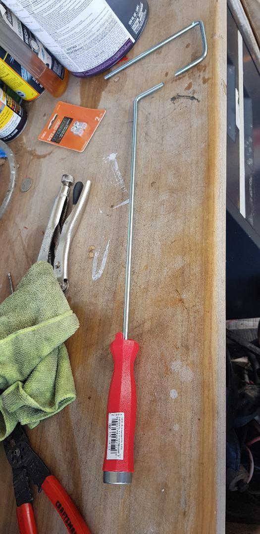

ok i got a tool for us c4 guys, easy to make and i also got the emergency cables too on my c4. you just never know 1993 c4. let me try post pic.

home depot paint roller 22 inch long, $5.99 cut off excess. done. worked the first time i tried it.
That is just brilliant. Thanks for the tip. Should be added to a tips section.
Here is a link to it. It is called 11" but total overall length is 22" in the description.
https://www.homedepot.com/p/Unbrande...3-22/202097492

i just stand it up behind my driver seat and the center console.
