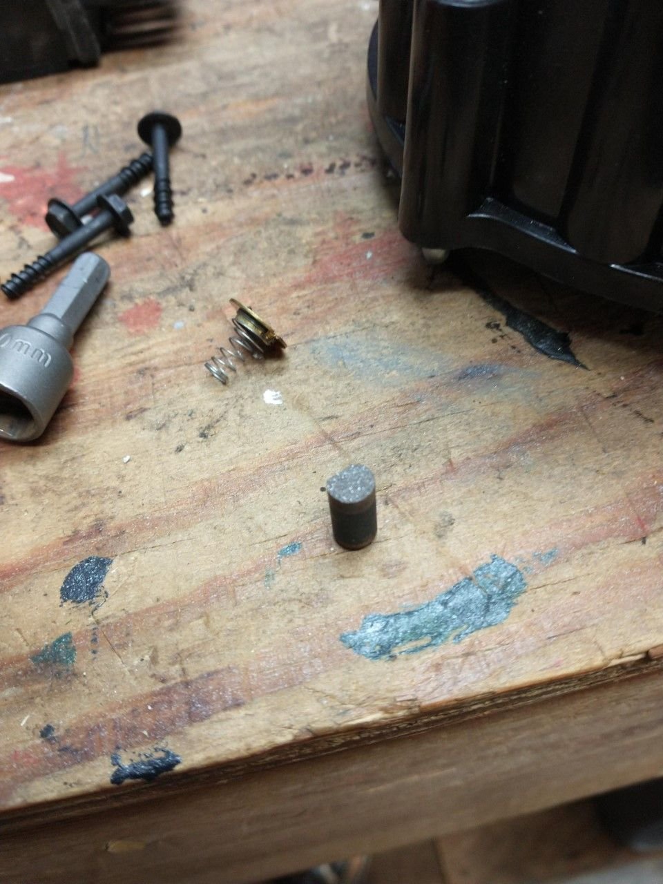

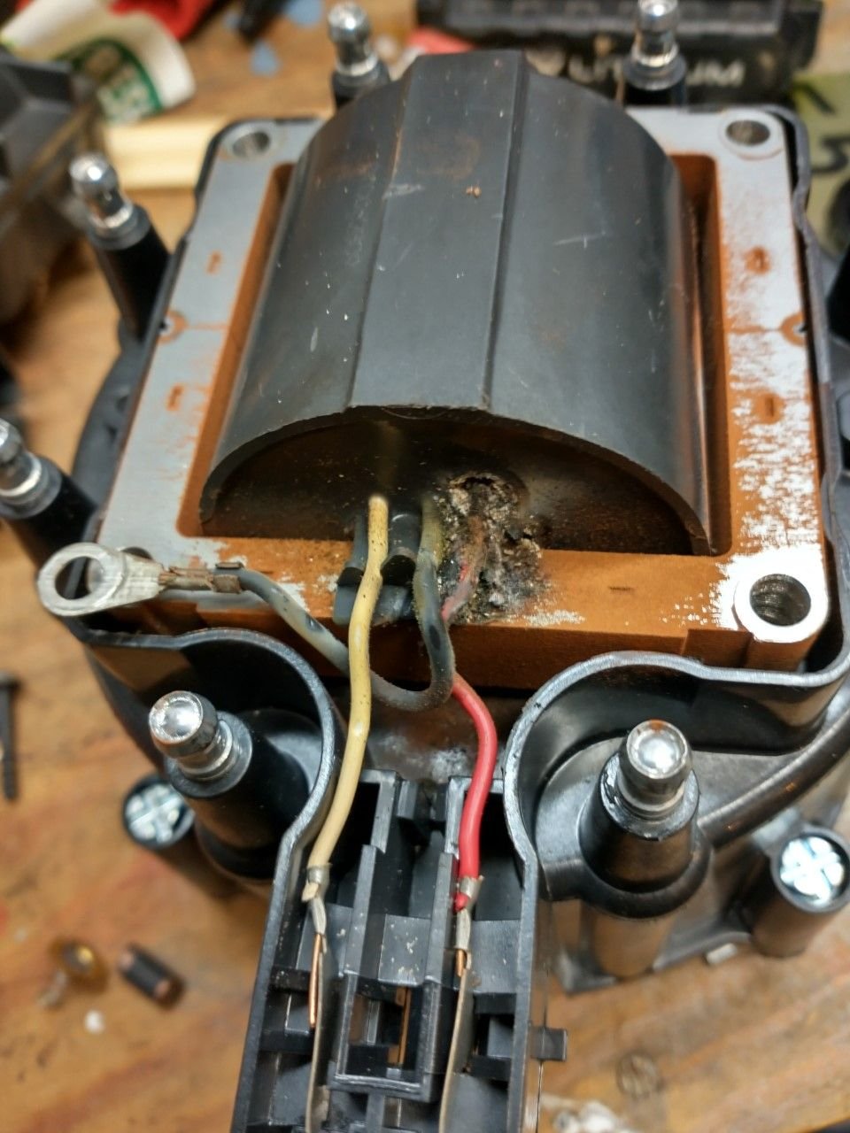

Hey guys, so i got home from work and was going to take the corvette out for a run. I started it up and it idled for about a minute then died. It wouldnt restart. It would only crank but not fire. I went through my FSM and was knocking things off the list and went to check spark. There was no spark. So i pulled the distributer cap off and these pics are what i found. What would cause this? These are replacement GM parts i got from rockauto last summer. Not sure if this was the issue with hot start but it definitely caused my car to die today. Should i buy the GM coil again? NGK?

Is that rotor button broken off the spring? Is that red wire burned?

Hey Tom, when initally took the cap off i saw the broken off rotor bushing laying on top of the rotor. i knew there were issues at that point, then i take the top off the coil and i see what you see here. Red wire burned and charred up. Is this just a coil malfunction?? Like i said i bought it at Rockauto last summer, it doesnt even have that many miles on it. It was genuine GM

It seems like it's either high resistance in the wire (poorly connected to the primary winding), or low resistance in the primary winding of the coil. 1. seems more likely to me. Bad parts.
IDK...try whatever...it's a crap shoot, now days.

Kinda what i thought, i have the original factory coil i replaced, nothing wrong with it and it looks brand new. I may just stick that back in there. I have a gut feeling it is more reliable than most new parts today.

OEM ignition parts are unbeatable. If you have the OEM stuff, and it works, use that.
