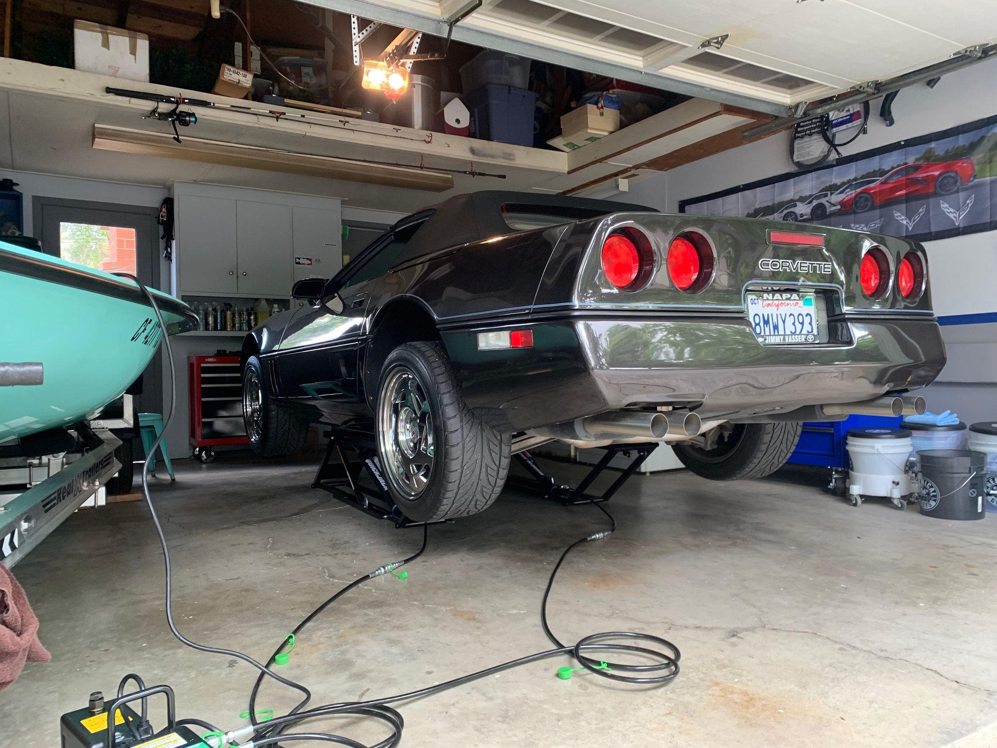

the C6 was more accomdating because of the design of the undercarriage, the C4 was fine, just place the rubber blocks on the pinch welds. I'll look and see if i have some good close-up photos of a car lifted. I didnt have any good photos but I had 2 videos where I use it. in a nut shell, works just fine for the C4...fyi they are HEAVY, about 80lbs a side and i needed to stand mine up on end to save garage space (everytime I used them) so it was a workout which is why I sold them, juice wasnt worth the squeeze for me (at the end of the C6 video I show the lowering process of the car and what I had to do to store them).

Cut the nubs off 2 of the pinch weld blocks to clear the rear body parts and plumbing. Rear is tall block and nubs, front is short block with cut up blocks to match height.
Bought some pinch weld blocks because i didn't know the jacks came with the dimpled/lego blocks.
Cut out the left front block out to clear plumbing that runs along that pincb weld. You can clearly see the marks left by the pinch welds, the blocks squeeze down a bit requiring the mods. This is on a 1990
