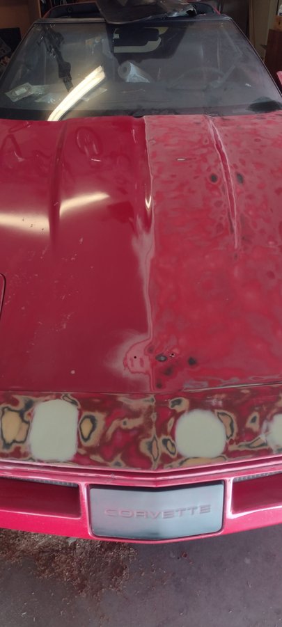

Here you can see the waves in the front bumper cover quite well last fall

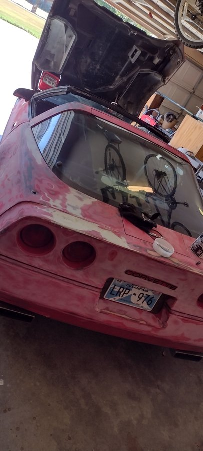

If you look at the rear bumper you can see some of the waves it had, the deepest was on on the driver's side where it is sanded down to primer in the pic, it was 3/16” deep measuring off a straight edge
Here is the front bumper cover getting filled in. You can see the horrible peeling clear coat on the hood, which was one of the main reasons for the repaint
Here is just a picture I took where I'd busted thru half the clear coat on the hood and had worked a few coats of filler on the bumper and sanded a few times. Nowhere near flat yet
