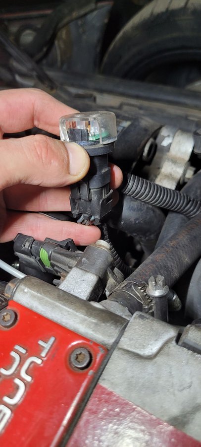

1.With car i get interesting device - its plugs in idle runner plug and blinking (will try add photos and video) - can someone tell me for what operation I need use it?

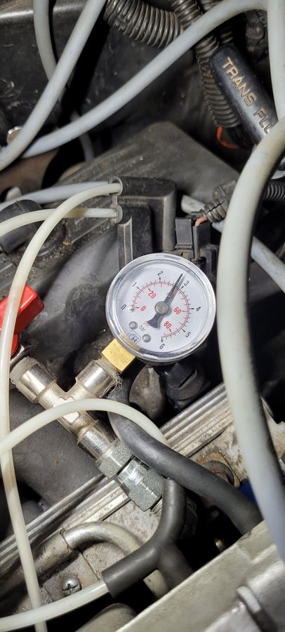

3. FUEL pressure is ok for this car?

- Fuel pressure should be around 35psi - 40psi (240 kPa - 276 kPa) or (2.4bar to 2.75 bar) with the vacuum hose removed from the fuel pressure regulator and plugged. The pressure should hold after the car is turned off

I have no idea what that device is that plugs in and blinks. I'd remove it.

Pressure looks OK.
