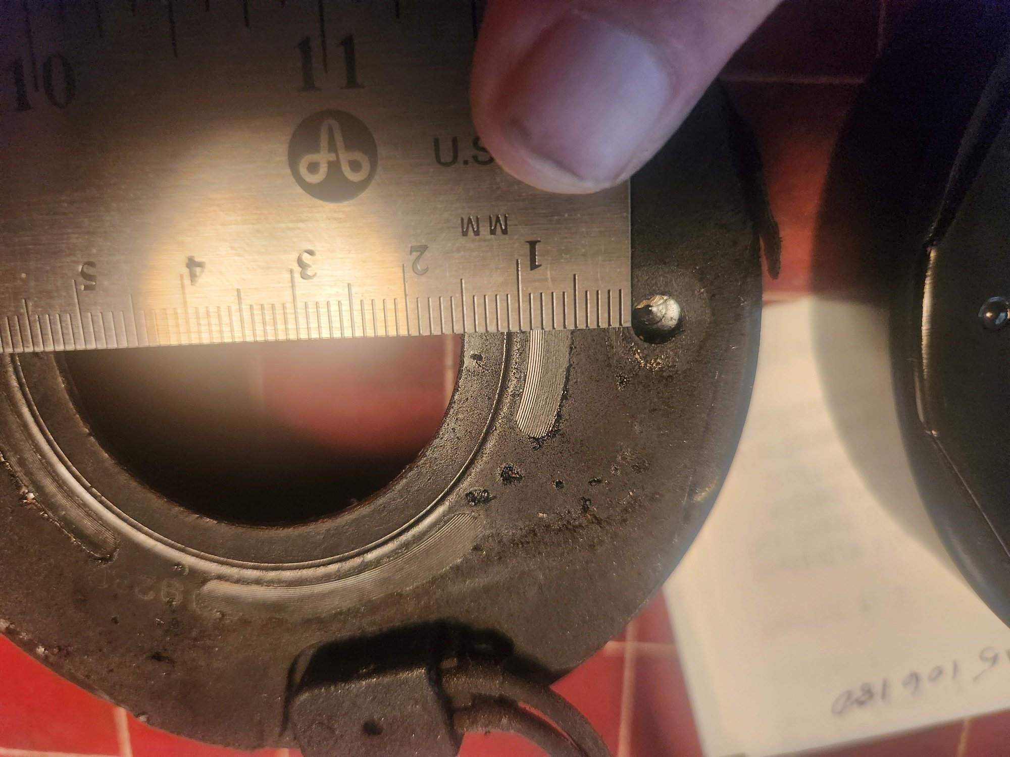

Is there any corvette specific junk yards? I'm looking for either a AC coil or the clutch assy. for a 10PA 20C compressor

I bought a new one from RockAuto about 3 weeks ago for my 92. $90, it arrived 4 days later without me having to drive around, and it fit and worked. Be sure to check the air-gap. I had to add some shim to get an appropriate gap. .018-.022. The electrical connector was also different; I cut my connector off and spliced, soldered and heat shrinked it to the new coil. Almost undetectable.

Most wrecking yards are going to see the AC compressor with the engine. You might find a complete compressor in a yard. Try here for a search https://www.car-part.com/

Thanks guys I found a complete compressor for "drum roll" 30 bucks. Figured out that my com was bad too. installed the used compressor pumped it down , charged it . Now it's running great.
