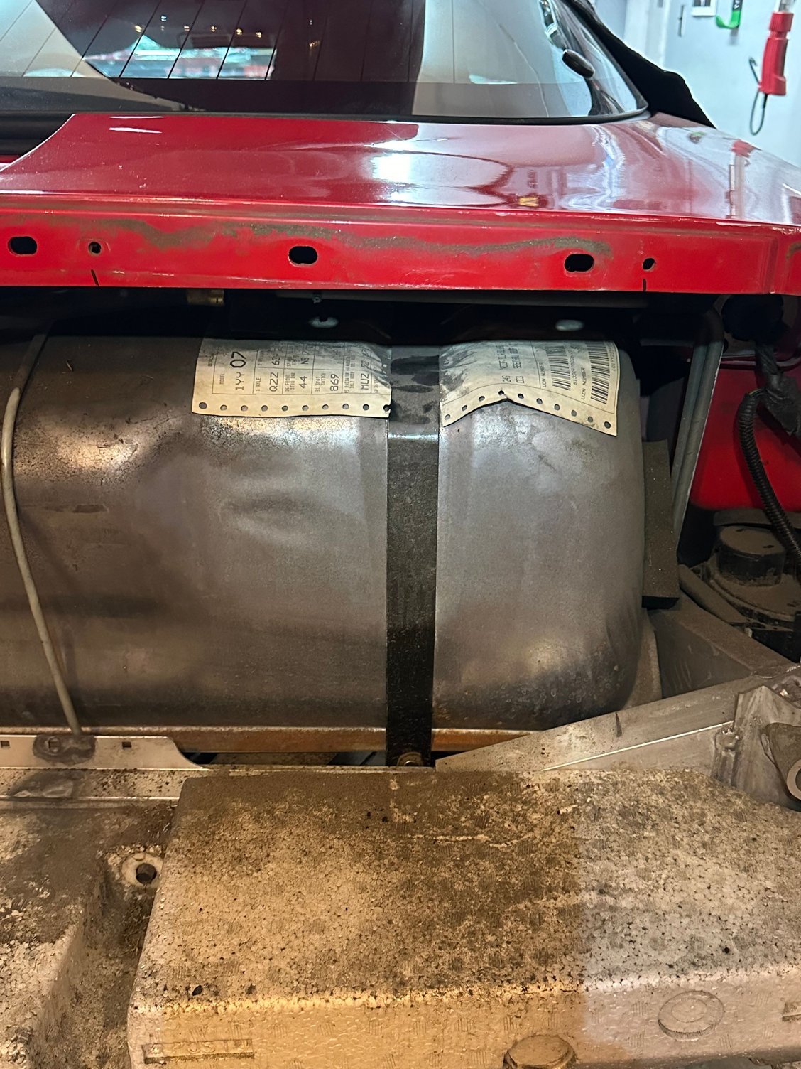

I'll be finding out soon. After reading your how to on doing this, I discovered my fuel tank has a leak. New one gets dropped off today. Really blind sided me, this car has been garage kept its whole life.
Well you can kill three birds with one stone. Grab the build sheet, replace the leaking tank, and with the tank out you can probably have access to some serious cleaning👍.

Oh yeah it's getting a proper cleaning. I'll be replacing anything rubber I find. God damn FedEx really damaged the new tank. It was packaged terribly so I can only blame them so much. Couple of bends where the upper and lower sections of the tank are put together. Not sure if I should even bother with returning it for another.

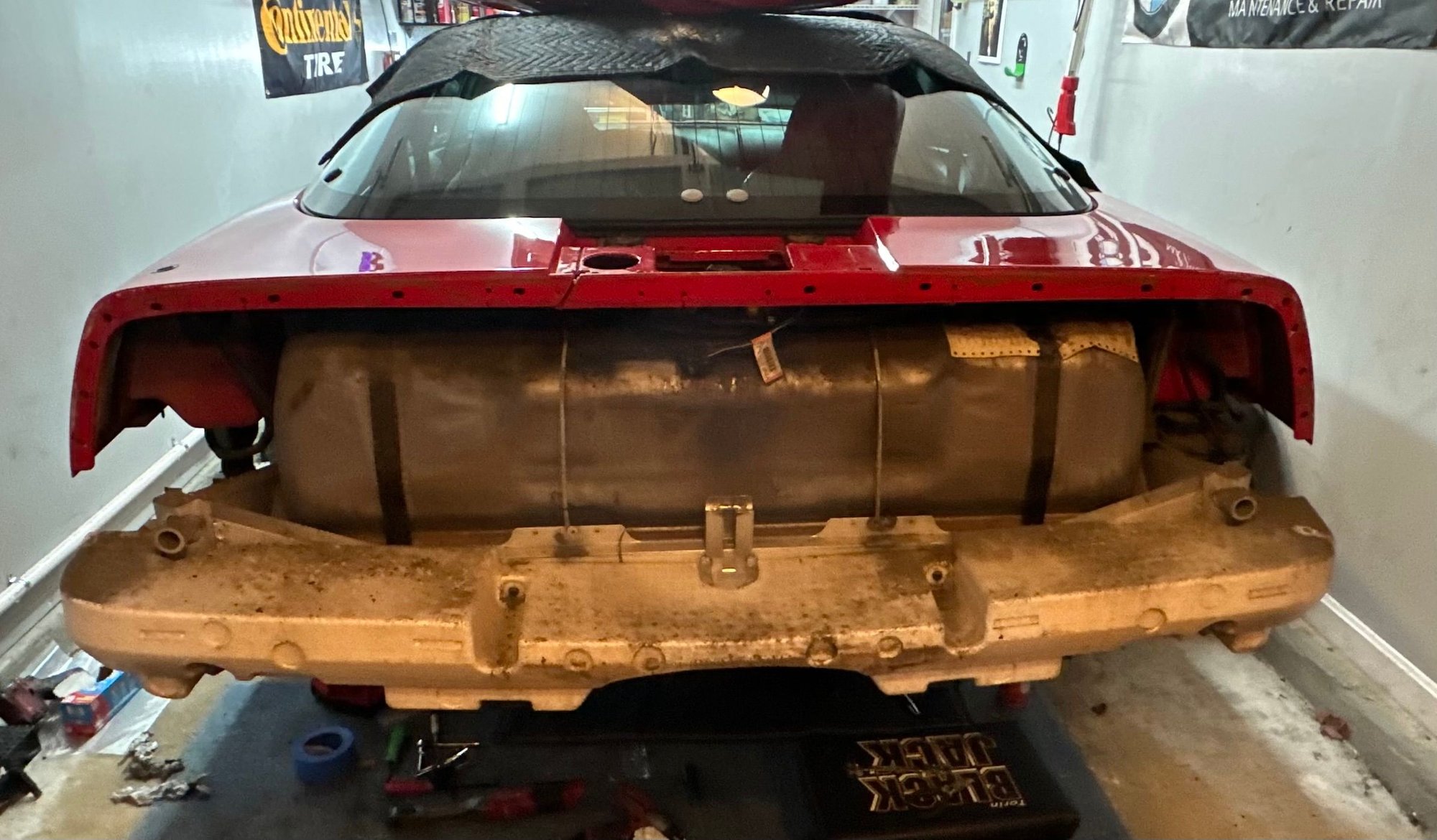

Well I finally got to it. Tank is getting dropped tomorrow. Build sheet seems to be in excellent condition.
How's your project coming along?

So far so good. Everything came out ok, nothing broke. I'm hoping the reassembly goes just as well. I'm replacing all the bulbs and cleaning everything before putting the new tank in.

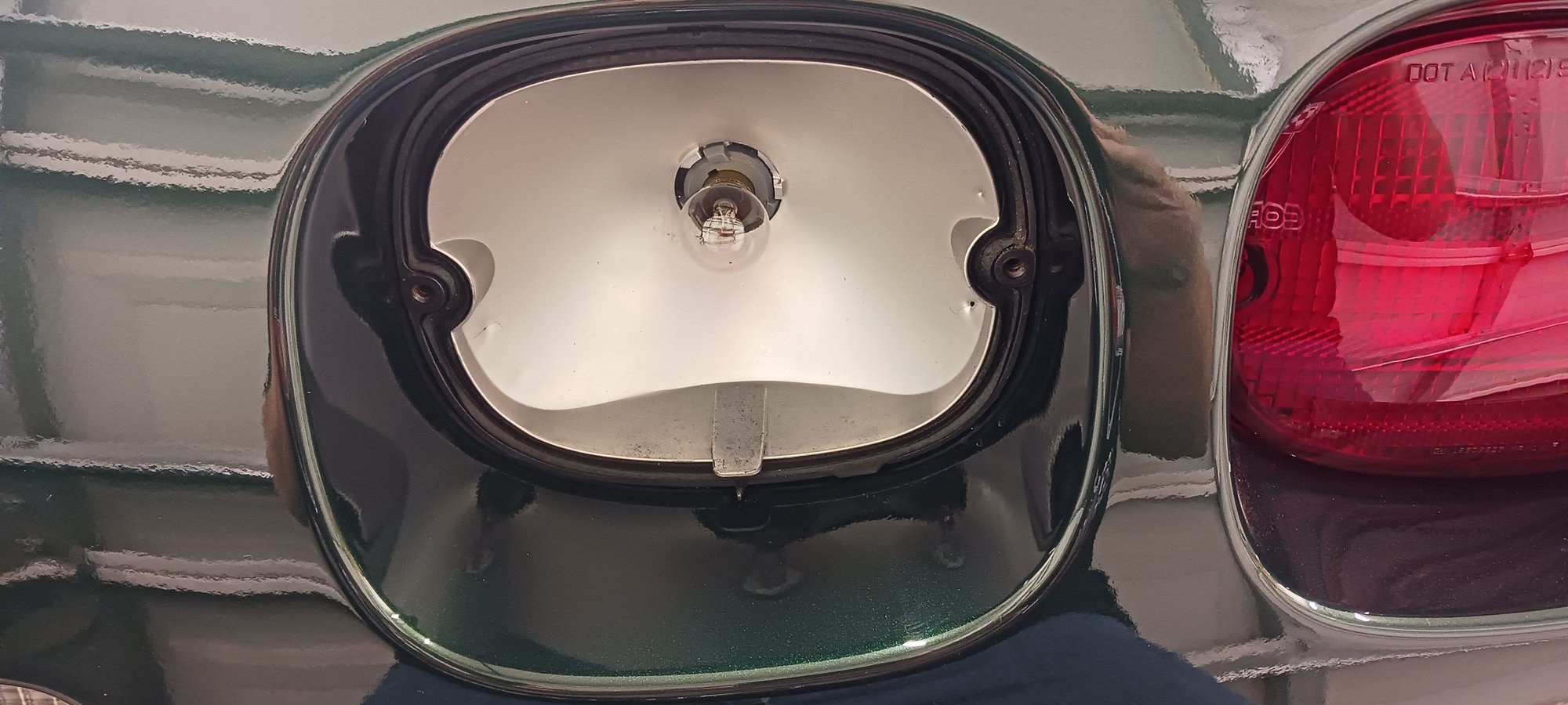

By removing the lens you're able to use the bulb as a grab handle, which makes it a lot easier to safely remove the housings once they're unbolted than if the lenses were still in place:
Never had an issue with this, and couldn’t imagine spending the extra time on that.

Can you remove the housings without removing the lenses first? Yep. Is it easier to remove the housings without scratching anything by removing the lenses first? Yep.
...and couldn’t imagine spending the extra time on that.
It took me maybe sixty seconds just now -- from lens in place, to lens removed, to lens back in place -- to grab the two pix I posted above. Your mileage may vary.
