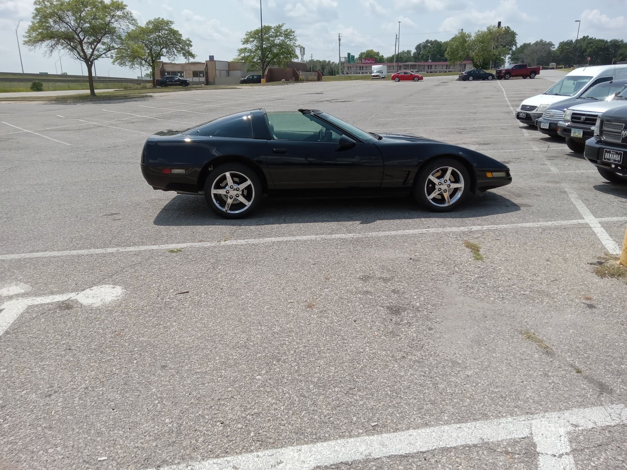

This is my late Dad's 96 C4 that my boss bought me
