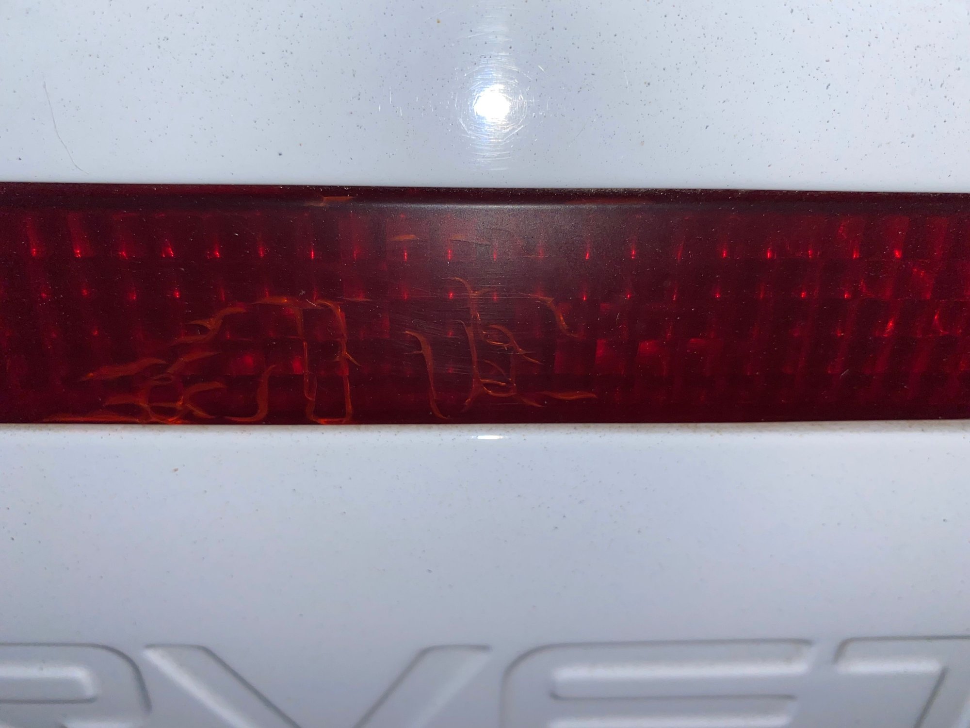

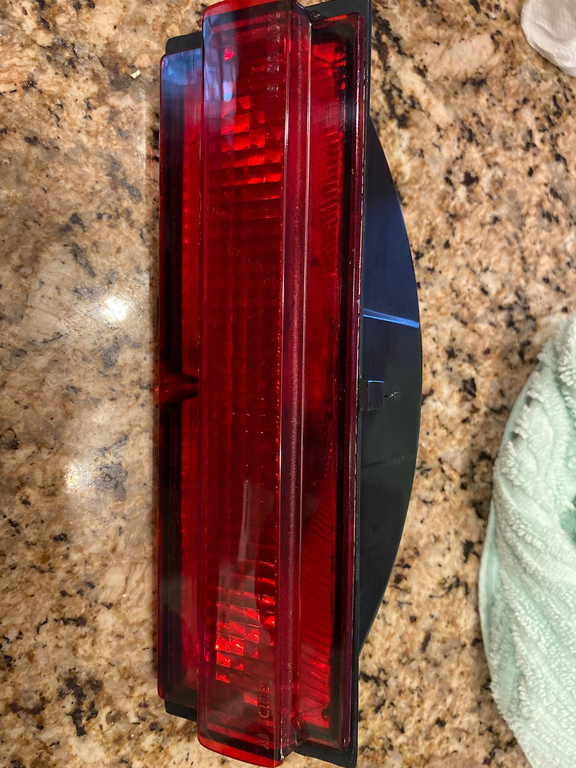

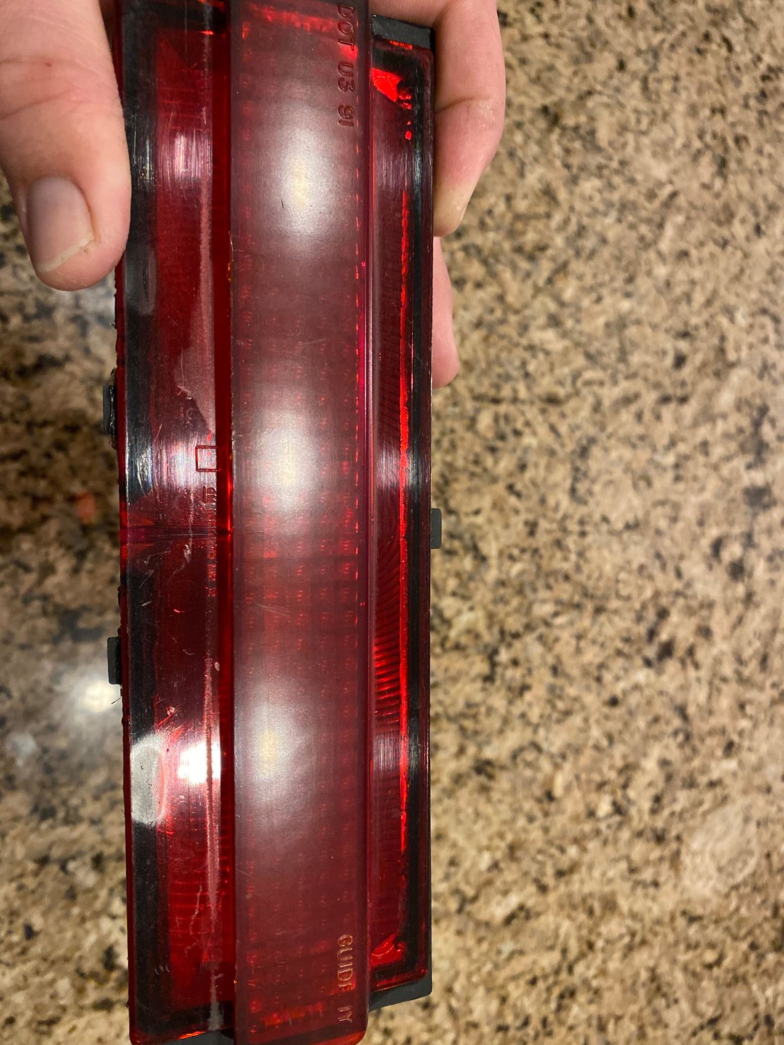

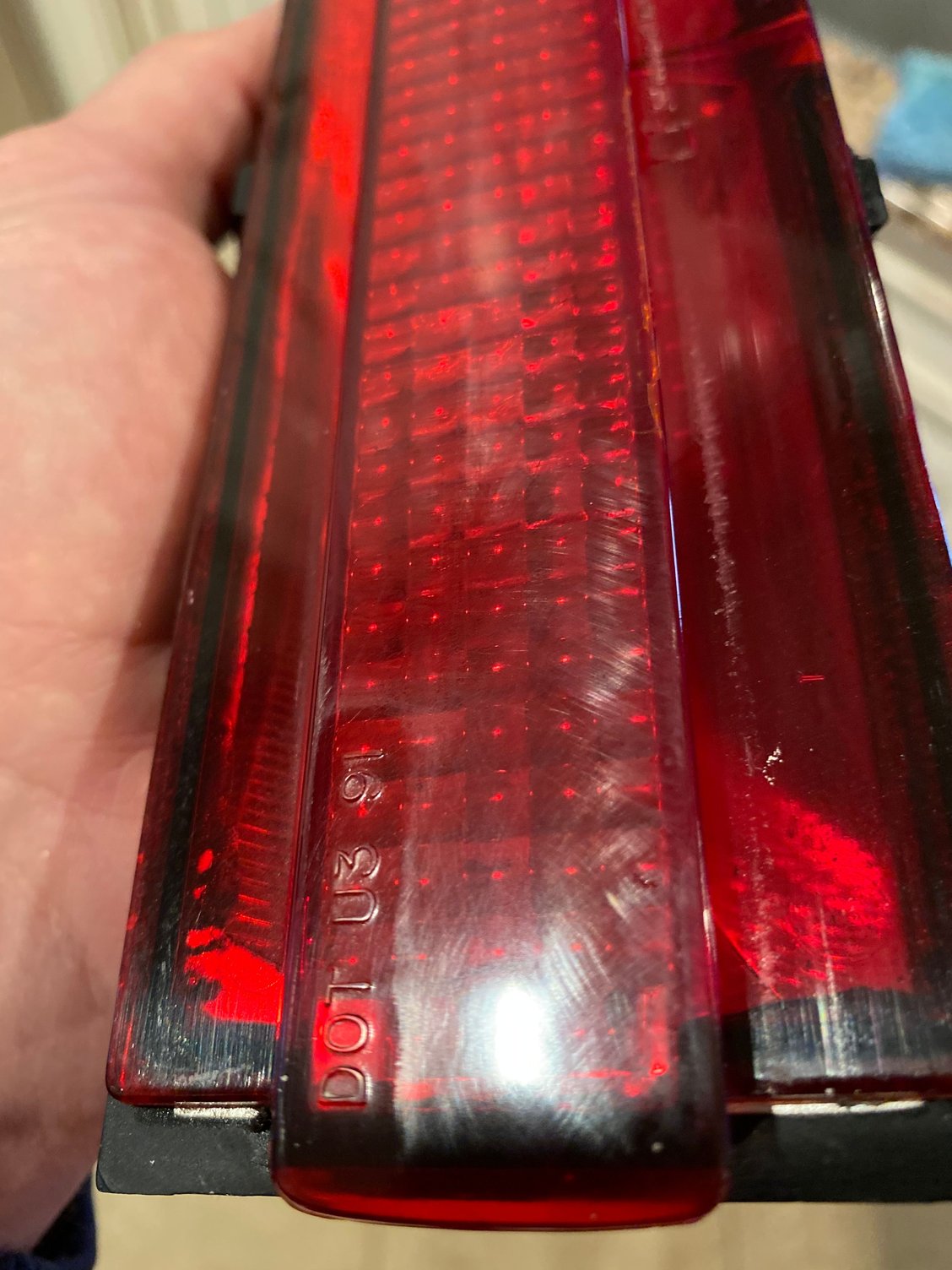

Some will say I’m nuts and just should have bought an LED housing. Maybe so! But a couple hours of work got me what I was after. See below.
Old assembly in the car.
Close up of old assembly in the car. Note how dull it is and the crazing actually runs all the way through. It was not restorable.
The new to me housing after cleaning, prior to surface restoration. Zooming in, you can see the minor surface crazing causing dull appearance.
After wet sanding with 800 and 1500. Some swirls remain that the compound will remove.
Finished product after much buffing with the compound and power ball.

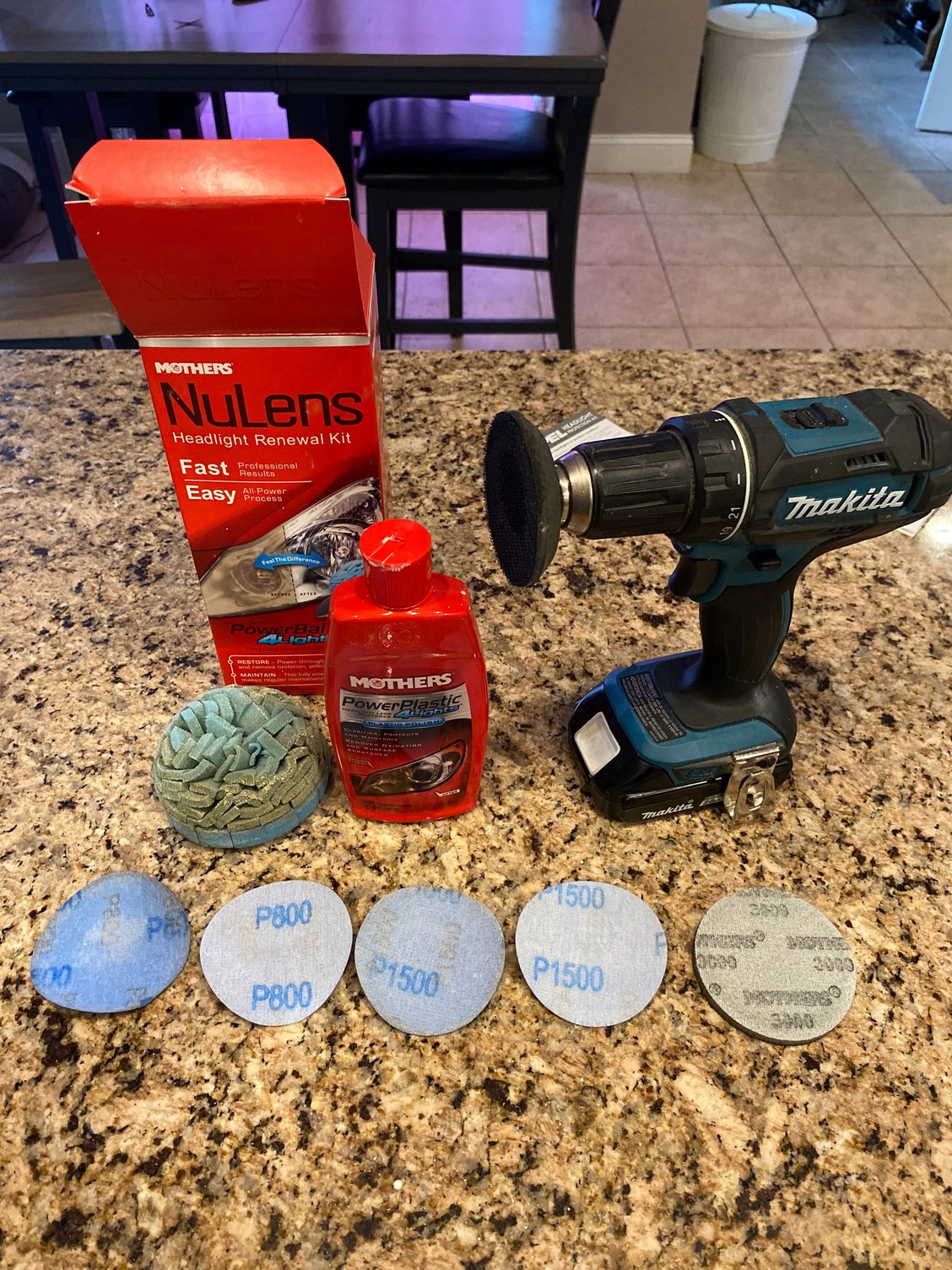

Default Here’s the Kit
Mothers NuLens kit. Comes with 2 800 grit pads, 2 1500 grit pads, a reusable 3000 grit finishing pad, power ball, compound, and the sponge backing plate which is mounted in my drill. The sponge back plate retains water for wet sanding and works awesome. You’d have to try hard to run the surface dry and melt the plastic. . I have done multiple headlights and other projects and have replaced nothing so far. It’s cheap and it works on anything plastic. Enough said.
