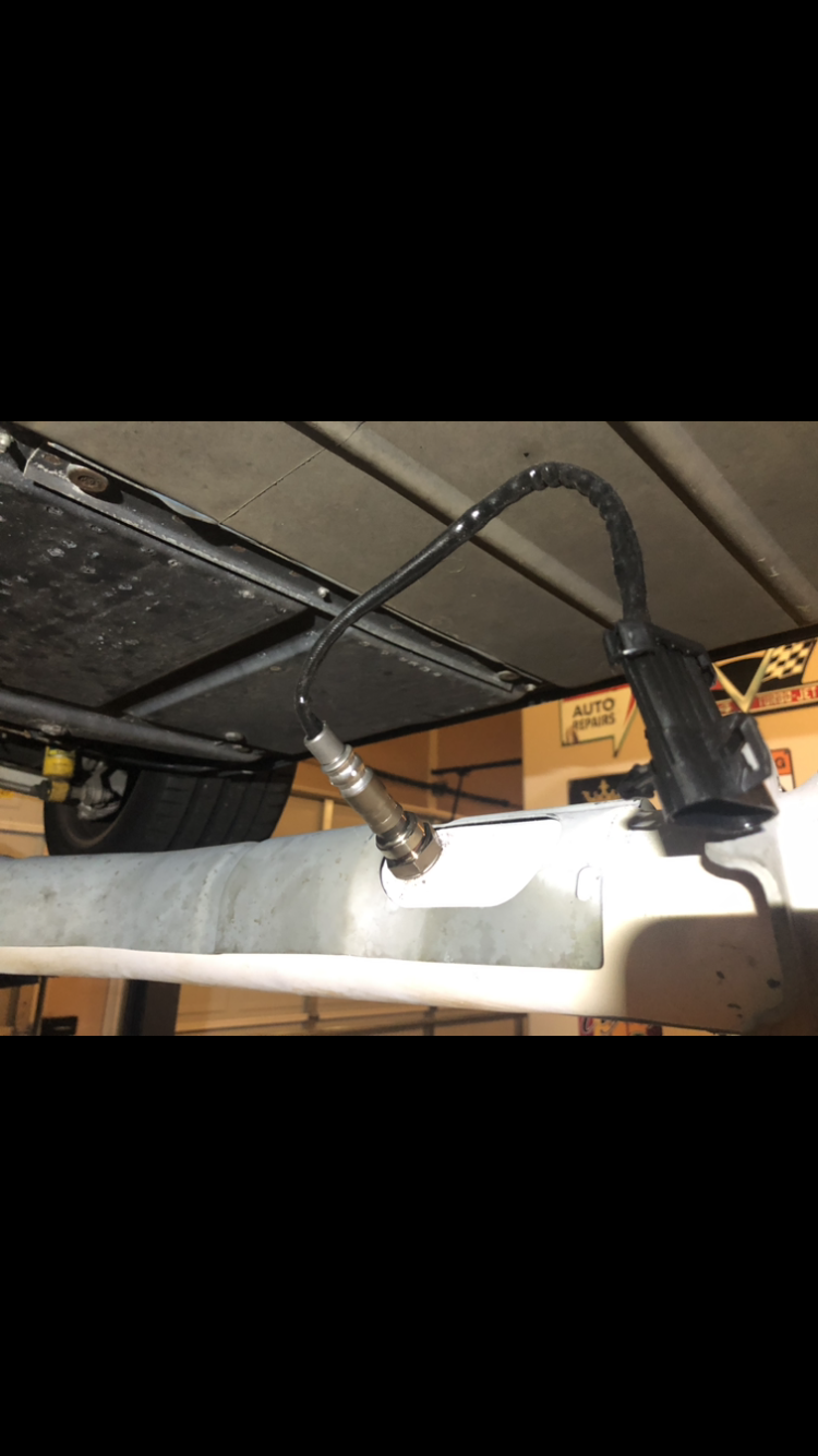

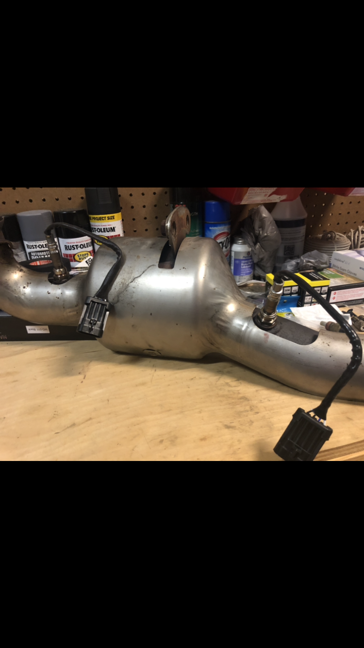

Started in on replacing the the front 2 O2 sensors. Just decided to go ahead and drop the exhaust and get it done so I could get the car back on the road. Got into it, and it’s such an ordeal (in my opinion) to drop this exhaust that I decided while I had it out, I would order 2 more O2 sensors and replace all 4 of them. Also, while I had the passenger side cat down and outta the way, I’d order a new fuel filter and replace it (I shoulda done that the first time I had the exhaust out right after I got the car and when I replaced all the fluids; took it out to paint the tips as they were a bit rusty). Anywho, looks like it’ll be on the rack another week because the other two sensors and the fuel filter arrive Thurs or Fri.
Check these pics out….no wonder that bank 2 sensor 1 was throwing the SES light, just look at it.
All 4 OEM oxygen sensors. Bank 1, sensors 1 and 2 on left; bank 2 sensors on right.
OEM Bank 2 sensor 1 on left; new A/C Delco sensor on right. No wonder that old one was throwing the error code causing the SES light to come on…..
Bank 1 sensor 1, new one, installed. Actually was able to replace this one without removing the driver side cat.
Ordered new Delco fuel filter, will replace while exhaust down and out of the way.

Parts came in Thursday. Yesterday, installed new fuel filter and remaining O2 sensors, then buttoned her back up. Popped into O’Reillys today and erased the code and she’s running like a top now! Ran some errands, no SES light, all good.
Next project, after a break from working on her, is new intake and valve cover gaskets.
New fuel filter.
New O2 sensors, bank 2.
New O2 sensor bank 1, sensor 2.
New O2 sensor bank 1, sensor 1.
