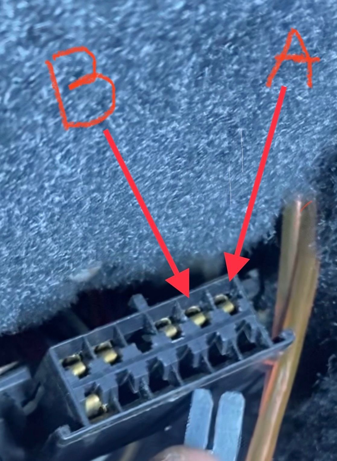

Have you checked to see if your car has any codes stored?
You can ground the OBD1 terminal (jump) A and B to show your codes (if any)
With your ignition key in off position , jump A and B terminals . you can use a paper clip or make one out of metal as I did
Turn the ignition key to accessories (don't start the car) , look at your service engine light.
This will start flashing, it will flash once with a small gap then flash again twice quickly. This 1-2 (code 12)combination will happen three times.
After the 1-2 has done its repeat times the light will flash any other codes the same way. example 3-2 (code 32) three times
After any other code/s have been shown , the car will let you know by flashing the 1-2 combination once again three times (test complete)
OBD1 terminal
Located by you right knee drivers side

weeles is right on as described. it will be a 32 for EGR inop.

It took me a while to figure out how to read the code. I kept looking at the dash, but the code reading is in the service monitor.
I got the following light flashes (Service Engine Soon) light.
One flash Pause Two flashes
Three flashes Pause two flashes
I got these two consistently
I presume the codes were 12 and 32,
Comments please
32 obviously means ERG
What does 12 mean?

Code 12 indicates there are no more codes to display.

The 12 is just to show diagnostic has started and when it's finished.
