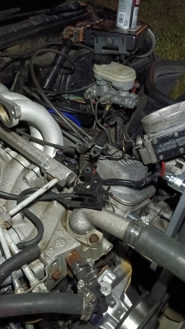

Please look at this vacuum module. I am replacing my ERG valve, and I noticed this vacuum module. Has vacuum attached but nothing on the opposite end.

If you've 2 vacuum lines connected to operate the valve there's very likely just a vent that when new had a cubed filter over that port.

Thank you for a response. I understood the words, but the message itself is what I am not getting. Please tell me what this is for, and please tell me what it controlls or operates - thanks

It's the EGR solenoid.
WV is right, there was at one point a little foam filter, probably long gone by now.
