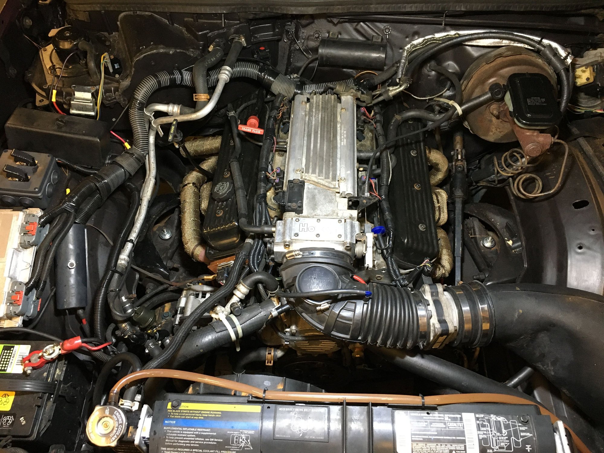

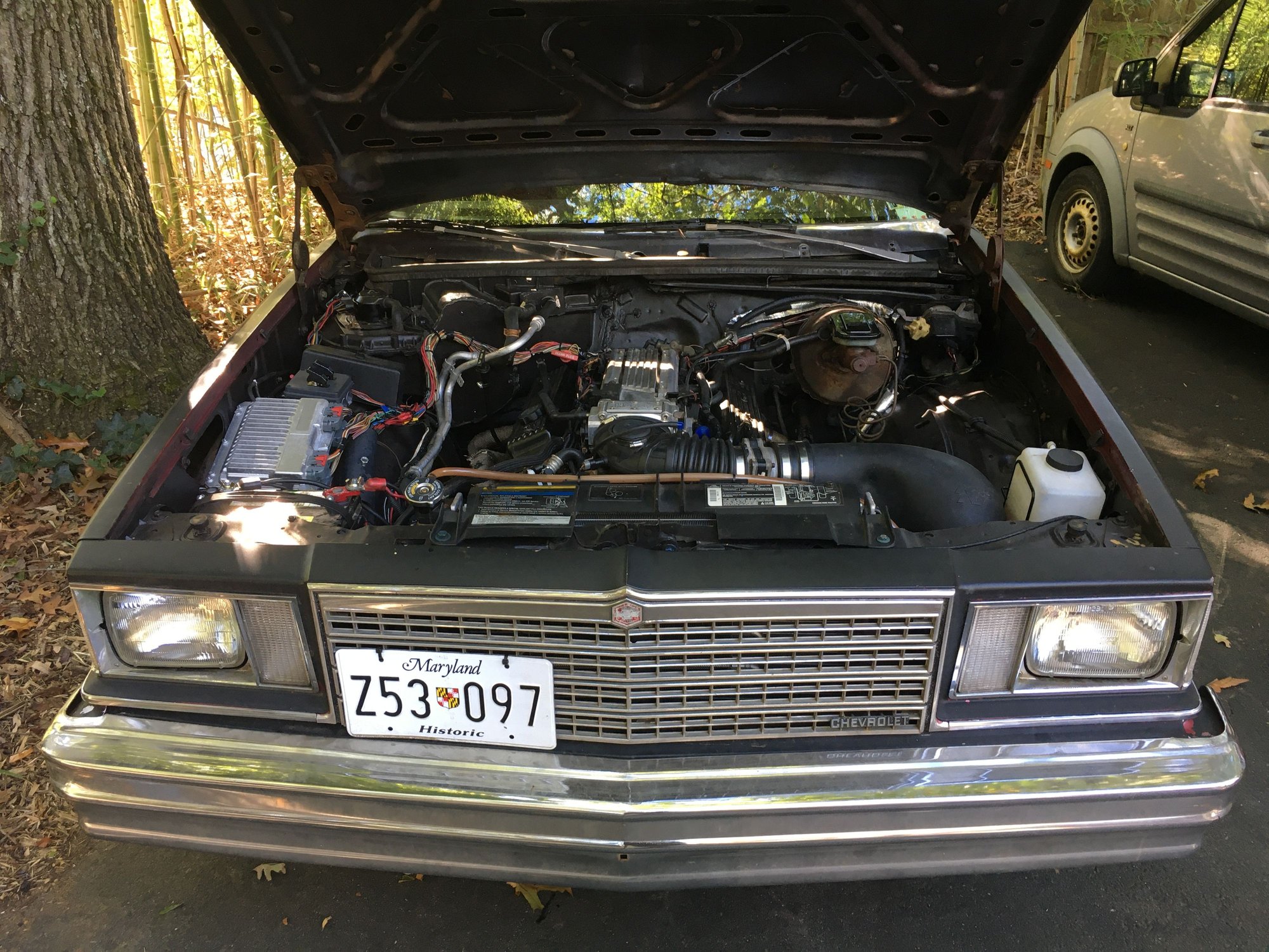

I swapped a 94 LT1 from z28 into a 79 Malibu that previously had a standard Chevy small block and it bolted right in without any modifications to the mounts on the engine or the frame. I’m thinking the 84 frame should accept the LT1 no problem.
The mounts from the older 350 Malibu bolt right up to the LT1 block. So if you’re putting the LT1 into an 84, use motor mounts for 84.
Old Feb 12, 2024 | 07:21 PM
JD1964's Avatar
JD1964
Joined: Apr 2014
Posts: 829
Likes: 191
Now, getting over the hurdle of bolting the block to the frame is easy. There’s lots of other stuff to consider. A free engine isn’t gonna be free by the time it’s in the car functioning and functioning reliably.
What all came with the 93 LT1 engine? Is the proper transmission with it? What about the complete wiring harness, all needed sensors, PCM, accessories like steering pump, alternator and all related pulleys and such. Because you are transitioning from an old school distributor ignition to opti, the way the accessories are set up is different.
When I did the LT1 into 79 Malibu swap I had a complete 94 Z28 to supply me with everything I needed. Still it was a fairly involved process. I can’t begin to imagine how much trouble it would have been if I would’ve needed to track down and acquire a bunch of odds and ends that didn’t come with an entire car.
Here’s the LT1 tucked into the Malibu engine bay

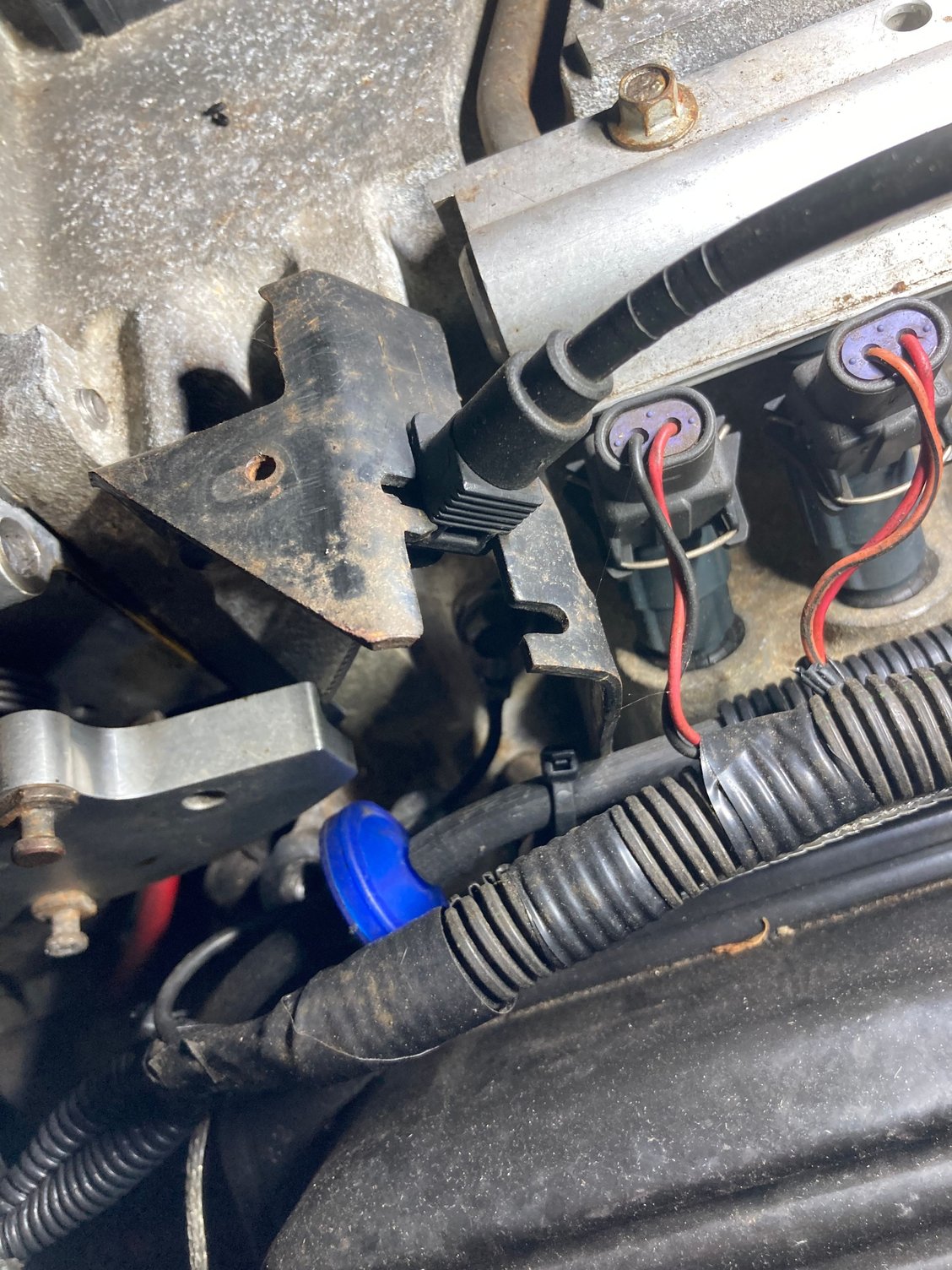

I bet your 93 LT1 has the bracket that will accept the TV cable housing already on it. It probably also has the pin on the TB linkage where the cable itself connects.
I just looked at my stock 94 LT1 throttle body and even though this engine did not have a TV cable from the factory, the TB still has the pin. The bracket on the intake also has the position to accommodate the TV cable housing even though this engine never had a TV cable setup. Here are the pics I just took. In the first picture I’m pointing to where the TV cable connects to the throttle body linkage. In the second picture, the empty square with the dimple is where a TV cable housing would connect.
