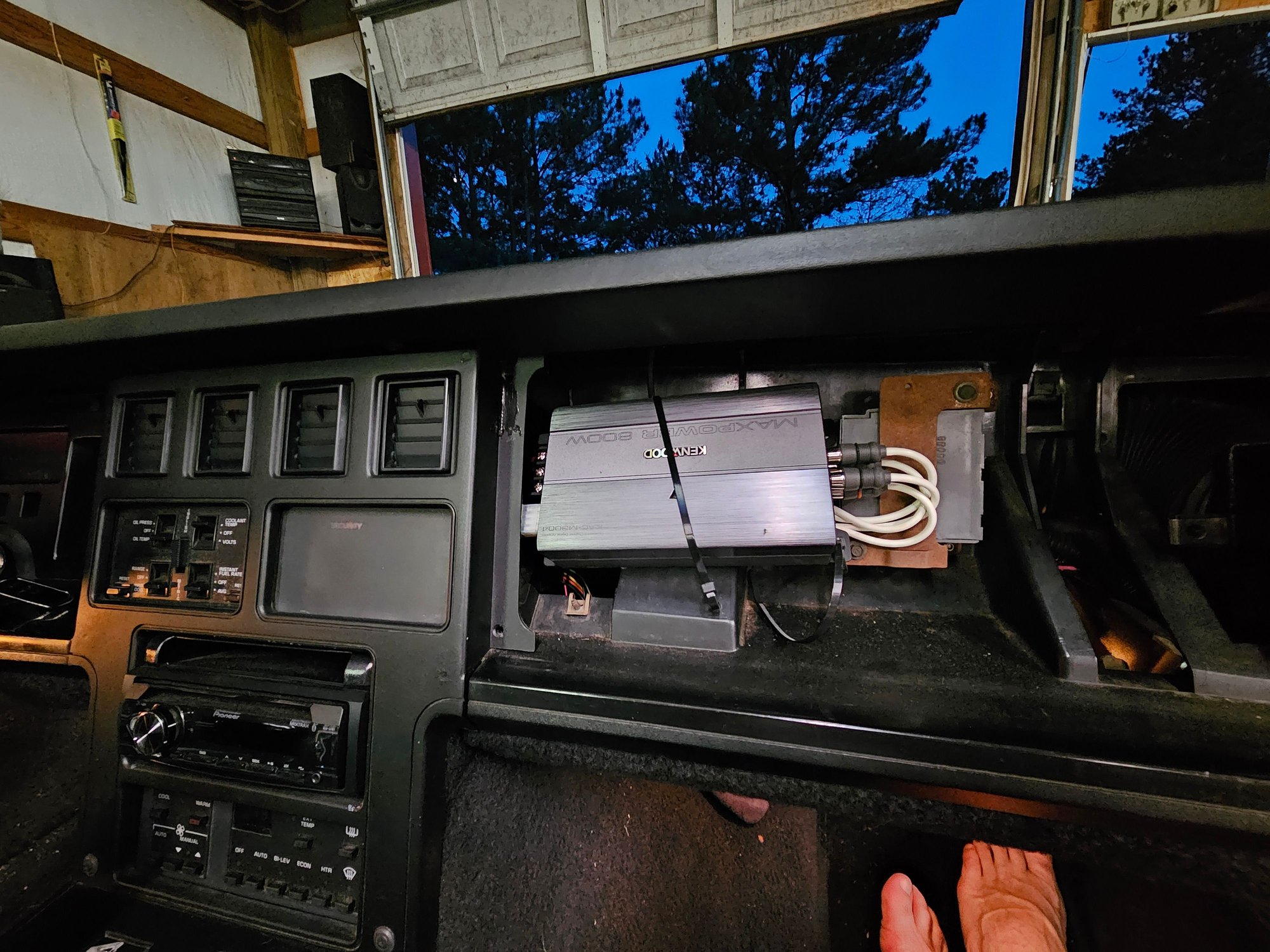

I mounted my amp behind the panel that a PO put in place of the breadbox. I ran RCA patch cables up to it and then attached the amp into the factory (Bose system) wires back to each of the 4 speakers.
I also used the bose relay up front to power my amp. So, its gets power thru that relay and the turn on signal from the head unit.
Eventually i want to go back to that project to add a powered sub in the rear. When i do, i expect to use one of the power wires that came to the rear speaker amp.
if you were after seriois sound and power, this setup wouldnt be the nest. But for my medim power amp 50wRMS×4, it is sufficient.

Thanks for bringing this back up... I took a picture and forgot to post it up to show how i mounted my amp....
I have also updated how I power that amp. It was beginning to melt the connector at the Bose Amp Relay, so I ran a dedicated fused 10GA line from the battery.
