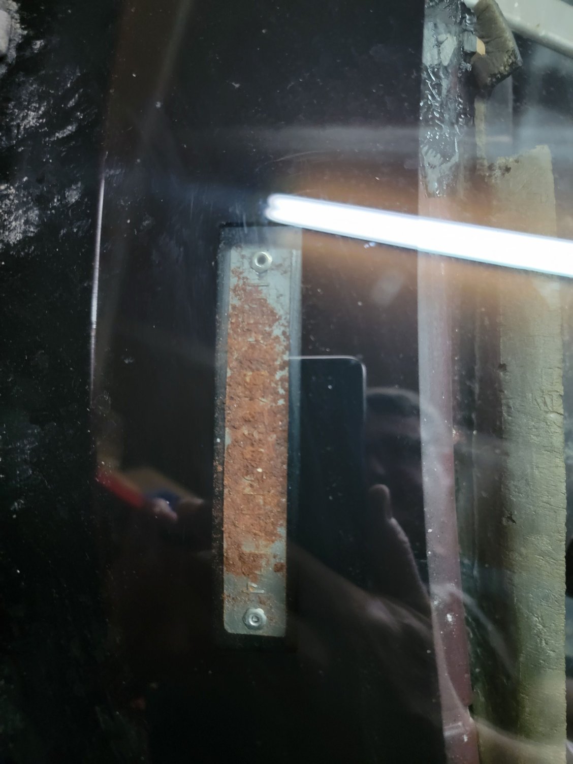

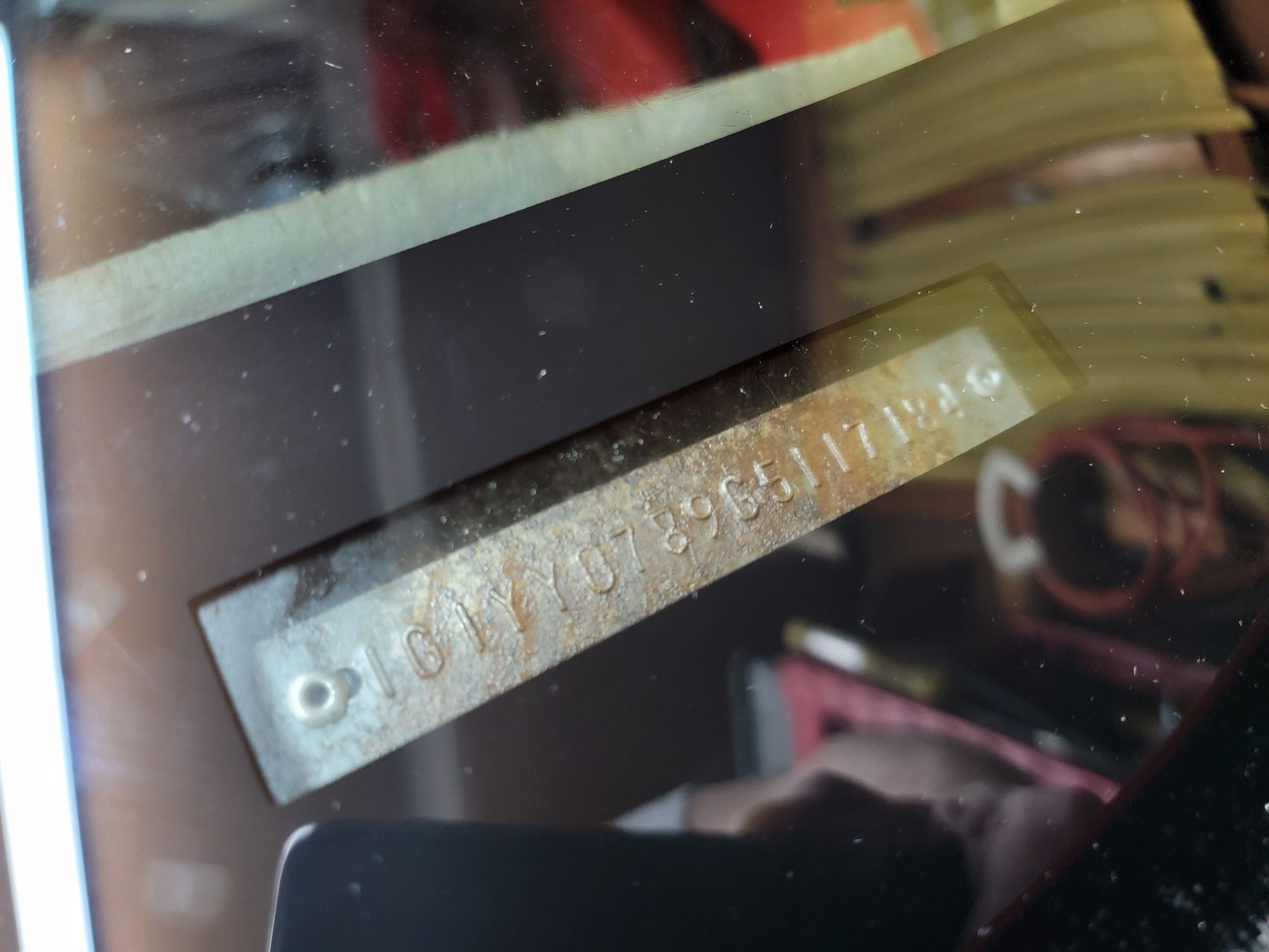

Is there any non destructive way to access the vin tag beside removing the windshield? Mine is rusty and it bothers me..lol

No there is not unfortunately.
I refinished mine when i replaced windshield. Mine was as bad if not worse than yours.

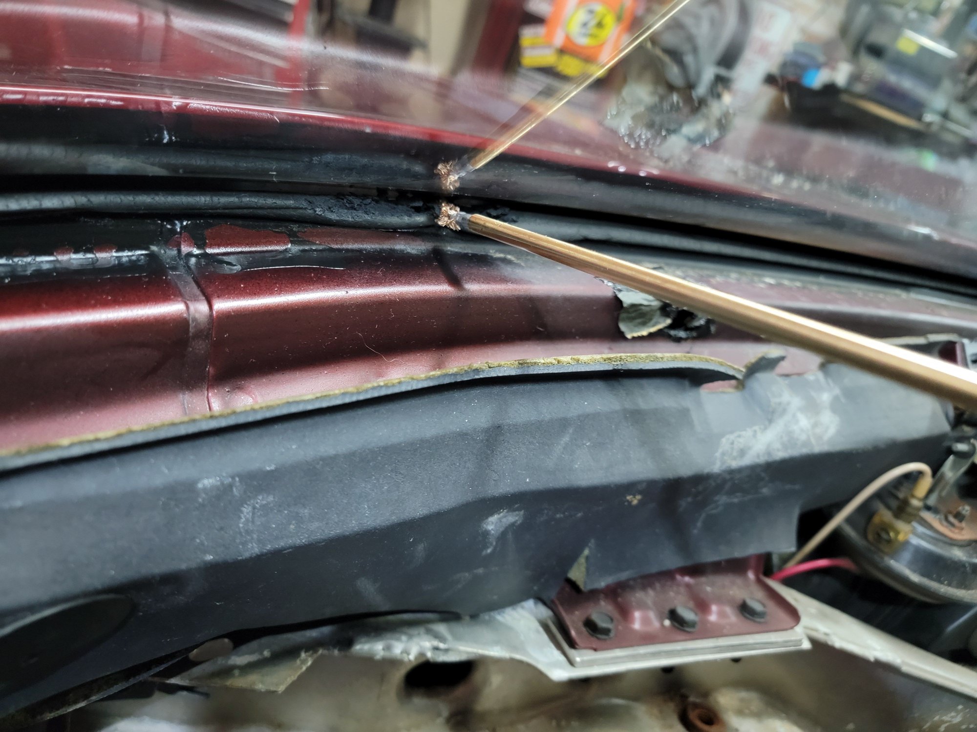

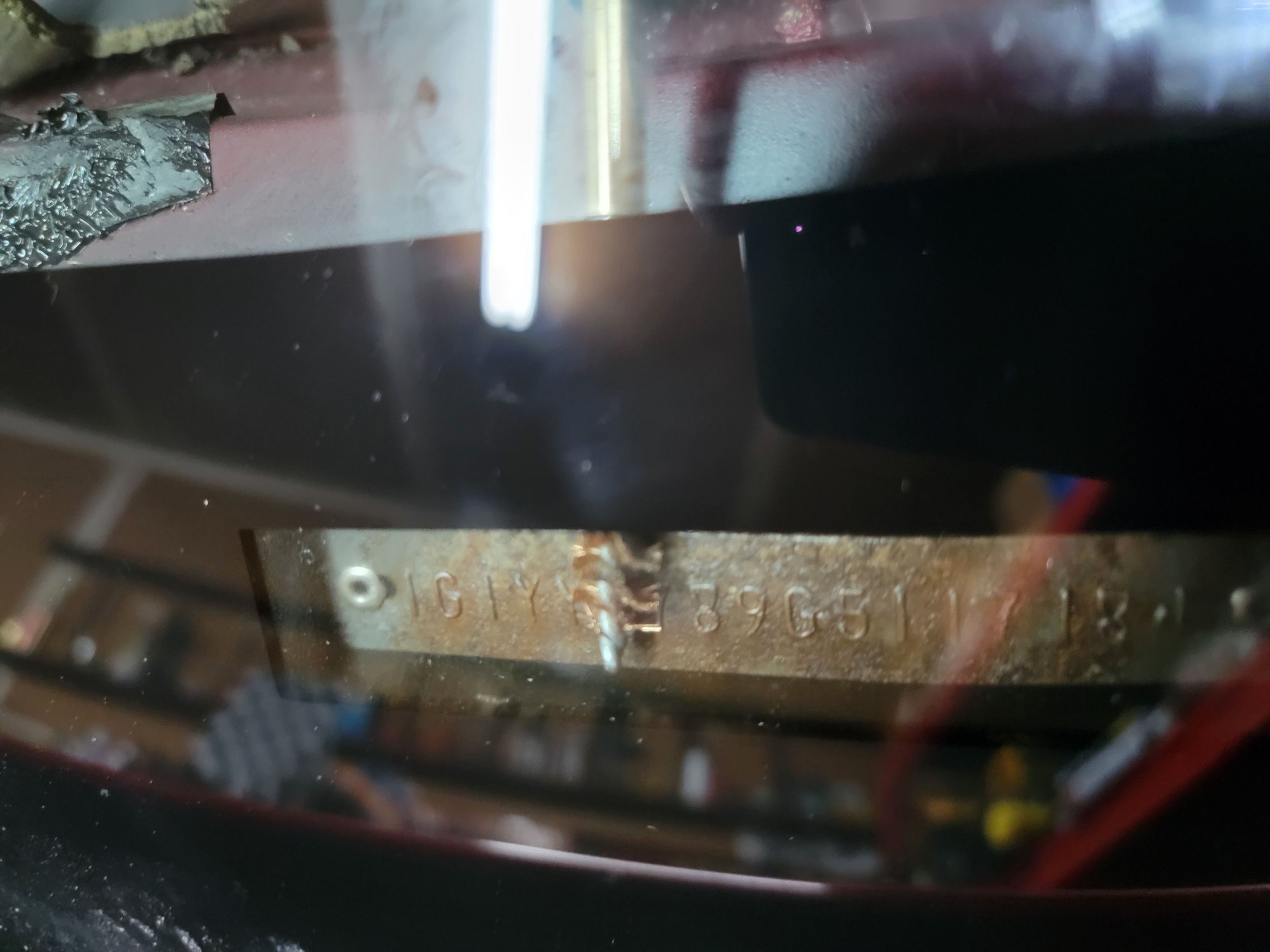

Not great but better. I think I can live with this. Got to the tag from the inside using a brass brush from my gun cleaning kit of all things. Good ole 357 brush..lol

Yeah, that's better
Good work

You probably will need to remove the dash pad. Here how i did it..and yes it roughed up the foam a little.
