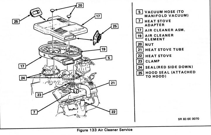

don't know how to post pictures .... n the shop manual pages 6E2-122 and 6E2-123 u can see the gasket on the snorkels .... i have from hood to air filter housing [top half]

In the other image 6E-122 would you want 11A & 11B? The seals #25 would be GM# 14046756 If you wanted #24 those would be GM# 10019632

it will be 11A and 11B in figure 132 thank you for helping !!
