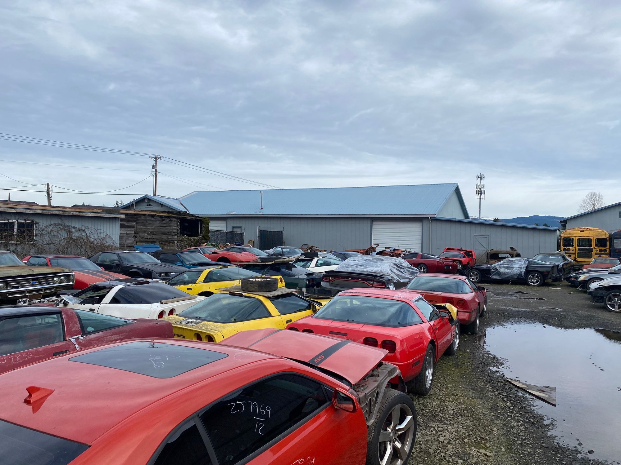

Just a quick break down...
Round numbers, 360,000 C4's made between 84-96.
91,000 of those are 84-85 with No ABS and very little electronic components
115,000 86-89 cars with ABS and very little other electronic components
151,000 90-96 cars with ABS and more electronic components
As you can see just grouping it into these three categories brings in an smaller quantity of parts. Some crossover from the early generation some do not. It is tough for a vendor to make 1 part that covers 84-96 much less one that covers a smaller break down.
Out of those 360,000 C4's just in my small portion of the world at a local small junkyard, they currently have at least 100 C4's in stock. They crush several a month to dispose of to make room for the new C4's. Of those they crush, not all parts are taken out and sold. I wish I had space for certain items to hold onto or even the money to do it.

Originally Posted by ChumpVette
I've been checking locally, as I also have a 2000 4Runner lacking 1 or 2 parts. I've seen 20 4Runners come through 2 of which were the proper sub-model and 1 with the correct interior, while I've only seen 1 C4 and it was an early model. Didn't even have the same fender screws, much less ABS etc. If I saw that many C4s in one yard I'd probably pass out. Then again buying an ABS module off one might be no better than what I already have.

If I owned that scrap yard a C4 would have to be pretty stripped clean before I crushed it. Dan PS: maybe you should post the name of that scrap yard.

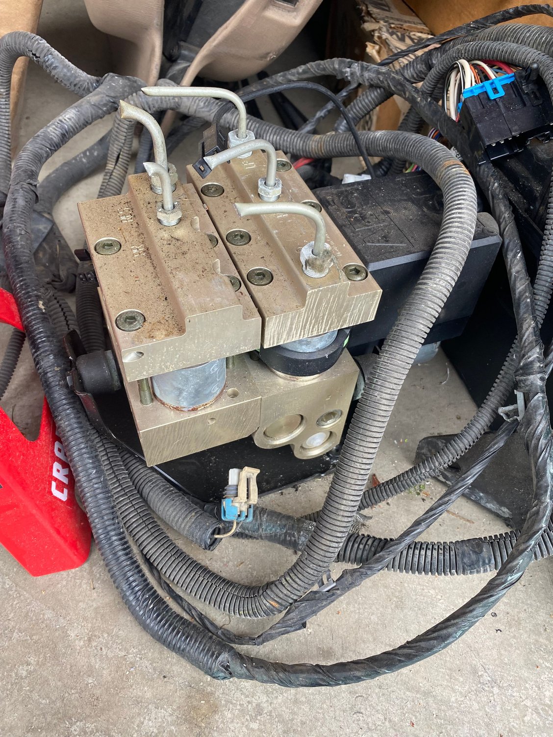

Let me know before you absolutely give up. I have an ABS out of a 96 I parted out a few months ago. I’d be more than happy to open it up and check everything.
Thanks.
Just looking at the picture, mine is configured differently. Mine has the 10mm x 1 fitting for the rear from the MC and two smaller (haven't sized yet) i think 8mm going to the LR anf RR, and the front MC line and LF & RF all inline. So 2 rows of 3 fittings each.

ChumpVette's Avatar
ChumpVette
Joined: Jun 2010
Posts: 4,564
Likes: 1,676
I’ll double check, I parted out a 94 and 96 back to back. That one one is probably the 94 unit.
