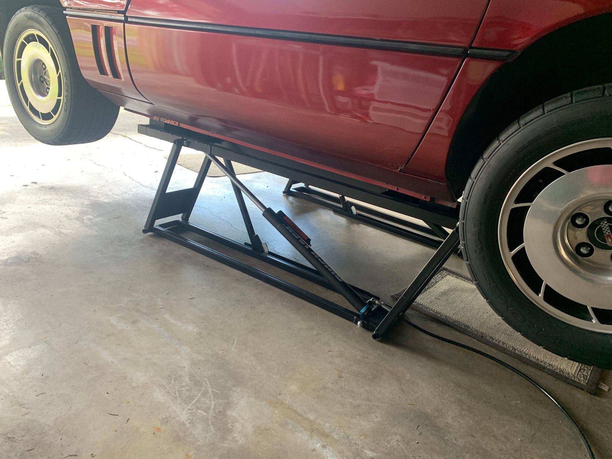

You are welcome! You could also go all the way down the rabbit hole like I did and add these.
I love these for oil changes. Next is new shocks and brake bleeding.

QuickJack + Pinch-weld blocks =

I've tried many things...regular jacks, hockey pucks, even the Quick Jack
Hockey Pucks: Yes they can be hard on a rocker (I loosen my rockers first when doing it this way)
Quick Jack: Really awesome HOWEVER very heavy and take up a lot of room. They are about 80lb per side so you need to be strong enough to stand up on edge, lift onto hanger ect...and be VERY careful when putting them down on the ground as to not hurt your back. I sold mine after just 1 year...found it took more energy and more time than conventional jacking (and I'm strong and fit...juice just aint worth the squeeze for me)

I just leave the Quickjack on the garage floor and park the car over them. There is a recent thread where some HF roller bearings are attached to the base of the QJ. At my age I prefer getting down and up once per side and with the combination of a puck and the smaller of the two supplied rubber lift blocks there is a small gap to the pinch welds i'm trying to line up with. I haven't added the roller bearings yet but plan to soon. Of course that will change the spacing so maybe I won't then need the pucks anymore.

Same here, these puppies are heavy!
