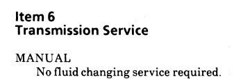

Hey guys, what are people using (if anything) on the drain and fill plug threads after performing a fluid swap? 89' ZF6. Funny thing, the GM service manuals say the ZF Manual Transmissions don't need a fluid swap. Who knows maybe they are a pipe thread?

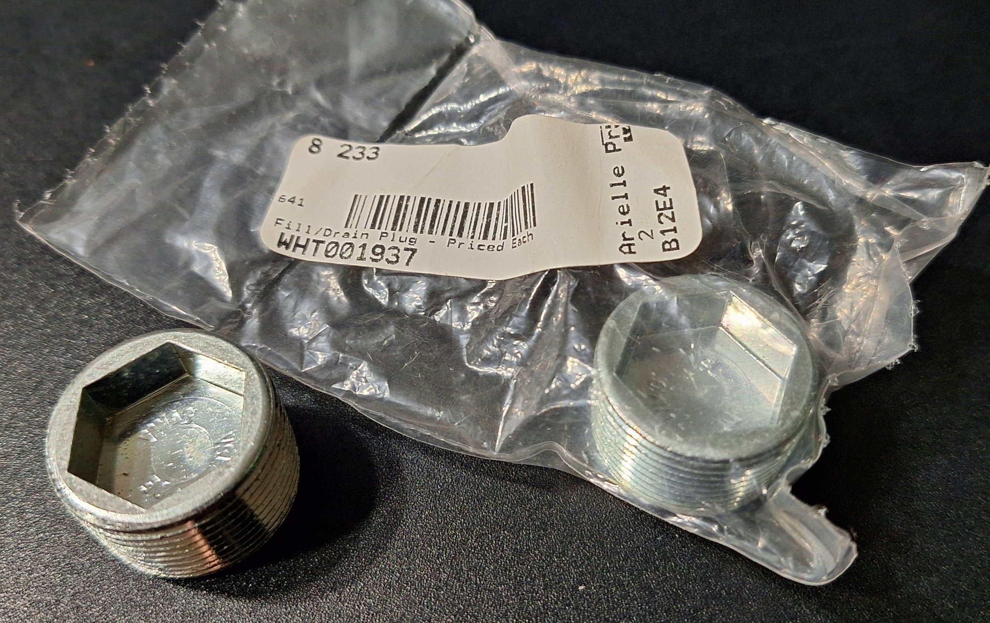

Answered my own question, they are a pipe thread. Pipe threads by design aren't meant to be re-used. The new plugs are about .010" larger in diameter which is why they feel tight after a few turns. They'll create new threads so I guess I'll install the new plugs

The Drain/Fill plugs are sold through VW but I believe they are the correct German replacement. You can see below they are identical to the plug from my 89'

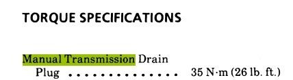

Also no need to really crank these babies in, I think the torque is low, like 26lb/ft???
