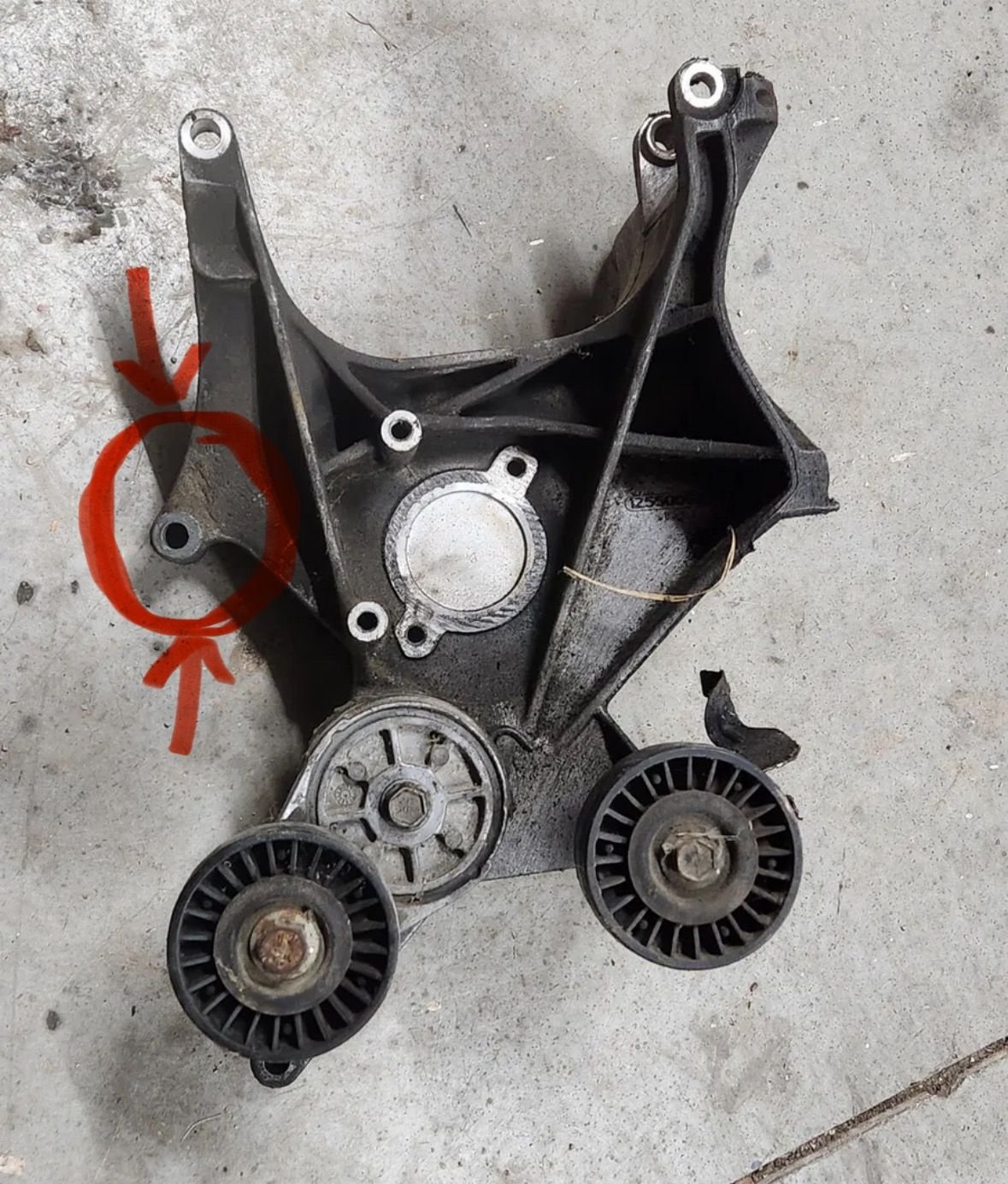

I’m missing a bolt that holds the accessory bracket to the motor. I’m guessing it was left off at some point. And it looks like it’s going to be tough to get in with the water pump and opti coil wire in place. Anyway, I need the one that goes here:
what size and type is it? Need to start the hunt for the correct bolt.

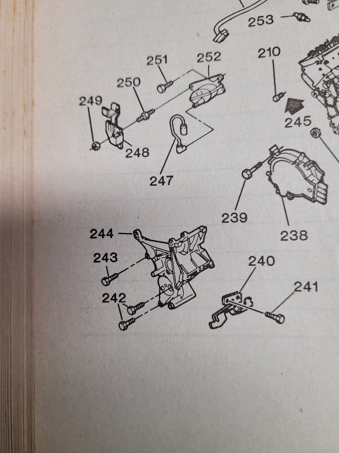

Looking at the Parts and Illustration Catalog, LT1s through '93 show this....
Looks like #243, GM 9440073, 3/8"-16 × 2"
Guessing '94-'96 is the same!?👍

Originally Posted by BMH95
Can’t believe I forgot that info. It’s a 96 lt4
My guess is, they're the same👍
