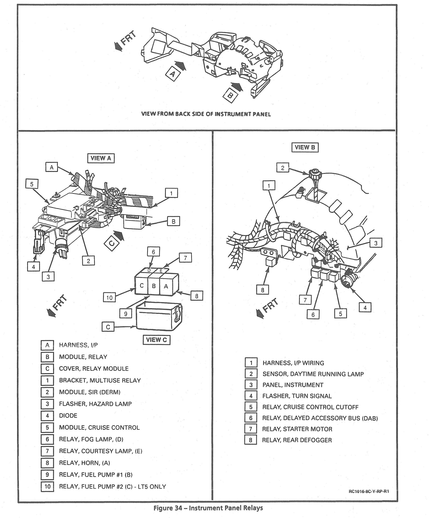

My 94 came to me already loaded up with LED bulbs everywhere and I found a receipt for the correct flasher relay for the LED bulbs. I am going to convert it all back to standard bulbs (some love them but I don't like the appearance of the rear LED assemblies) and my question is do these cars have ONE or TWO flasher relays (the second would be for the 4 way flashers). I have read that there are two but can't confirm. I want to have all the parts on hand when I switch it all back to original.

You have 2 - do you have the FSM(Factory/Field Service Manual) yet or still maybe needing? I can help you with the FSM if you're needing,
