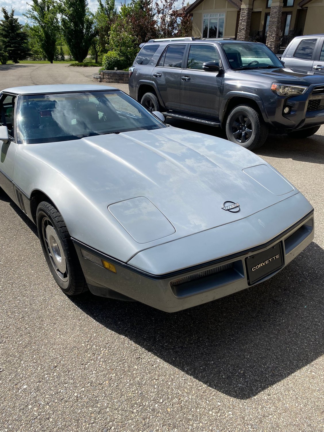

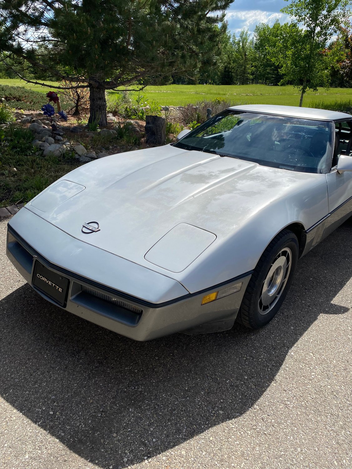

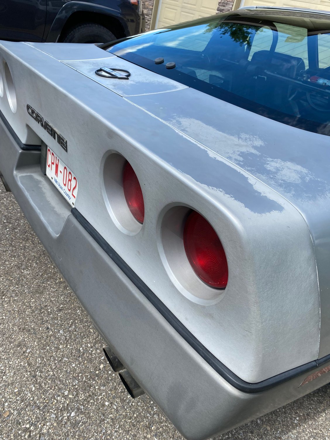

Hello everyone! I was recently at my first autocross event and realized that I should probably paint my car. It’s very sun faded as you can see below and the clear coat is peeling everywhere.
I was wondering what you guys might know about sanding, priming, and then paint? Tips? Process to sanding as I don’t really know where to start(what grit I would be needing). Things like that.

I had a similar issue, tho with red it looks way worse than your shade of blue, and was more extensive. Who'd pay 7-12k for a paint job on a Vette worth 3k cause the engine scares buyers away.
I have a thread on my paint job. Depending on your clear coat start with 120grit to bust thru the clear. If it is as uber hard as mine was bump up to 80 grit. Once you are thru the clear 220 works great. Wear anti vibe gloves, hearing protection, and a quality dust mask.
