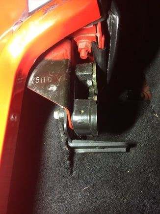

Scottsdale, on my 93, there is a manual rear deck release cable/lever. It is on the passenger side on the floor beneath the deck and way back. I hope your model year has this, also.
The lever is horizontal.
I will try to post a picture tomorrow.

Scottsdale, I found this picture:
It’s the horizontal handle.
Hope this helps!
