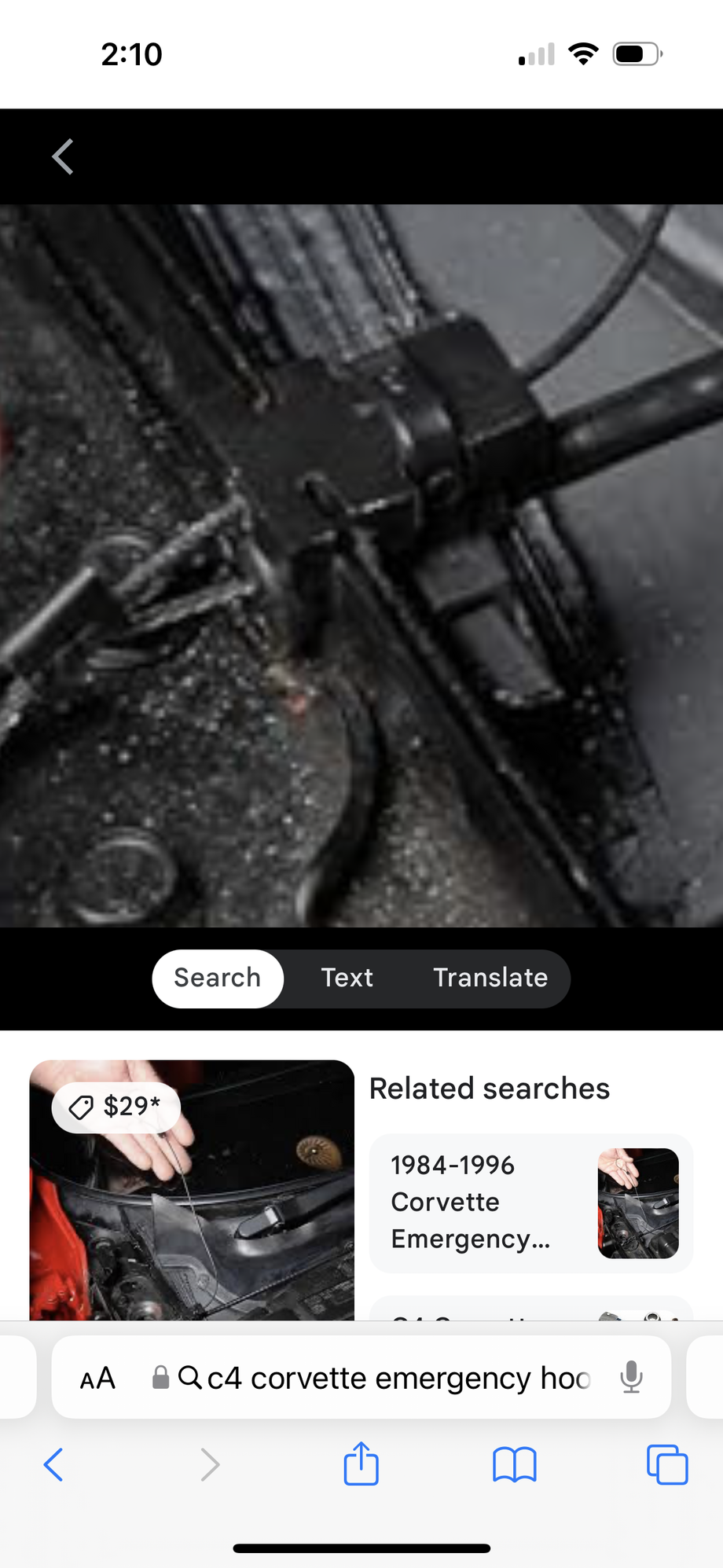

I googled it and you can see the zip tie in the picture. Kevin

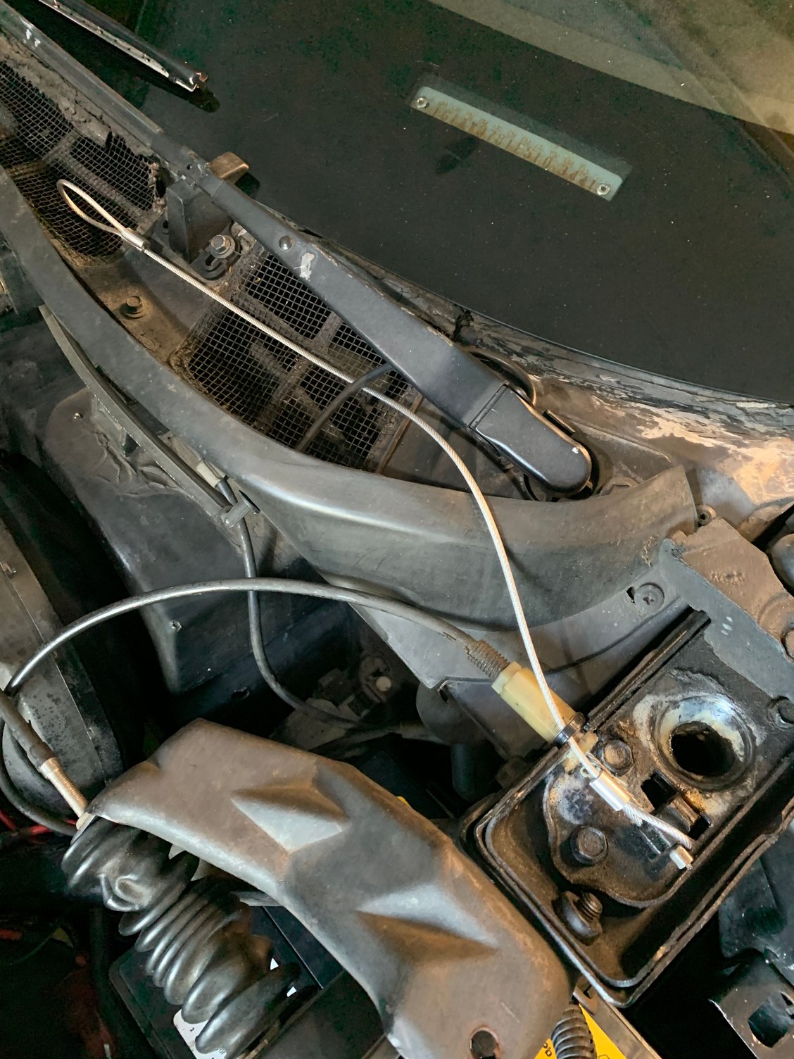

I was able to get these on Amazon pretty cheap. I zipped them (loosly) to the cable adjusters.

FostersPerformance's Avatar
FostersPerformance
Joined: Jul 2003
Posts: 3,500
Likes: 879
From: Saratoga Springs NY
Old Jul 14, 2024 | 10:10 PM
typical boomer's Avatar
typical boomer
Joined: Jul 2023
Posts: 540
Likes: 280
From: Marysville WA
Brian I like your setup better! I'll be changing mine pronto.

Thanks for the pictures. I had the plastic coated eBay ones sitting here. I undid the loop on the small end and then pushed the wire thru where the original cable goes, and then crimped on a new "Stop". I put the tie wrap where you all did. Works great. I had to remove 1" of plastic coating with a wire stripper to fit the cable thru the latch piece. Thanks

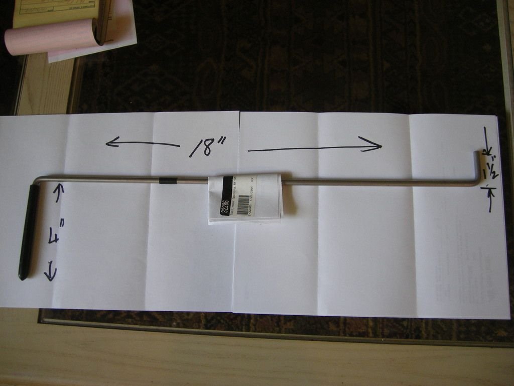

this is what i have, I don't like the look of the cables system!

"this is what i have, I don't like the look of the cables system!"
To each his own. That is cumbersome and hard to use. The cables take less than 1/2 sec. to open the hood and are way less expensive and won't scratch your hood.
Great idea.
Some members have made this tool from a mini paint roller frame like this one in the link. Cheap and usually free shipping.
https://www.homedepot.com/p/Unbrande...3-22/202097492

MRLMD agree each there own, if you ever used one you can pop a hood within 30 seconds too, and there is no way scratching the hood very easy tool to use if needed
