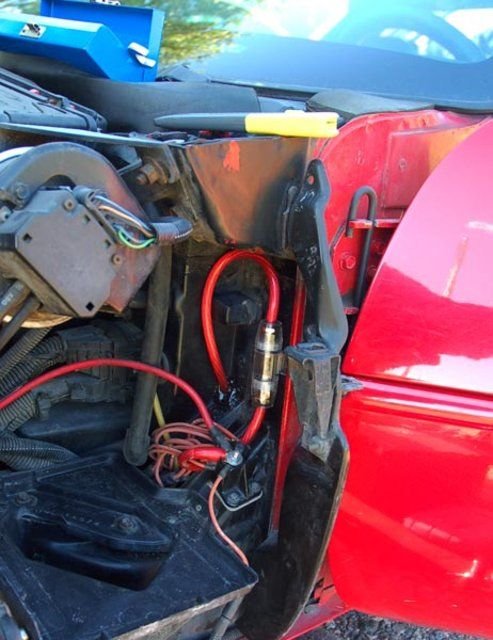

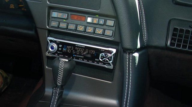

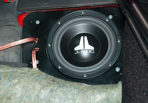

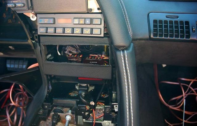

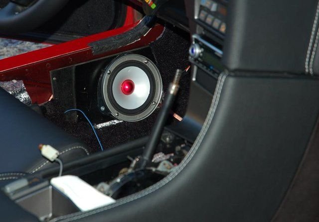

I installed an aftermarket system to my '91 many years ago. I went with 1DIN head unit, separate front speaker kit, 2 channel amplifier to the subs and 2x 8" subs to the original rear speaker boxes. I put the crossovers under the HU and used all new power and speaker cables.
Works nicely but I plan to move the treble elements up to maybe the door panel or something. They are muffled a bit when they are down there with the mid range speakers.

1 DIN bracket and the 2 (red) crossovers under the head unit space:

The DIY front speaker boxes with mid range and the treble elements:
Power connection with a large fuse:
The 8" sub in a sealed passenger side rear speaker box with a DIY speaker adapter/ring:
Rear subs with new carpet:
And the head unit playing some music:
