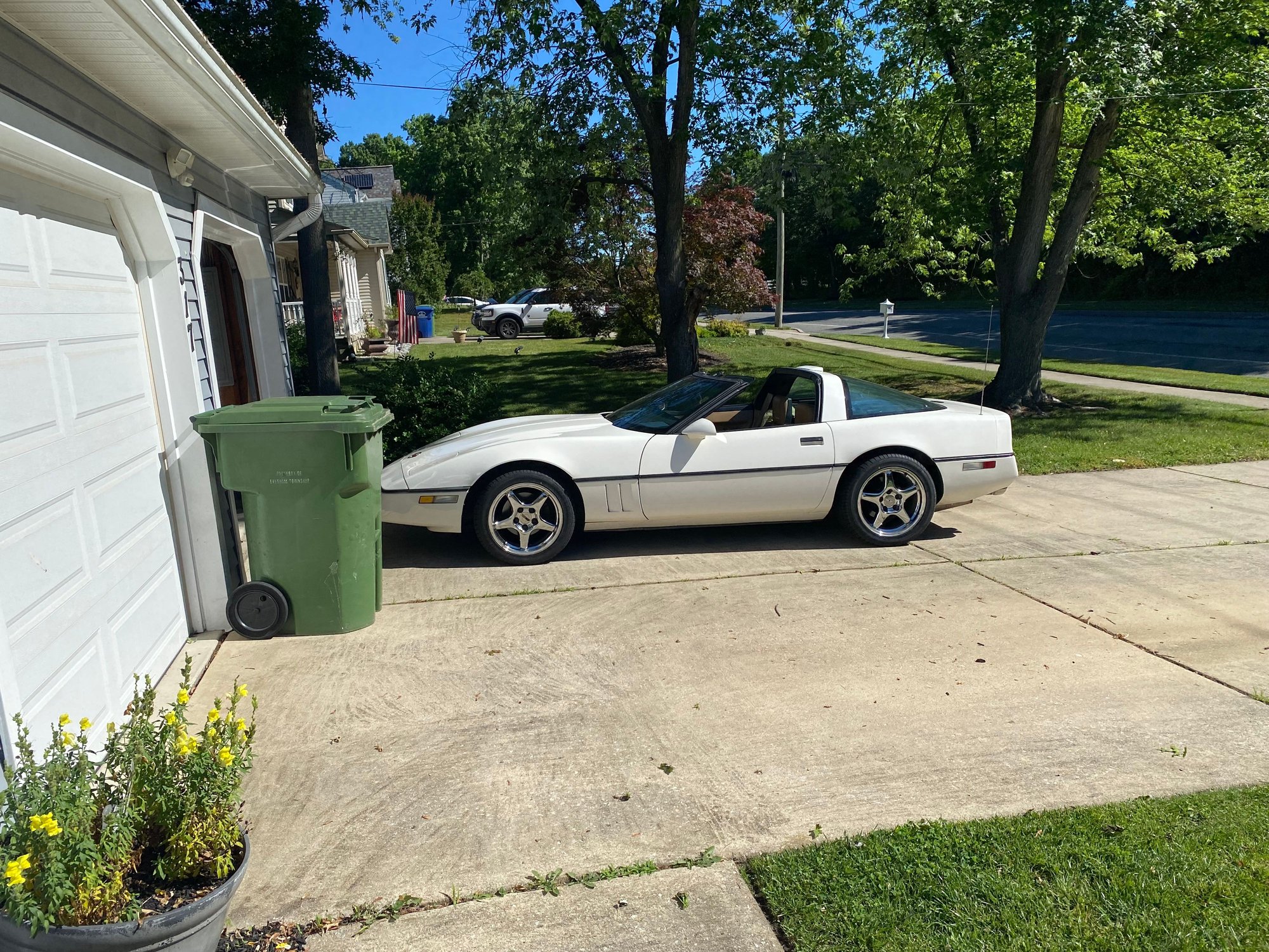

KJ here is my 86 with chrome 17 inch A molds. They mounted right up without any spacers. You can get aftermarket A molds from many places like JEGS. My rims are GM factory.

Not C7 wheels, just matched in size, 18x9.5, +40mm offset:
