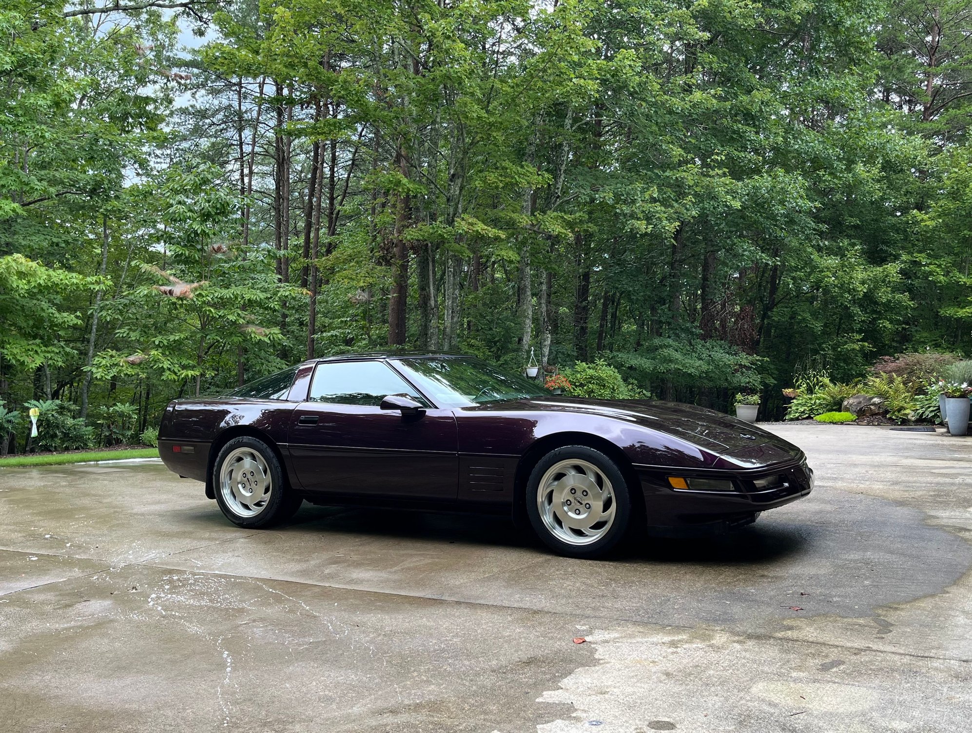

I just picked up what might be my all time favorite color combination, a 1994 Black Rose Metallic with light tan interior, only 44k miles and in pristine condition. It drives beautifully, I really scored with this one. Three days in and I am already building up a list of things to take care of, and I'll keep track of them here in this thread. Here's what we have so far:
Updated 8/5/24

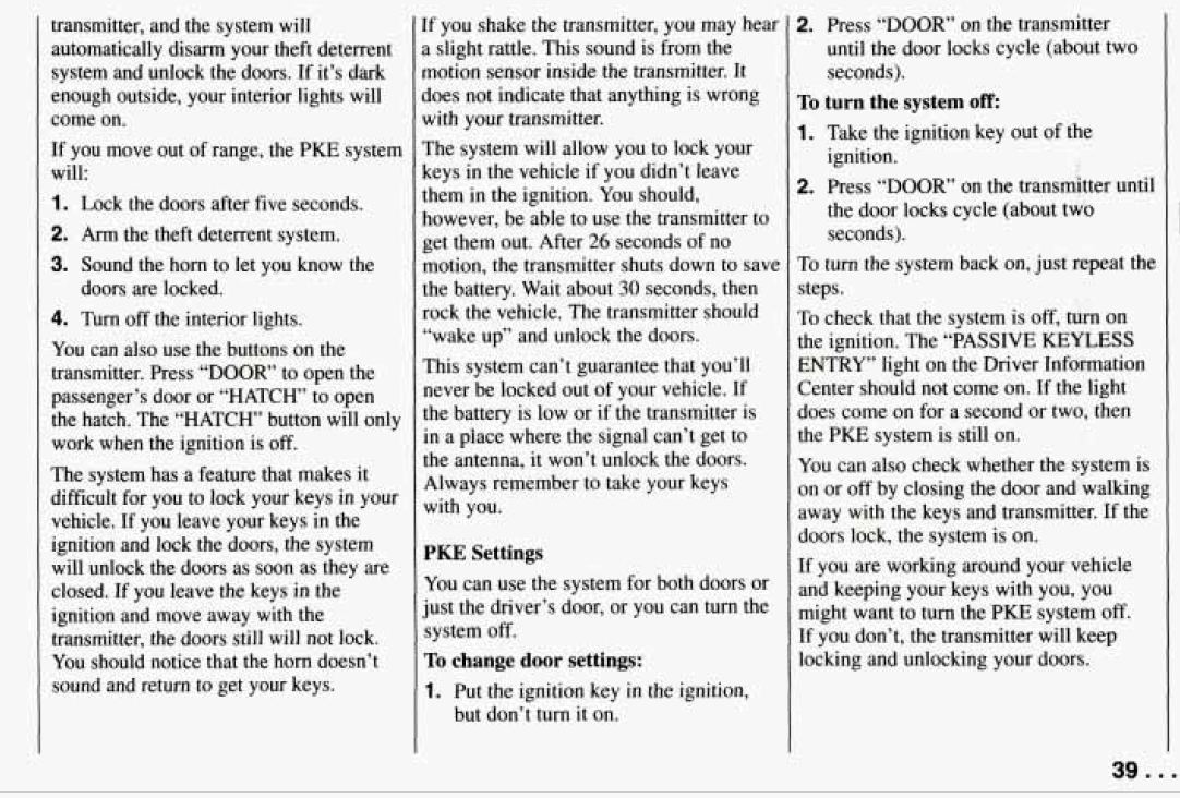

The PKE, passive keyless entry, auto lock, demon fob is the most irritating thing since baby shark. I get that it was early days for remotes and there was no standard for how they should work, but the way this thing functions is ridiculous. It does work like it's supposed to, it's just that the way it's supposed to is dumb. It's very close range so I pretty much have to be standing beside the car, and it will unlock the driver's door. I press the other button to pop the hatch. Then while I'm behind the car putting things in the back, or taking them out, it's constantly locking and beeping the horn, and then unlocking, then locking again, as I walk around. Like at the golf course when I'm getting my clubs out - that goes over well. I know I can hold the door button while near the door and everything cycles, and then it's disabled...but not for long. Within one or two start cycles and it's enabled again.
It's fine if all I'm doing is getting in and driving somewhere. But I'm in and out of the hatch frequently and that's where it sucks. I want to disable it and then leave the fob at home, but I'm guessing it will just re-enable itself.
Does anyone know if there's a way to permanently disable it?

From page 39 of the Owner's manual

If it is turned "off" it is off. Either you accidently pushed the door key, or the unit is malfunctioning, it doesn't re-enable itself if it is working properly. But if you just want to leave it at home anyway, why do you care? Put it somewhere besides the garage and forget about it. Or you could put it up for sale; I'm not sure what they go for these days, but it's a lot.

If I disable it, but still have the fob on my keychain, it definitely re-enables itself after a couple starts. So now I've got it turned off and leave the fob at home, and that seems to work. Like I said, if all you do is get in and drive, then it's fine. But if you're in and out of the back frequently (and I am), it's a royal pain.

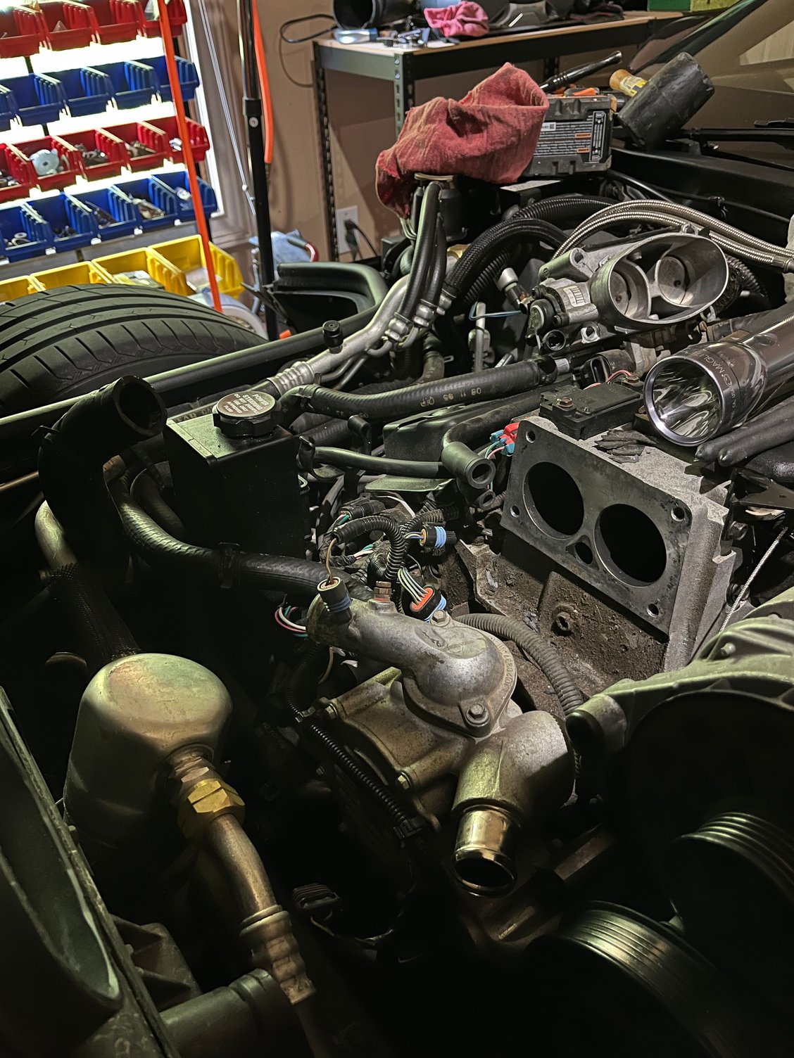

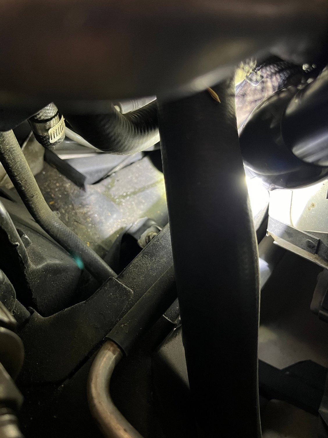

Any guesses where my coolant leak is coming from? Hint: you're looking at the crossmember under/behind the crank pulley. I'm sensing back trouble in my near future.

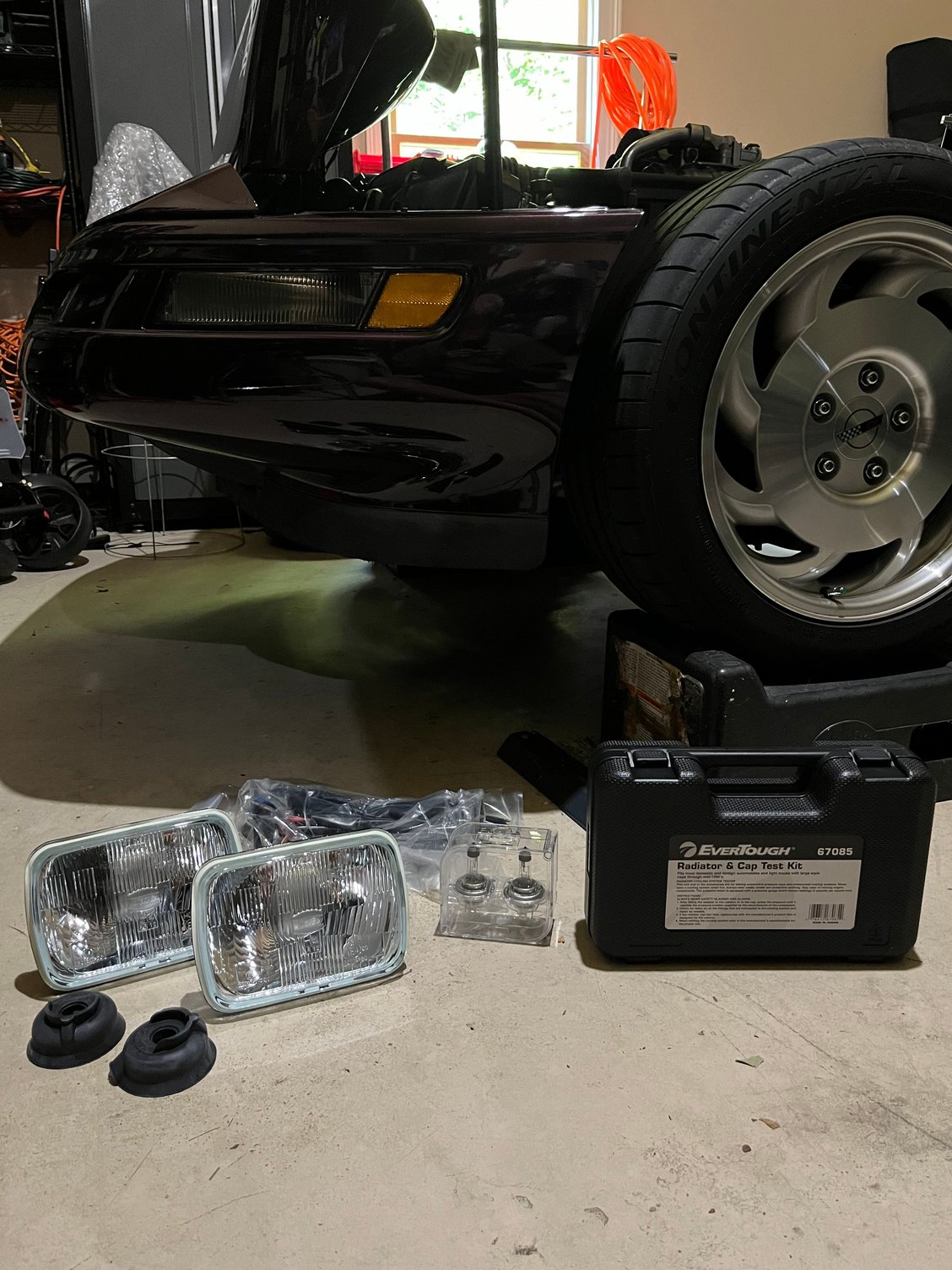

The good and the bad. Good, a major headlight upgrade just arrived from Daniel Stern. Koito H4 E-code lamps with 55/60 Osram bulbs and an updated wiring harness. I will post before and after pics. And the bad, I rented a pressure test kit because I need to confirm this coolant leak. I'm certain it's coming from somewhere around the water pump, but the weep hole doesn't show any signs of leaking and I can't find any other traces. It still might be the gaskets, but I'm hoping I'll find a bad hose somewhere. In the event I have to pull the pump, I'll probably go ahead and replace it. I'm really hoping I don't have to replace the optispark at the same time.

The pressure test confirmed it's the pump. Loaded up to 20psi and zero visible leaks, no bubbling sounds, tight as a drum...which means it's coming out the weep hole when it's running. I just ordered an AC Delco pump, a Cardone opti-spark, thermostat, misc gaskets and a throttle body cooling bypass kit from Summit. They had the best prices on everything which surprised me, and free shipping. It will be here Monday and I get to have some fun in the garage.
I'm curious...when I got my E-codes, there was no replacement harness. They were plug and play. Do you know why there is a new harness? Also...something you might consider doing...the E-Codes are much heavier than the stock lights (at least mine were). You might consider getting brass gears for the headlight motors. The weight of the new lights will wear out the stock nylon gears in short order.
I'm keeping an eye on local ads for exhaust systems, both stock and other brands - I've always been a big fan of Borla. I'll land on something soon for a reasonable price.
The harness is pre-wired with relays and will power the lights directly from the battery for maximum efficiency, relaying from the stock wiring. It's the best way to run them, and his price was very reasonable for a pre-built harness. Plug and play, no cutting involved. I thought it was worth it. I'll be installing the lights later this week, keep an eye out for the before and after.

Current state. The water pump bolts have been cracked loose and I'm letting the remainder of the coolant dribble down the front of the block, hopefully saving the optispark. New parts will be here today and I'll hopefully be driving tomorrow. The factory-original throttle body gasket did NOT want to let go, and it finally came off in pieces. This is probably a good maintenance job to do, even if I wasn't replacing the pump. New gaskets, serpentine belt, and a general cleanup.
