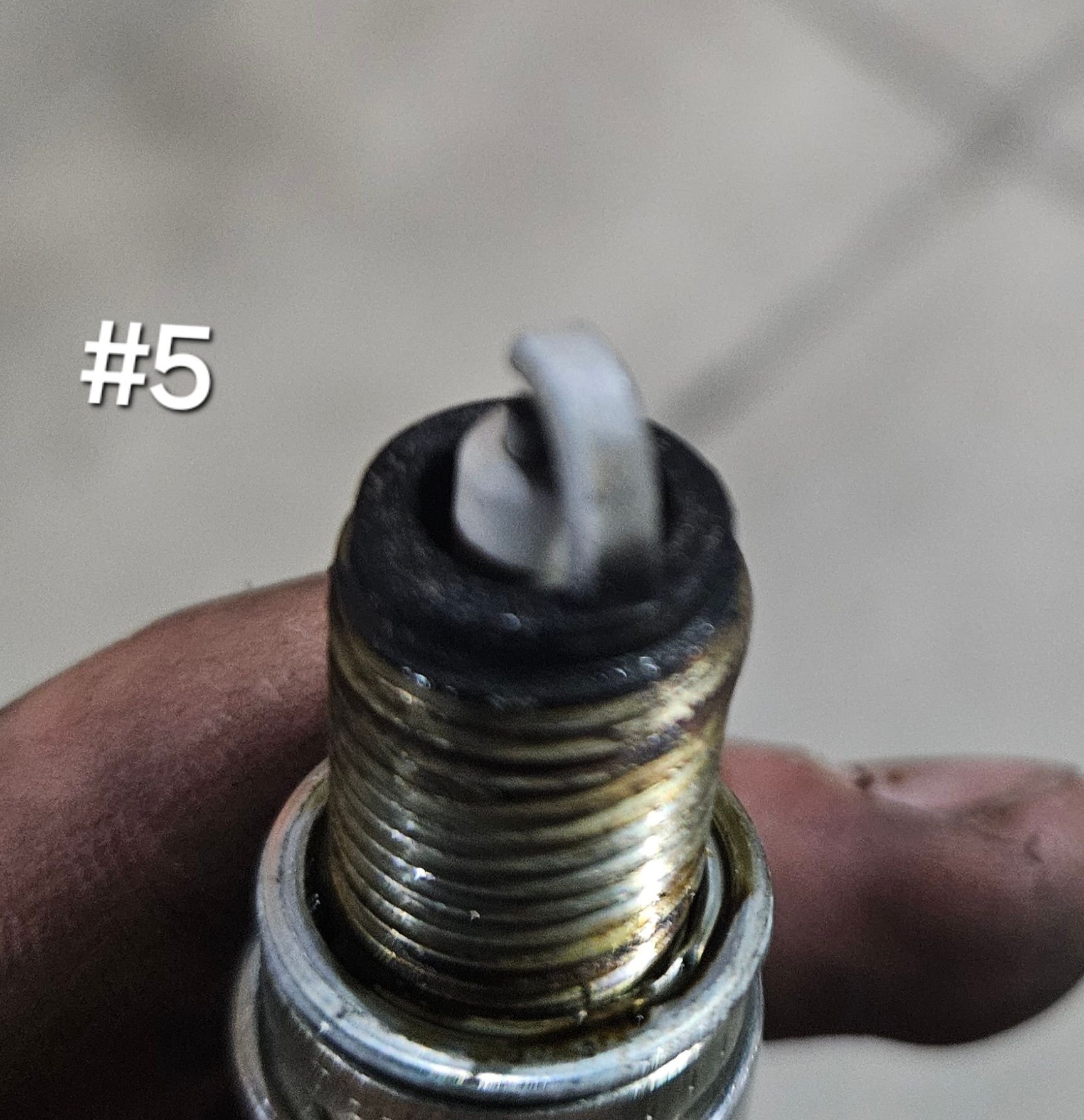

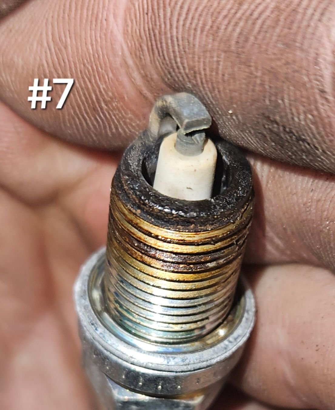

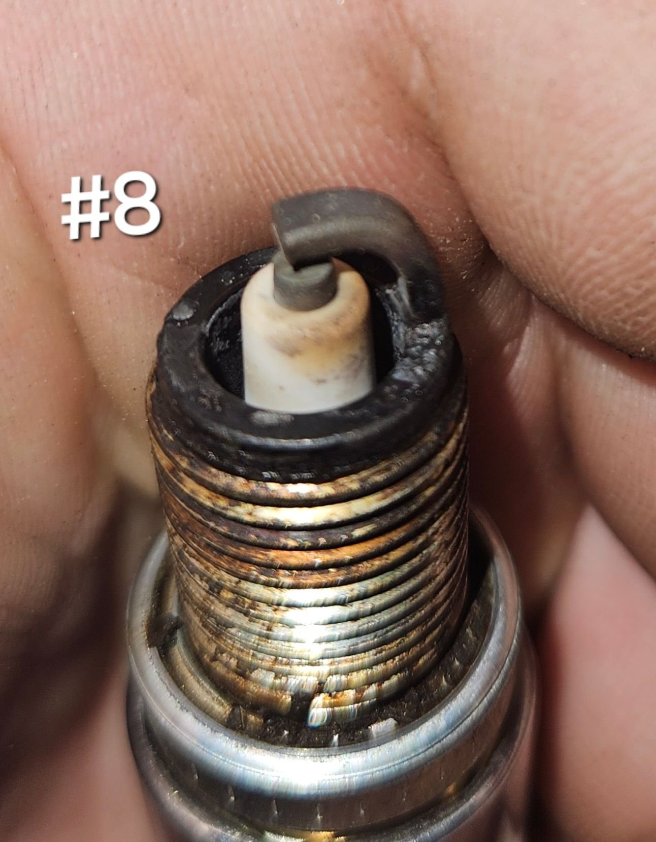

So far I have pulled plugs 1, 3, 5, 6, 7, and 8. 2 and 4 are blocked by ac and other stuff so I'm gonna fight them after this response. 1, 3, and 6 look perfect. However, 5 looks very white/gray on the electrodes. I believe this means lean. 7, and 8 have the "salt and pepper" look. Not as bad as it would exspect however (yay!). I'll attach pictures
Not sure how well it shows up
Im very curious about 2 and 4. Will update soon

Those don't look terrible but there are signs its running hotter on 5 & 7.
You need an OBD1 cable with USB connection and TunerPro or DataMaster software.

The spark plugs are crusted up, and that build up is also on the heads, valves, piston top, and when it heats up enough it will cause random detonation.
Way way back in the day, we had car engines with carbon build up and it would cause the engine to still run after turning off the key, it was dieseling.
I usually don't believe in a fix-in-a-can, but in this case I recommend you check around for some engine treatment designed to directly burn off carbon from combustion chambers, needs to be a lot stronger than a fuel system cleaner.
