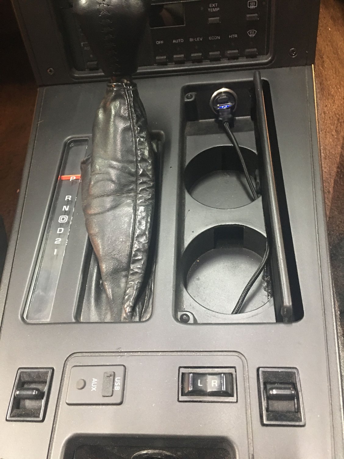

For my '87 Vert. I bought a short USB dual port cigarette lighter charger off Amazon. Yeah, the led light is illuminated when plugged in but it's so short that I can plug a USB cord in and close the ashtray. This outlet is to charge anything while the ignition is off. I installed a second dual port USB/Auxiliary port on the console on the left side. The existing console skeleton below the trim plate that holds the window and mirror selector switch has an existing hole in it. I just cut a hole in the upper trim plate to hold the USB/Auxiliary ports from the double din radio I installed in the dash. Pics attached.
Charger plug has swivel metal ring to remove it from the lighter.
Short lighter charger plug in socket and illuminated when plugged in. The black cord is routed to the center console so I can charge my phone with the cigarette lighter cover and the console door closed. Radio USB/Auxiliary ports on the left. I bought some plugs to cover the holes to keep dust etc. out.
Ashtray cover closed over lighter charger plug,
This is the skeleton under the top plate that has a hole already in it which I used to locate the USB/Auxiliary port from the radio on the top plate.
