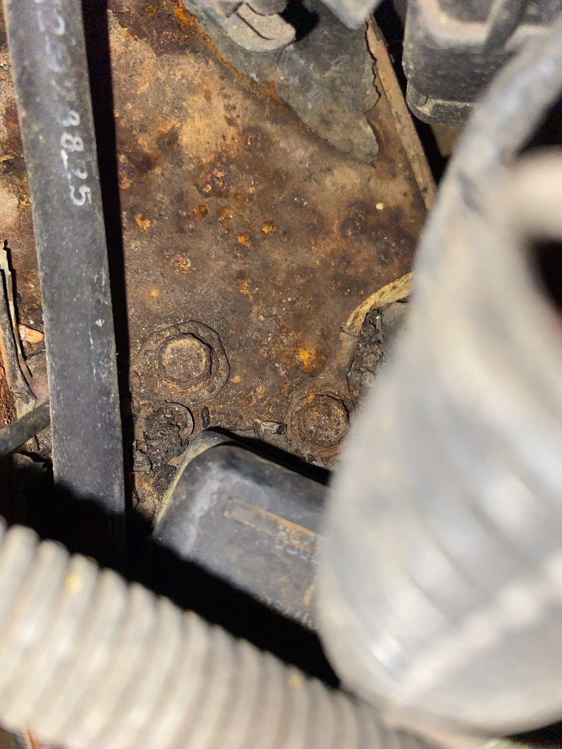

Dr Cook thanks for the suggestions. After breaking down the car further I discovered quite a bit of peeling paint and surface rust. Luckily, there’s no pitting and after I’m done prepping I’m confident I can get it fully cleaned up. I bought Eastwood’s rust encapsulator plus and their extreme frame paint in satin for a top coat that won’t fade. I’ve come to find that rust in this area is very common for C4’s. I think it’s due to the cowl drain dumping directly on this area, the battery puking in this area, and water splashing in from the A arm area. So I plan to extend the cowl drain tube to dump on the ground. I’m not sure if I’m missing an insert on the middle section of the wheel well splash guard, but I do know there are panels that are available that close up the area around the A arms better. Below are some photos of where I’m at so far.
Splash guards removed and you can see the pile of battery corrosion and the rust on the frame. I’ll be removing the cross brace, AIR tube, etc for better access.
The worst spot in the corner. I’ll be cleaning up the ground strap and getting new hardware.
The surface rust and peeling paint extend up to the area under the ASR

As an added precaution with rust, I use a small needle scaler, cheap from Harbor Freight and then either OsPho or a Rust Reformer before the Rust Encapsolator.
https://www.harborfreight.com/compac...ler-58646.html
