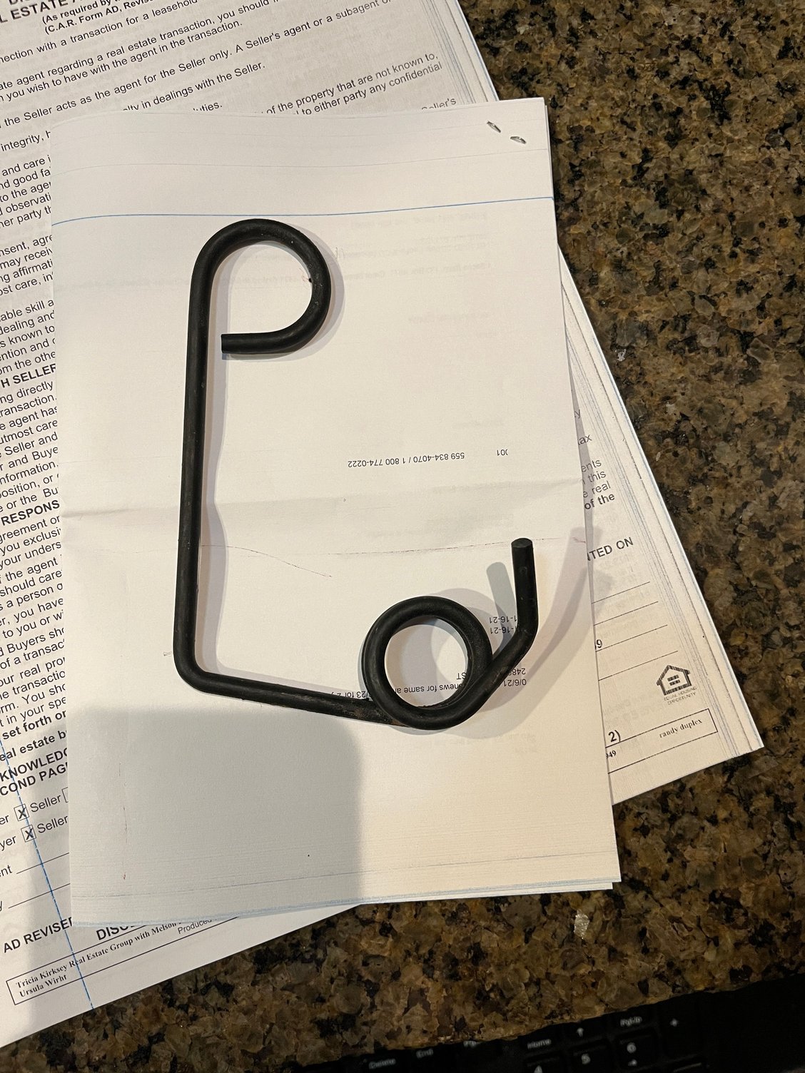

Just bought a 1996 vette and in the back cubby hole storage was this spring. Seller (female Dr) didn't know what it went to. Assume it belongs on or came off of this car. Anybody recognize it and what its for?

That is a clip to hold the jack in the spare tire

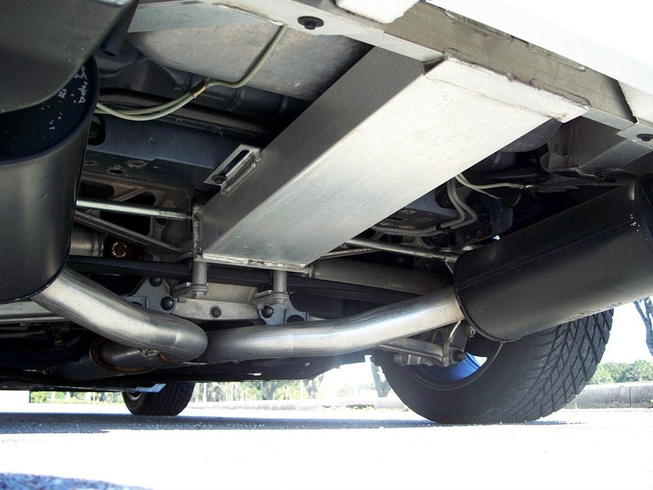

I looked under the back of the car and there is no spare tire or a place for one. It has a metal box welded in back there, from the back frame to somewhere around the differential. I do have a small jack though. My jack is located in the little cubby behind the pax seat under the lift out tray. Its in molded sytrafoam container that fits in there perfectly. Did they do away with the spare on 1996 models?

If the car didn't have a spare (N84 delete), it also didn't have a jack. The OP has a jack in the inside tray.
94-96 do not have the spring because the jack was inside the car in the tray. N84 deleted the jack as well as the spare. (The tray was still there.) This is all very curious. Obviously, if the N84 bracket was added, he should not find N84 on the Service Parts Information Decal. N84 was only available with WY5 "Run Flat" tires, and UJ6 Low Tire Pressure Warning System. To get N84, required the other two RPOs as well, so if the bracket was installed OEM, all three RPOs should be on the SPID.
Possibly, the N84 bracket was added to the Original Poster's car by a Previous Owner, and it was not OEM.
However:
If the car does have N84 on the SPID, the jack was probably added later, and the spring came with the jack. Jacks have a date code on the 'bar' adjacent to the wrench hex. YMDD format. If the first digit isn't 5 or 6, the jack is not original to the car. And the mystery is solved. The jack was added. And the spring came with the jack.
Here is a picture of the N84 Spare Tire Delete bracket.

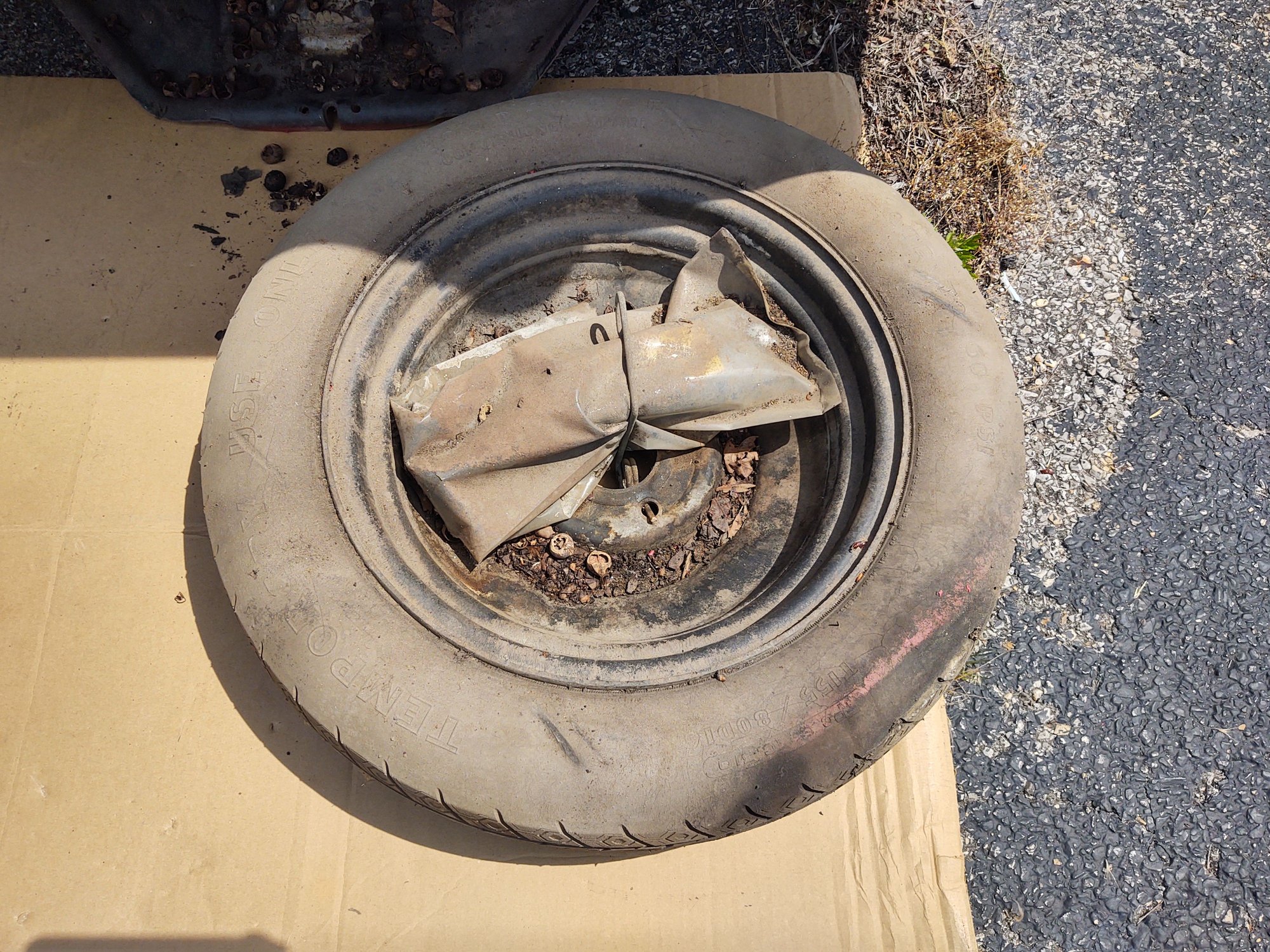

Just because I have pictures, this is how it looks with the tire and the jack.
Try to ignore the acorns.
And the carrier.
Hope that helps.
