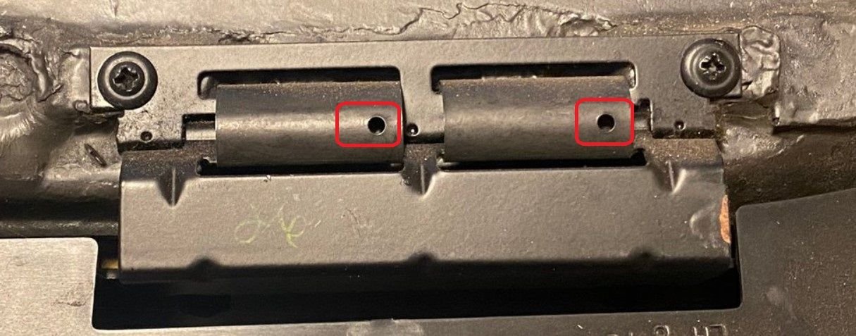

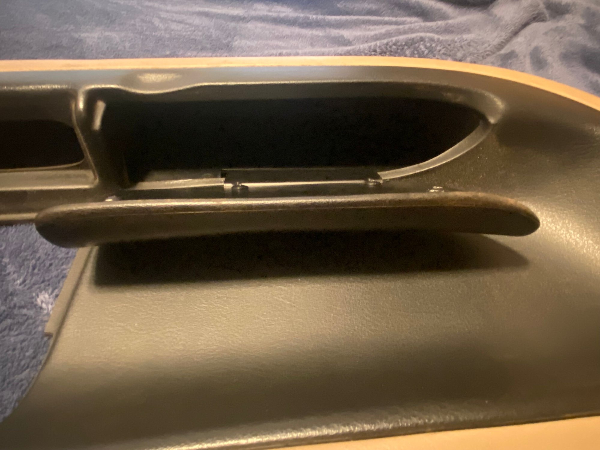

Either way, I have a 1995 with the storage under the armrests. The passenger side opens and closes fine. The drivers side closes fine but only opens about 1/3 of the way.

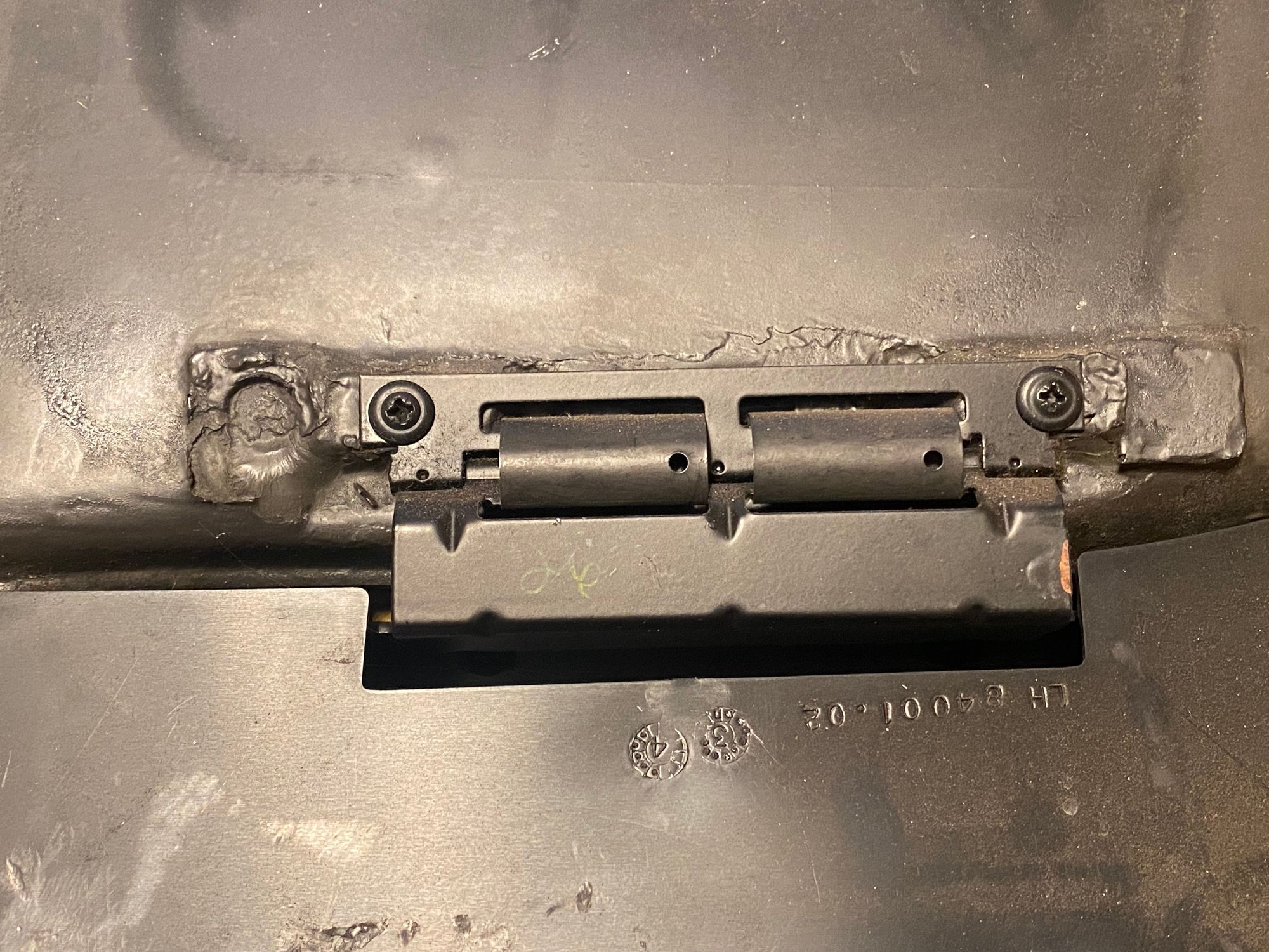

I decided to take the door panel off (had to tighten the driver side mirror anyways) and it doesn't even look like it would ever fit properly. The hinge seems way too small to allow it to work.
Anyone happen to have a picture or video or any type of instructions on how these are supposed to fit? I have a suspicion someone must've switched the hinge out at some point and got the wrong one.
I can also try removing my passenger side door, but when I did the drivers side a few parts fell off the hinge (some thin metal pieces), so I'm worried I might break something that's working fine now and lose the ability to reproduce.
I've searched for door panel replacement, etc, but haven't found where anyone has covered the doors with pockets. I can make a video later if anyone thinks they can help.
Basically wanting a sanity check on whether it really is an improper hinge or just put on wrong.

Thanks, yeah Rolla I figured it was meant to be opened like passenger side, but that would confirm it.
ChumpVette, the 2 parts I circled in red...those are closer to the rear of the vehicle? Trying to make sure I put them back in the right way.
I can't currently see how it would help what seems to be a fitment issue on mine, but maybe these rollers do more than I realize.
The dots are closer to the back edge of the door panel.
