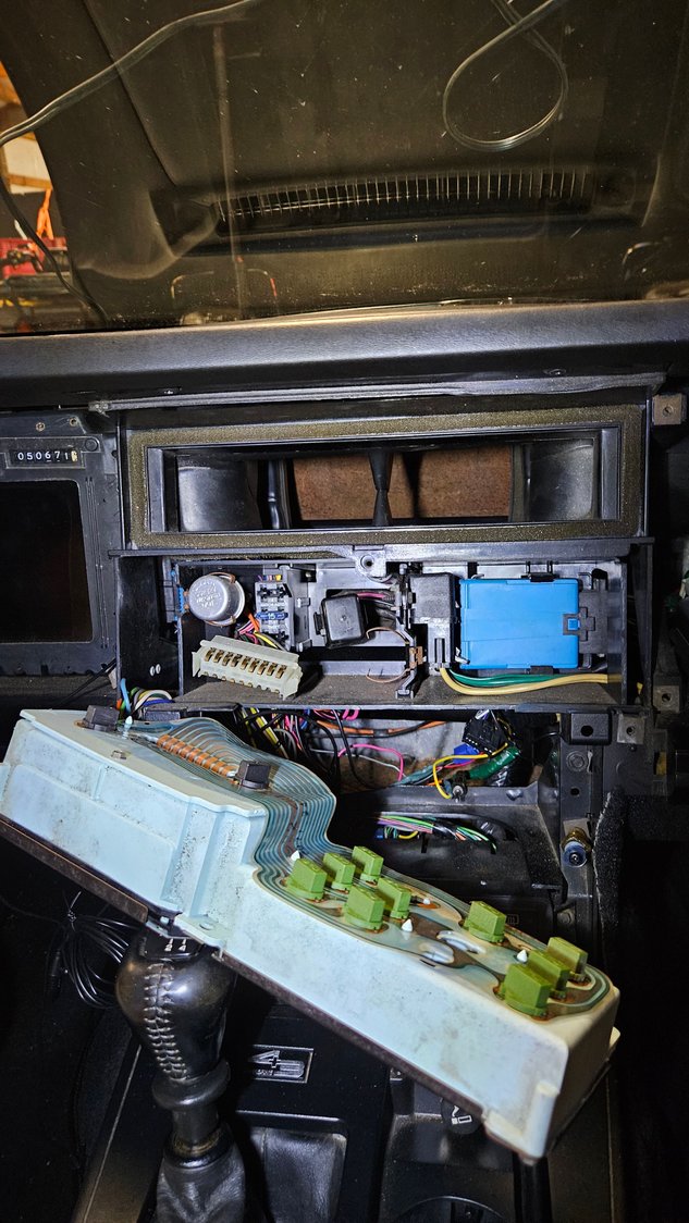

Old Sep 25, 2024 | 11:11 PM
2011KLR's Avatar
2011KLR
Joined: Sep 2022
Posts: 1,486
Likes: 395
From: Liberty, SC
Well, i will be darned... theyre back there....
on the left just beside the round hazzard lights flasher.
i had some things to do in the dash anyways so i went in a bit farther to get the pics.
and fixed my chimer too.
