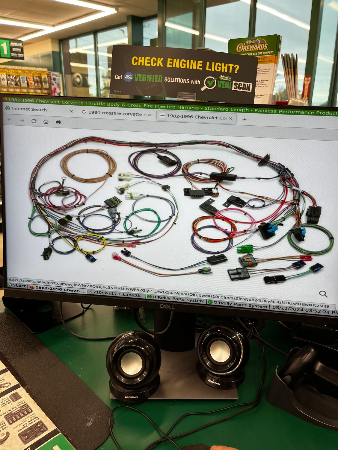

absolutely best idea to take on a full restoration at 19-20. I need a new wiring harness as everything about mine in the engine bay is compromised. However I have been made aware of swapping over to a LS style intake such as the pro flo xt and i wanted more information or help on how well it would go. Currently the vehicle will turn over but will not activate fuel injectors or fuel pump however the pump does get power.

Well for one if you want to swap on an LS intake, you'll need to swap in an LS block and heads... Are you an experienced enough welder to modify your engine bay? Not to mention you won't need that wiring harness because nothing on the LS will plug in to it.
The intake you show on the left states vortec style heads, which are different than the 624s on the cross-fire. The one on the right mentions sequential port, which your ECM won't control
Unplug the injectors, then stick a 9v battery to it for 10 seconds. Plug them back in then try and start it. Have you changed the fuel filter on the passenger side frame rail? Have you pulled the fuel line from the pump to confirm you are getting pressure out of the tank? The 3" long fuel line going from the pump to the hard lines in the tank turns into a gummy bear in ethanol fuel, or fuel that has sat for years and become lacquer
For the prices of the intakes you are listing you'd be much better off getting the cross-fire running, or doing a running junkyard vortec 350³ topped with the 7.4L dual 2" throttle body conversion. Plug and play at that point other than the air filter

interesting idea and youre probably right. I am a welder however I saw another thread where someone put a port injection air intake on another 84. The fuel injectors do work I jumped them with a 12v connection and they sprayed some fuel I think its just electrical issues but it would be better to switch to a port injection system as they run better.
I have replaced the fuel filter and drained the line, the hoses are not clogged as I cleaned them out fully with brake cleaner and compressed air when the filter was off. I havent confirmed the fuel pump is properly working yet but I do know its coming on.
also do you know if the vortec would work with the stock auto trans or should I zf6 swap it.
