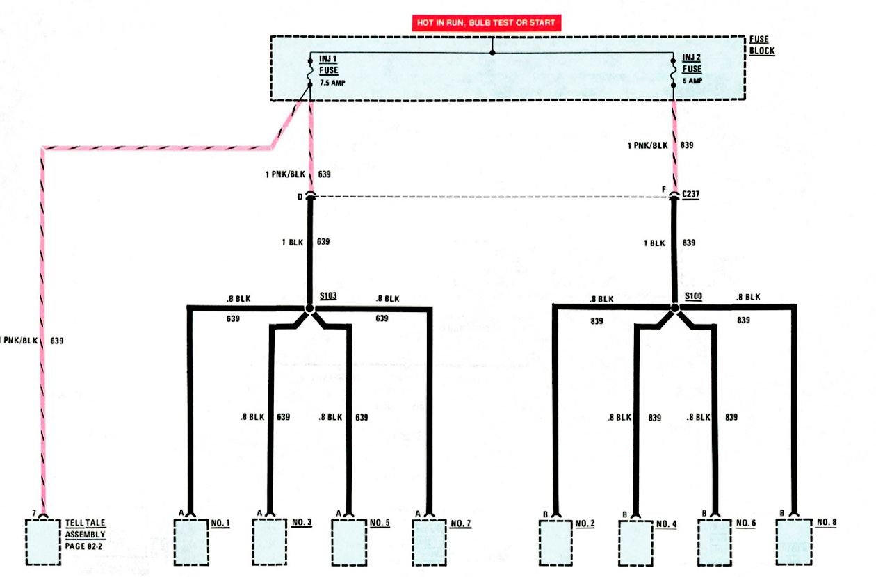

In all other GM vehicles that use Multi-Port Fuel Injection (MPFI), which is what TPI is, there are two fuses in the fuse panel for the injectors. There's one for the left side, and one for the right side. They fire in banks (batch mode). This is different than Sequential Multi-port Fuel Injection (SFI)... which in my opinion is much better... but wasn't common on cars until the 90s. That's where each injector fires just before the valve opens. With MPFI, it dumps fuel on one entire side of the engine, which then pools above the valve and sits there until the valve opens. We're of course talking a fraction of a second, but SFI provides significantly better "around-town" performance. Above 3,200 RPMs though... it stops making any difference.
Anyway, I would check your fuses. You likely blew one of the fuel injector fuses.
See this diagram I just looked up. It's apparently identical to my Fiero's V6 (Note, this is for a C4 MPFI/TPI Corvette):
You'll note the two fuses that say INJ1 and INJ2. One of these is likely blown.
It COULD be that you've blown one of these fuses because an injector is starting to go bad, but changing the fuse is the first step, and it should start working again after that.

I am using an 87 schematic which should be the same but wanted to let you know this. See if you have lost voltage or ground to the injector. I just checked my car for you and KOEO on my car has constant 12V on purple/blk (cyl 1,3,5,7). The fuse block via C-237 provides voltage. The ECM provides pulsing ground (creating base pulse width BPW). If your condition is as you say it is you can use the opposite side as an example for testing. Pull all the injector connections off the bad side, if one has completely shorted it will pull all of them down. These injectors do not make a very bright noid light so double check the bad side. You can ohm the injectors out in place.
