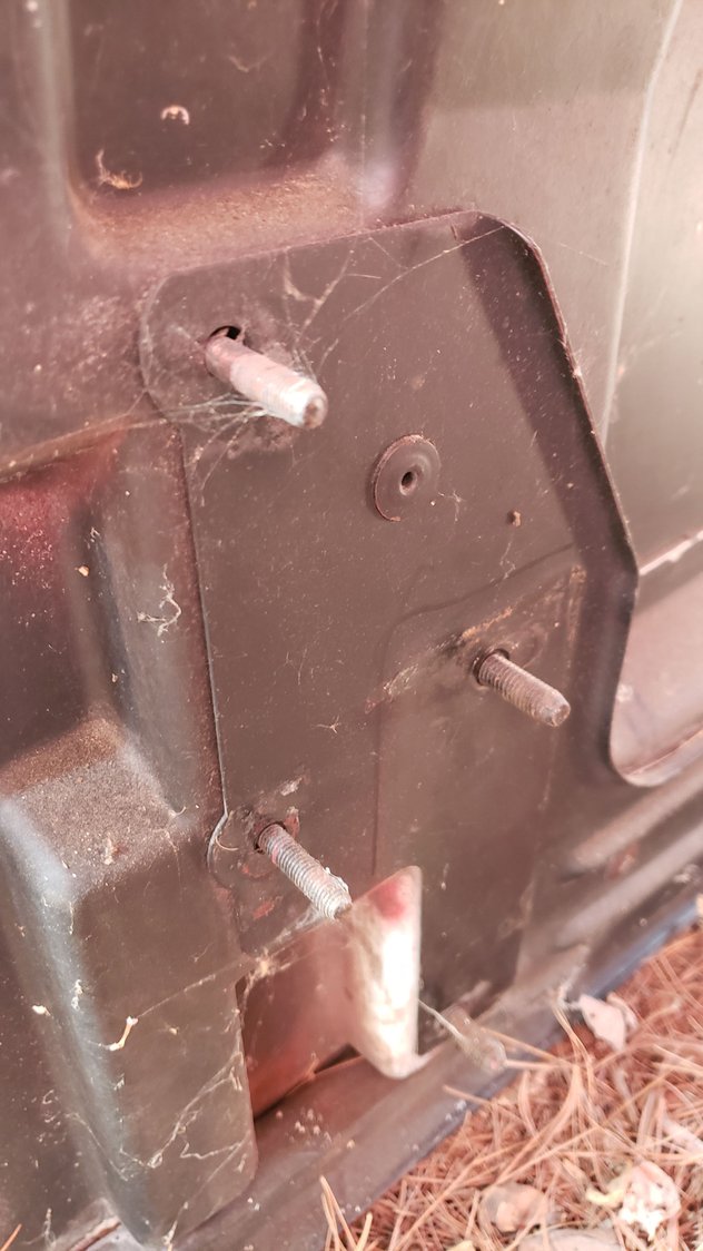

Bolt missing on hood / hinge... thoughts?

Originally Posted by Joe C
try putting a (metric) bolt in there - that will tell you real fast if it's just a hole or there's a nutplate. this can't be rocket science.
This ^.

Originally Posted by rocco16
This ^.
We already figured it out. It's a double-sided bolt that's supposed to be directly threaded into the SMC (see other replies), which was ripped out. I'll have to take the hood off, remove the bracket's and pack / fill the hole with SMC compound and chopped glass mat. Then, when it dries, I'll drill it to the interior diameter of the bolt, and screw it in.

From my old hood out by the shed....
For reference...
For reference...1988.

^^^^ That's like mine and to extract an OE/GM stud you would have to remove the riveted reinforcement or perhaps use a hole saw to bore a hole larger than the diameter of the securing flange of the OE/GM stud. See #3, #16 & #17
