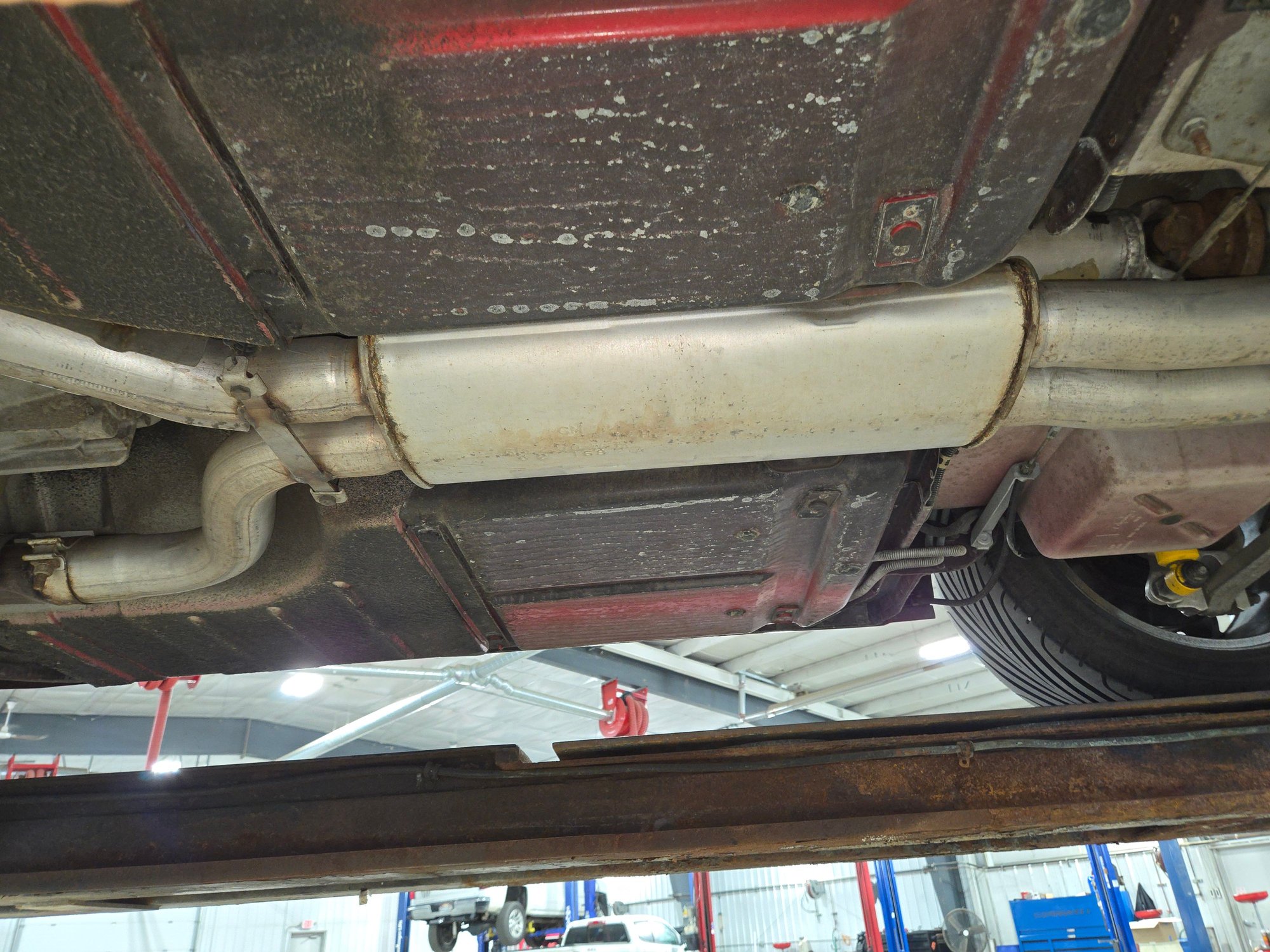

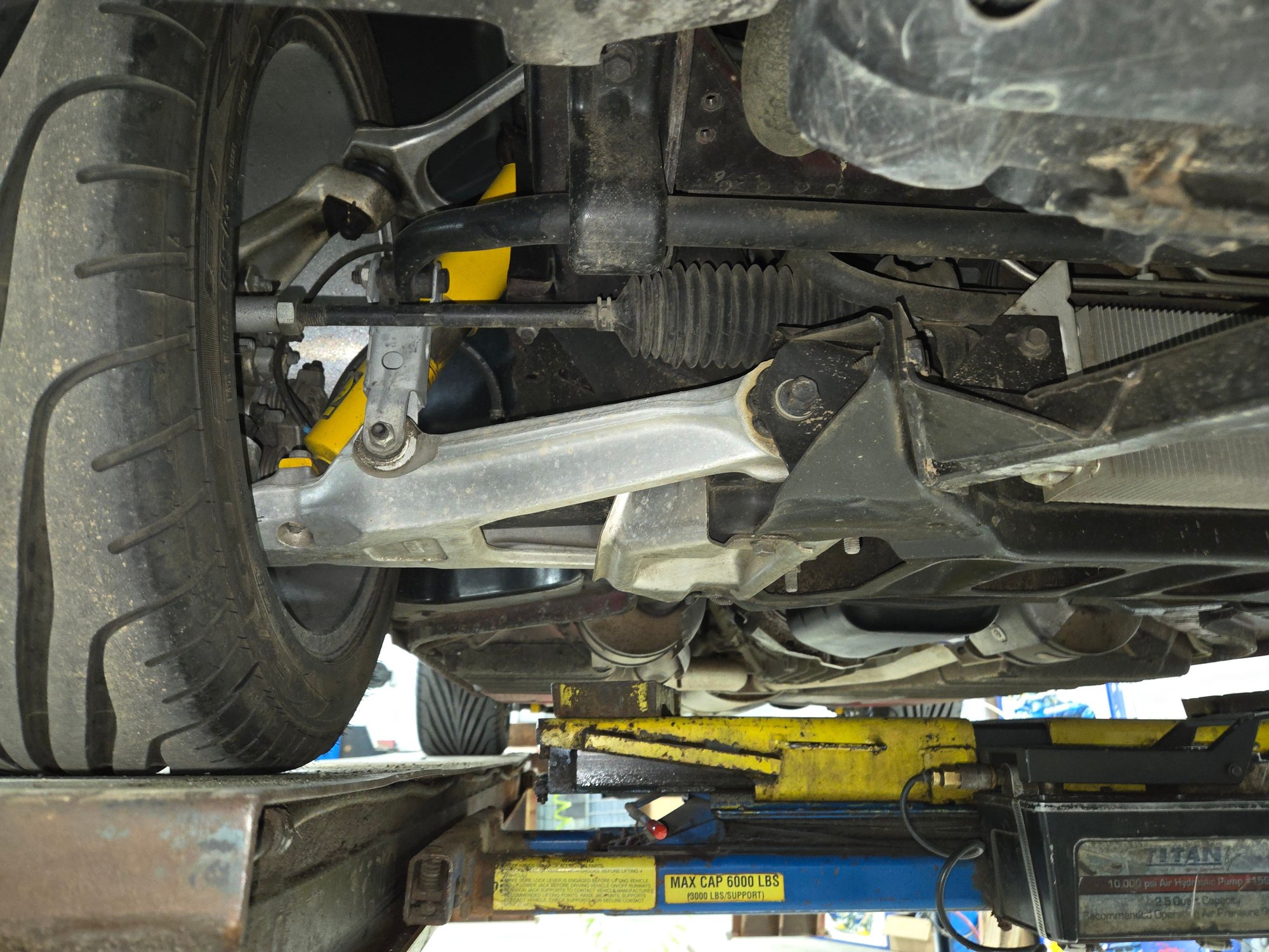

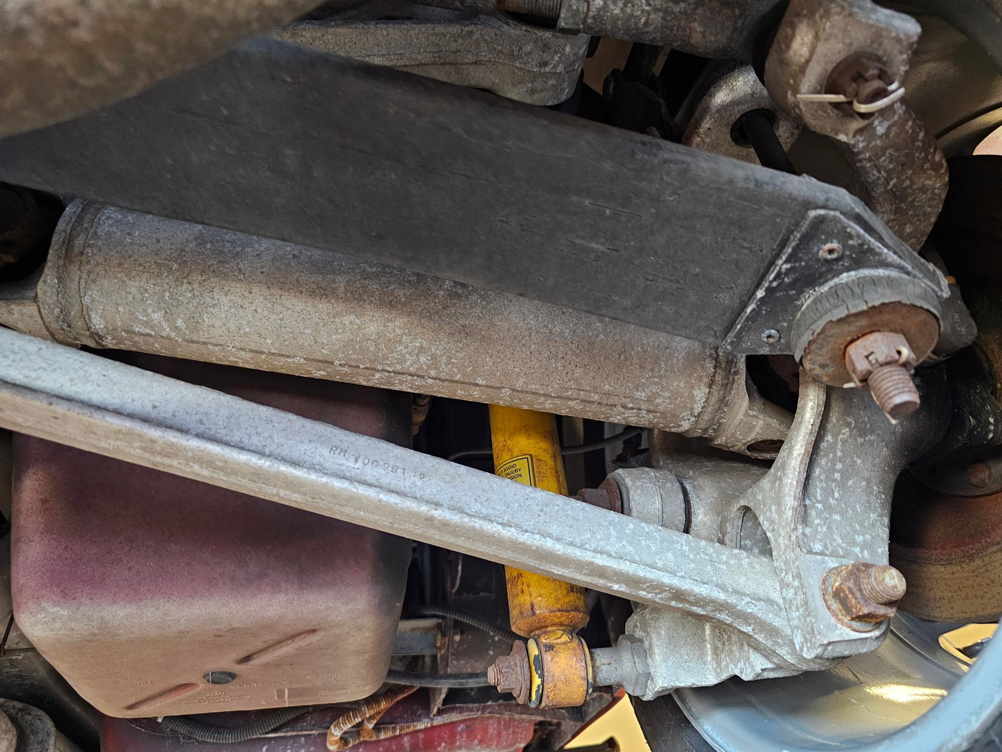

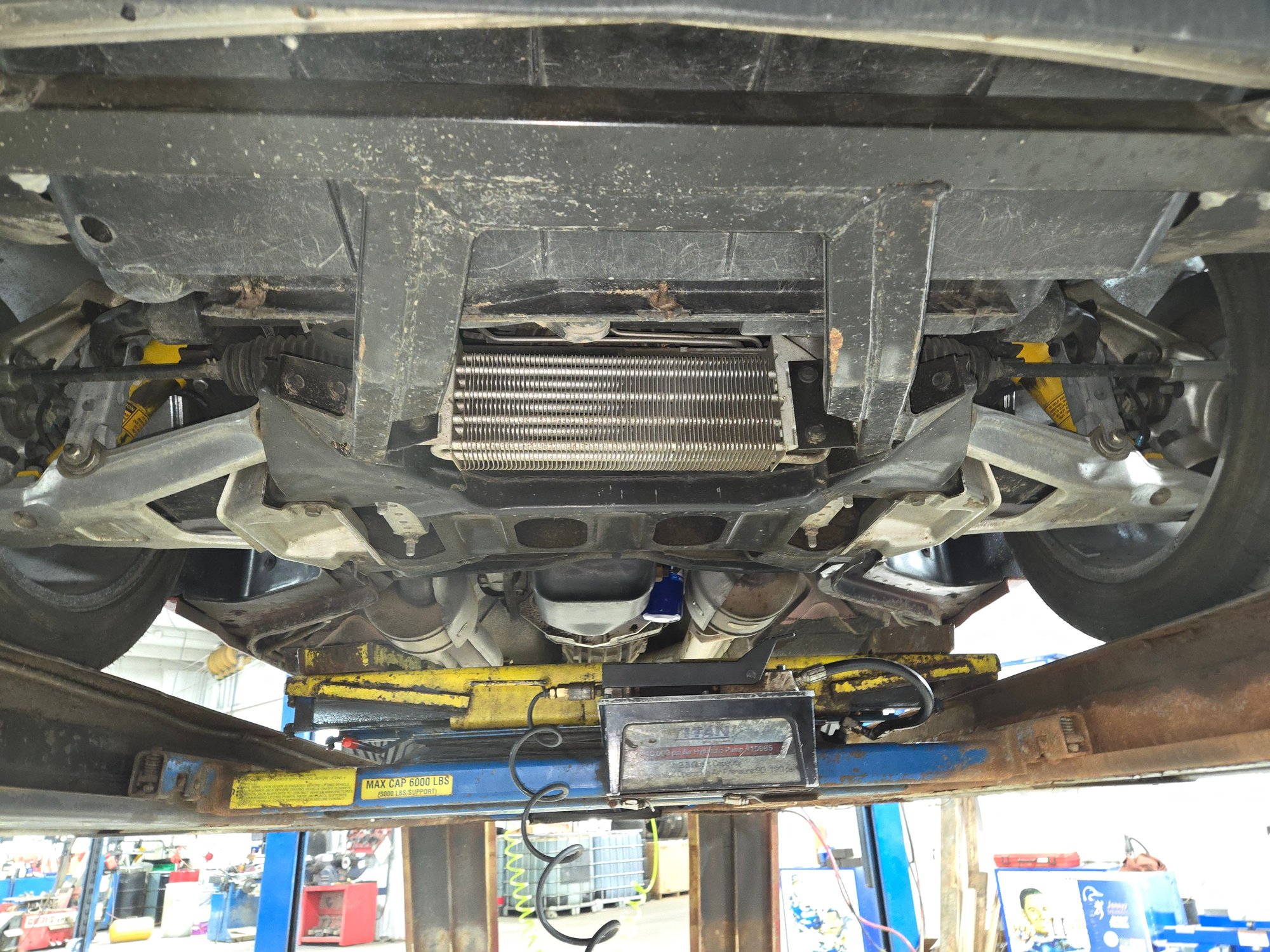

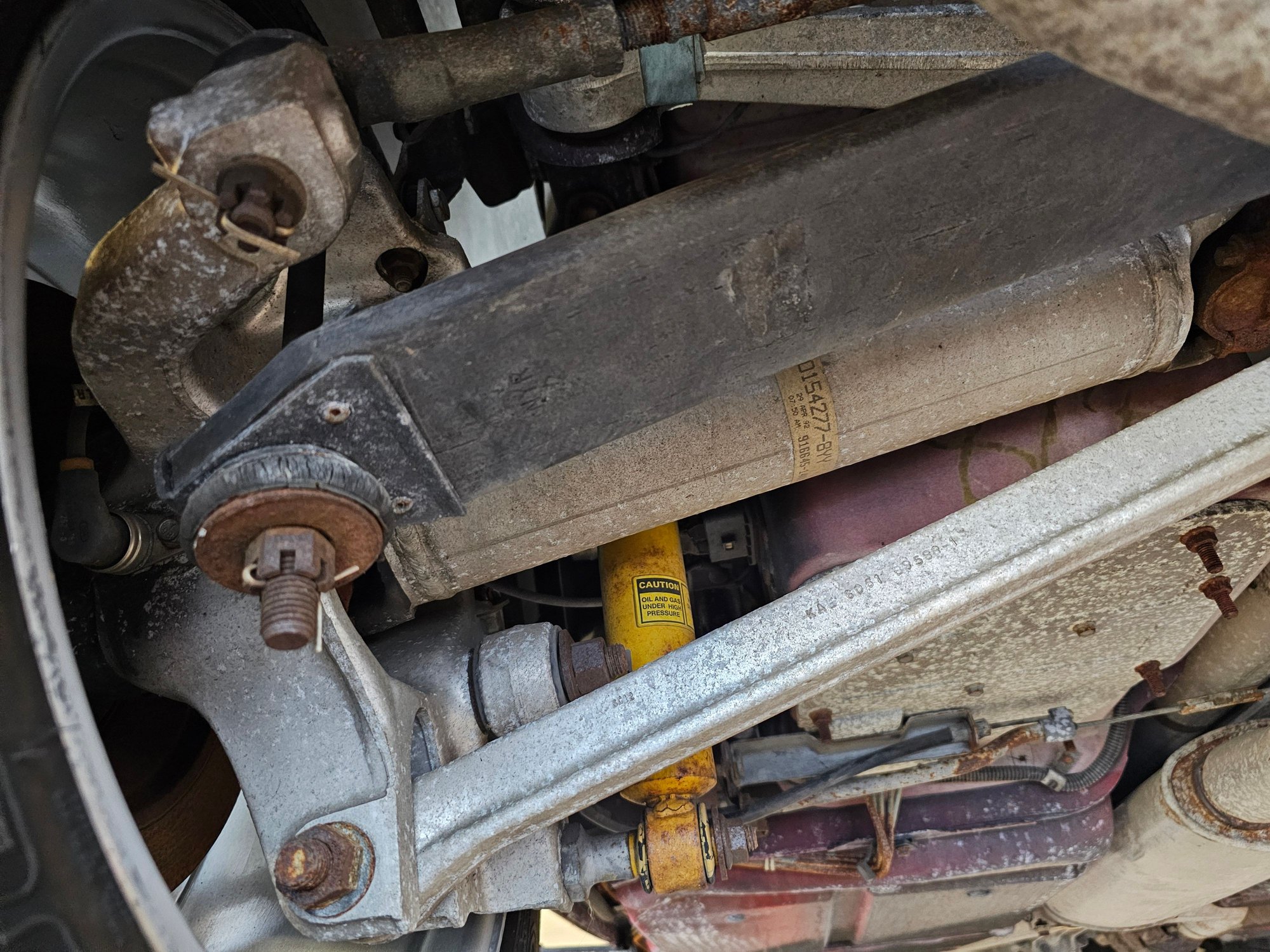

By the way, I recently received photos of the LT1 chassis from a US seller. How do you rate them? Is this white coating (scratches?) on some elements signs of normal wear?

Could anyone rate these photos of the chassis? Is it in good condition or should I look for another car? I would appreciate any opinion - I am not able to see the car in person, and I haven't seen many C4 chassis for comparison.
Car has sat outside in a moist environment. Nothing to alarming, but if you are wanting perfect, it is a pass.

Looks to me like that car has been on salted roads. Certainly not a deal breaker but maintenance will be a little more difficult with rusty bolts/nuts.
I live in the North West so there is no rust on my car at all, even after 38 years. My daily driver I bought from my brother in Ohio. That car is only 10 years old and I had to cut the rear calipers off when I changed the brake pads. That's what salted roads do to cars.

In my neck of the woods I would pass, (South West US) I bought mine for 10K with no rust and just basic items needed like tires and breaks.

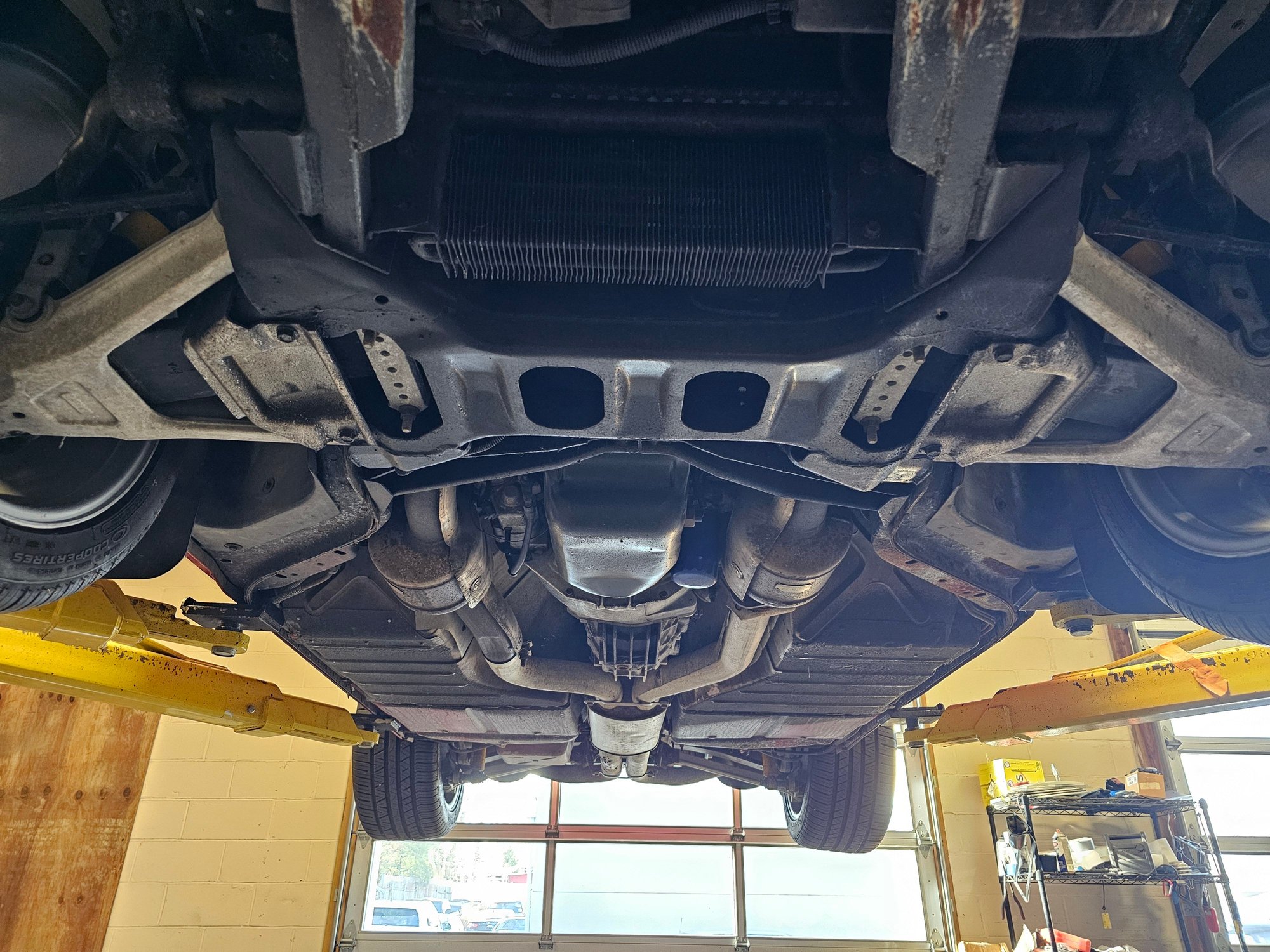

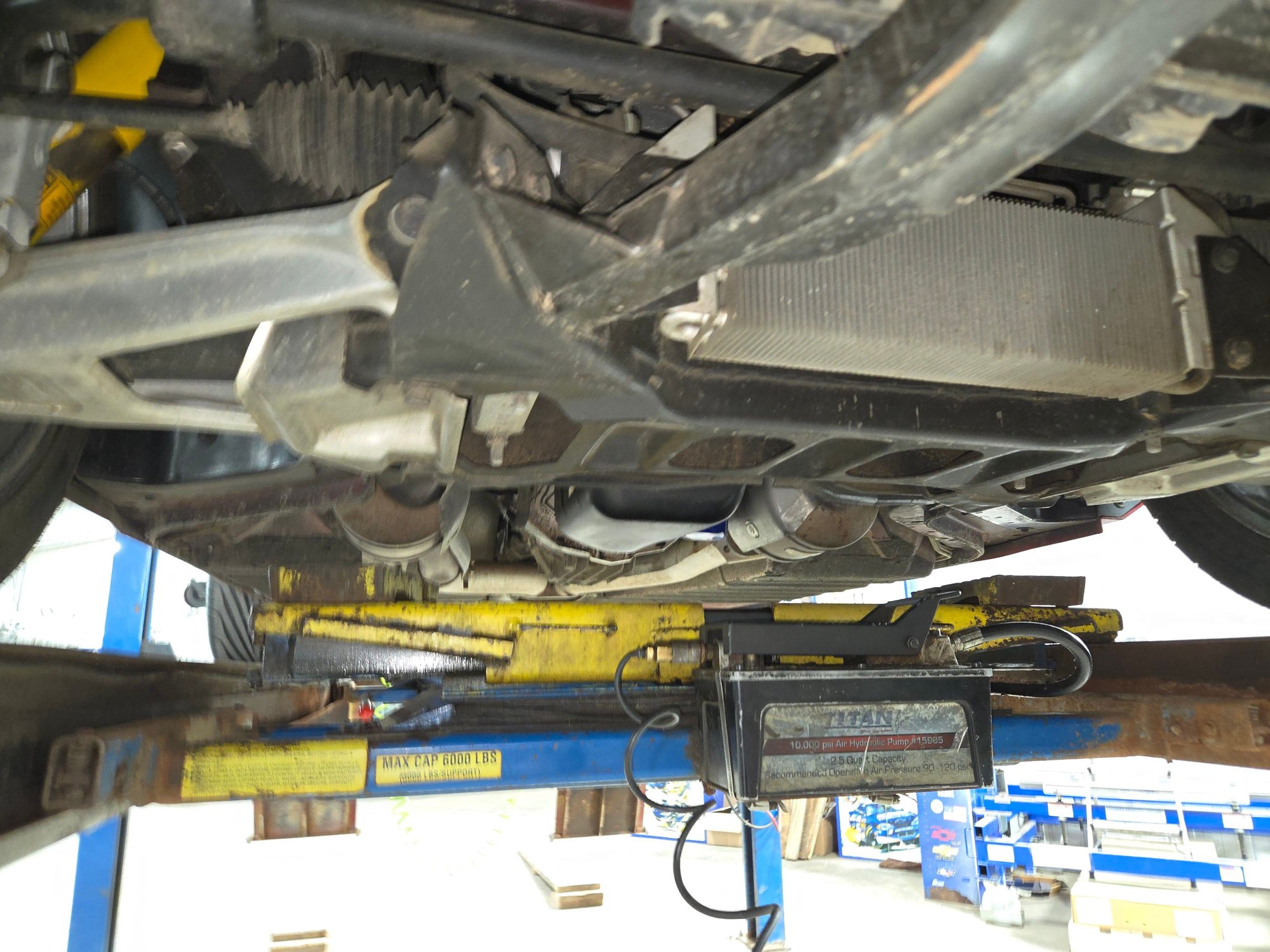

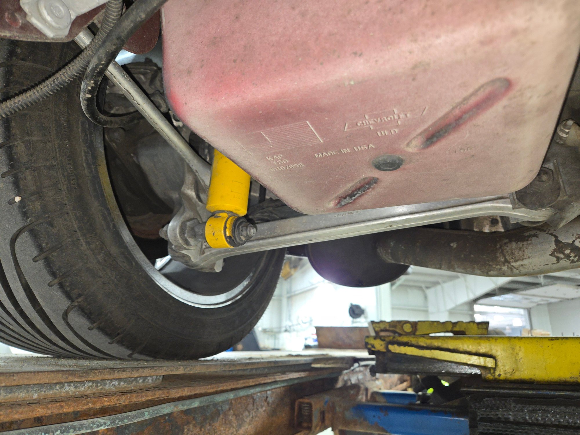

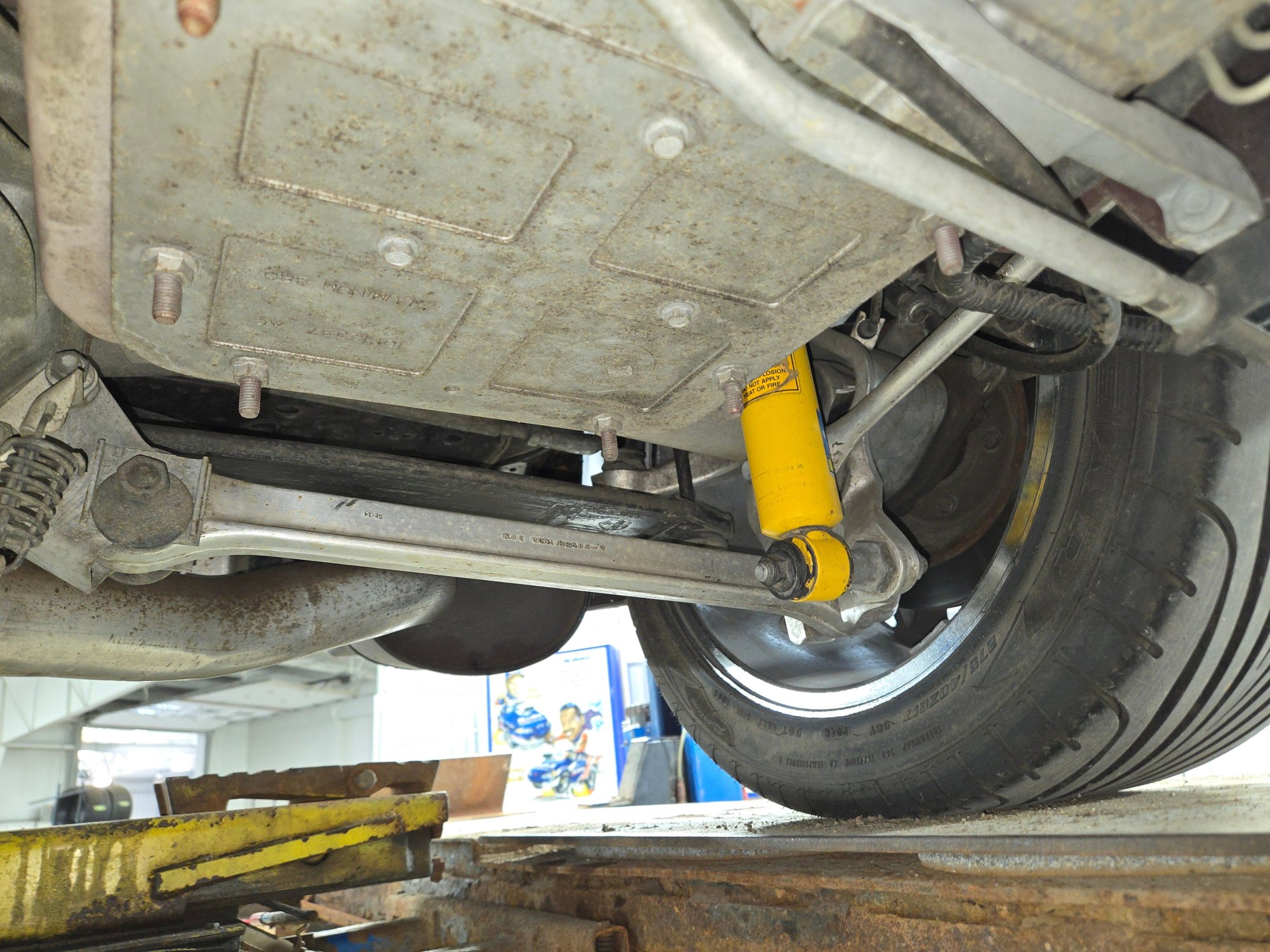

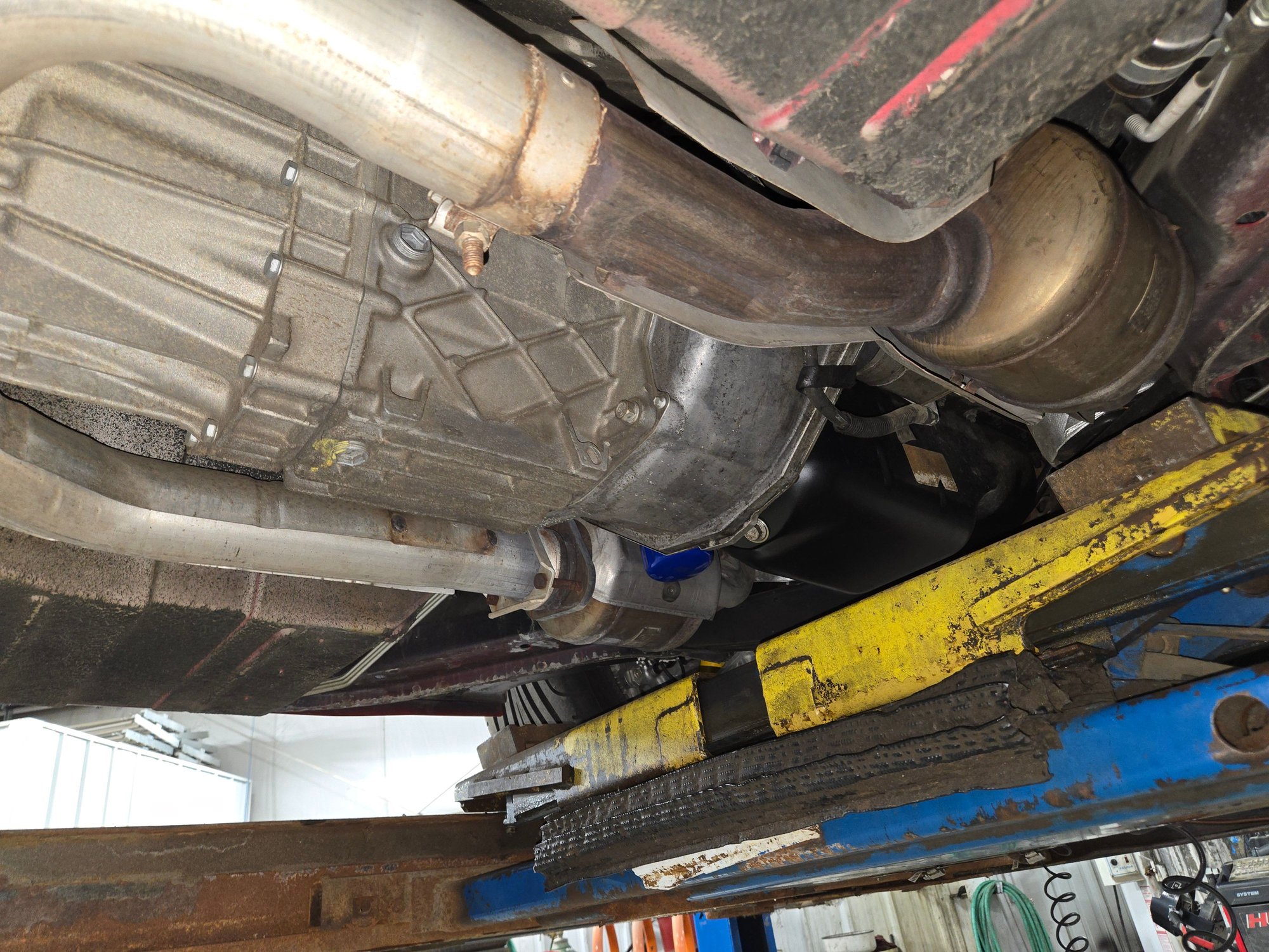

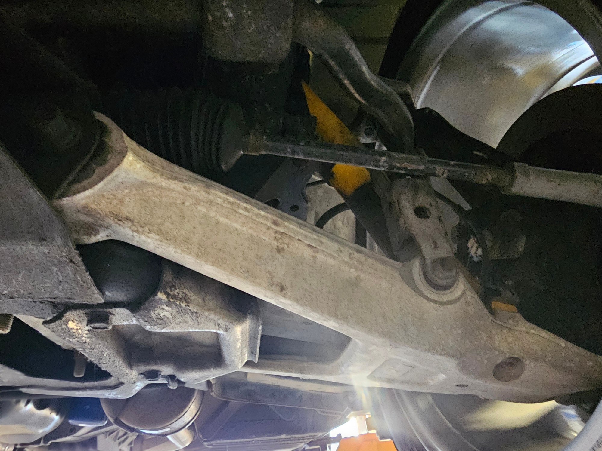

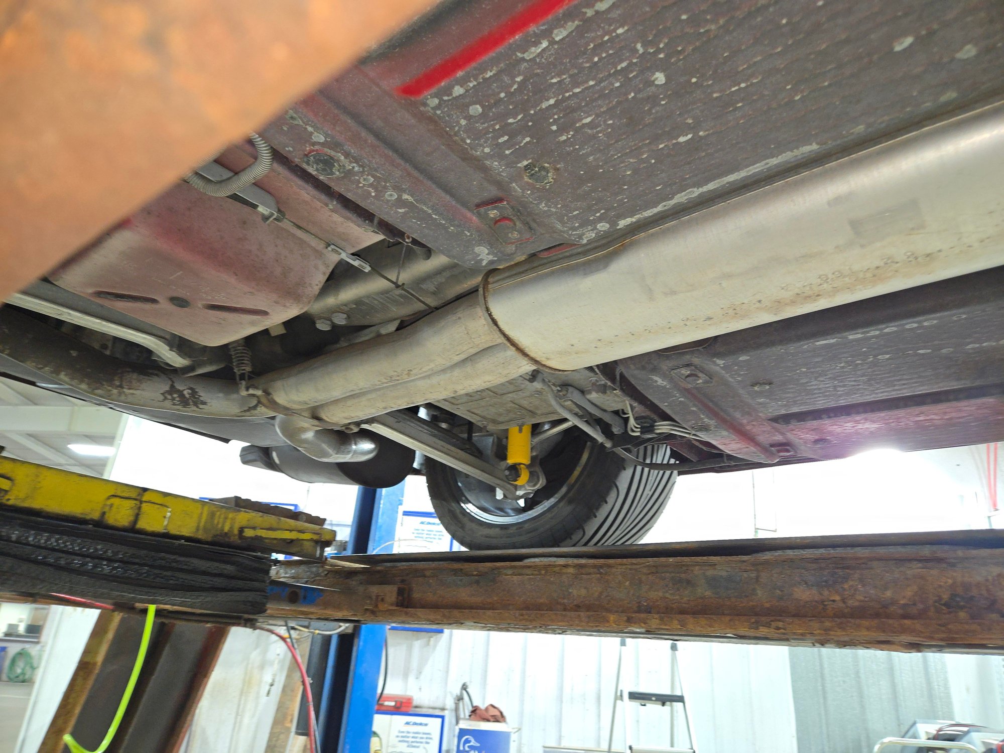

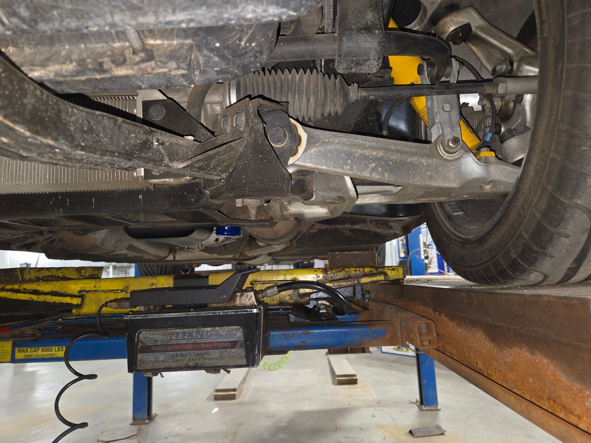

I found another car. I am attaching some photos. What do you think?
I think the car looks OK, but I have very serious doubts about it. I downloaded Autocheck and it shows that the car has been unused for 21 years (!). It's a 1992 LT1. Mileage is less than 30,000 miles. I realize that many elements, especially rubber ones, will need to be replaced. On the other hand, it's probably a nice collector's item. Would you buy such a car?
The dealer claims that the car was under a roof during this time. The engine starts.

Second one is definitely a lot cleaner underneath. Not as much corrosion.

I downloaded the Carfax of the car in the photos (vehicle no. 2). There are no entries about servicing from 2000 to 2022. During this time, the car has traveled approximately 3,700 miles and only the title was renewed annually. The car looks very nice from the outside and inside. I'm wondering whether to take the risk or let it go. While I can handle the rubber suspension elements, I wouldn't want to end up with a disaster in the engine (however, I did get a short video of the engine running).
