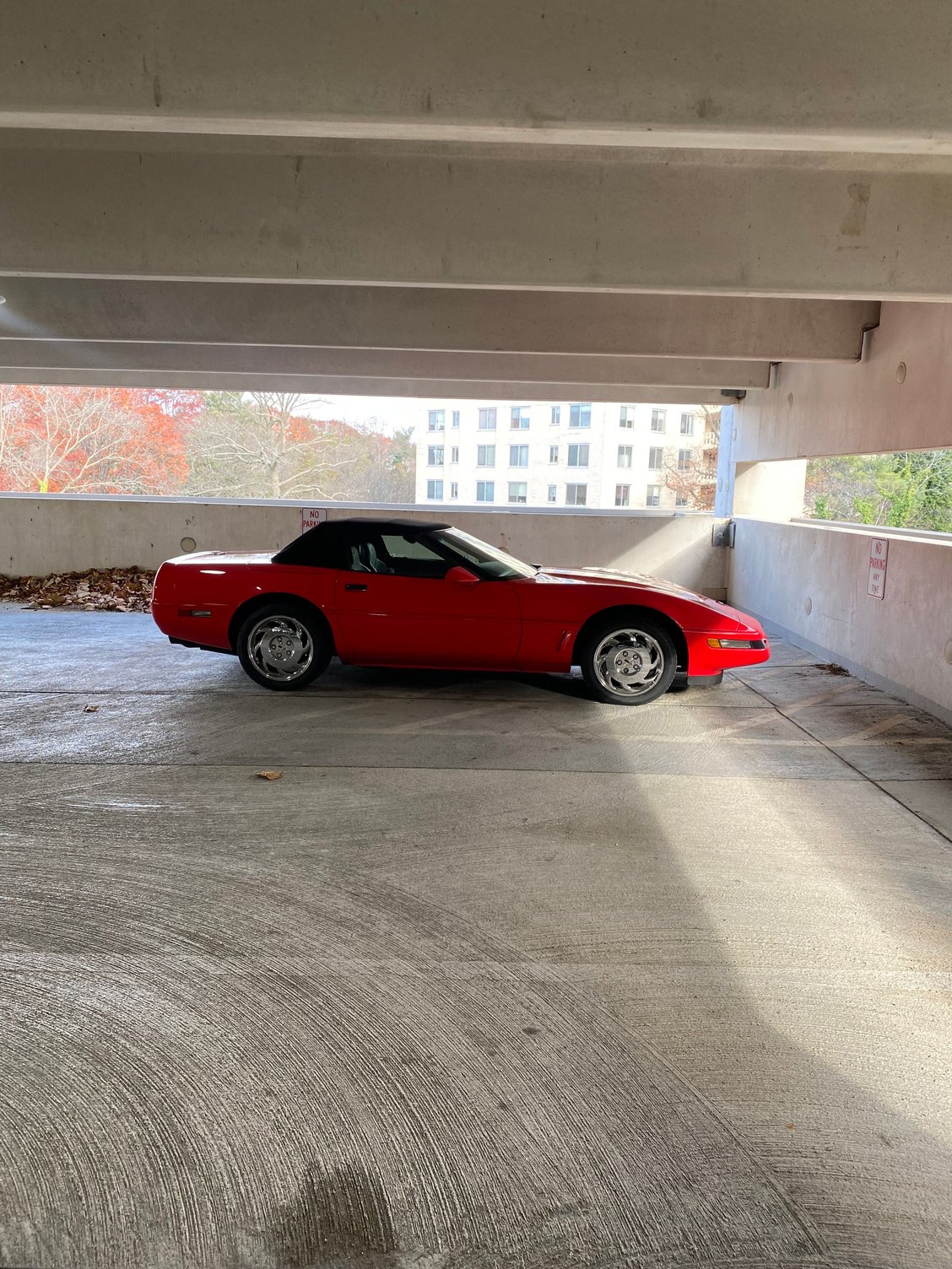

Can I put Michelin pilot sports tires 275/40/17 on my 95 C4

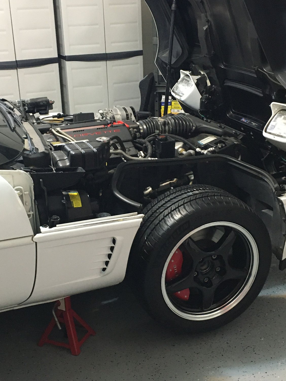

Yes indeed, here is that exact tire on my 96 with Z51, and might I say they are excellent tires at that!

The base '95 has 8.5" fronts and 9.5" rears. The Z51 ( and I think '95 has another option too) has 9.5" all around.
The 275/40/17 tires are not suggested for 8.5" rims. They fit well on 9.5".
Although yours is a '95, it is hard to tell, but it appears to have the '91-'92 wheels that have been chromed. You can tell by a flat on the vane on the '93-'96 wheels.
If it is the '91-'92 wheels, they only came in 9.5" and you will be fine.
Another option if they are 8.5" fronts is to buy a pair of 9.5" and then mount 275/40/17 or 285/40/17 tires all around. That is what I did on my '95. Although if yours are chromed, it would need a new set of wheels to match.
Good luck.
