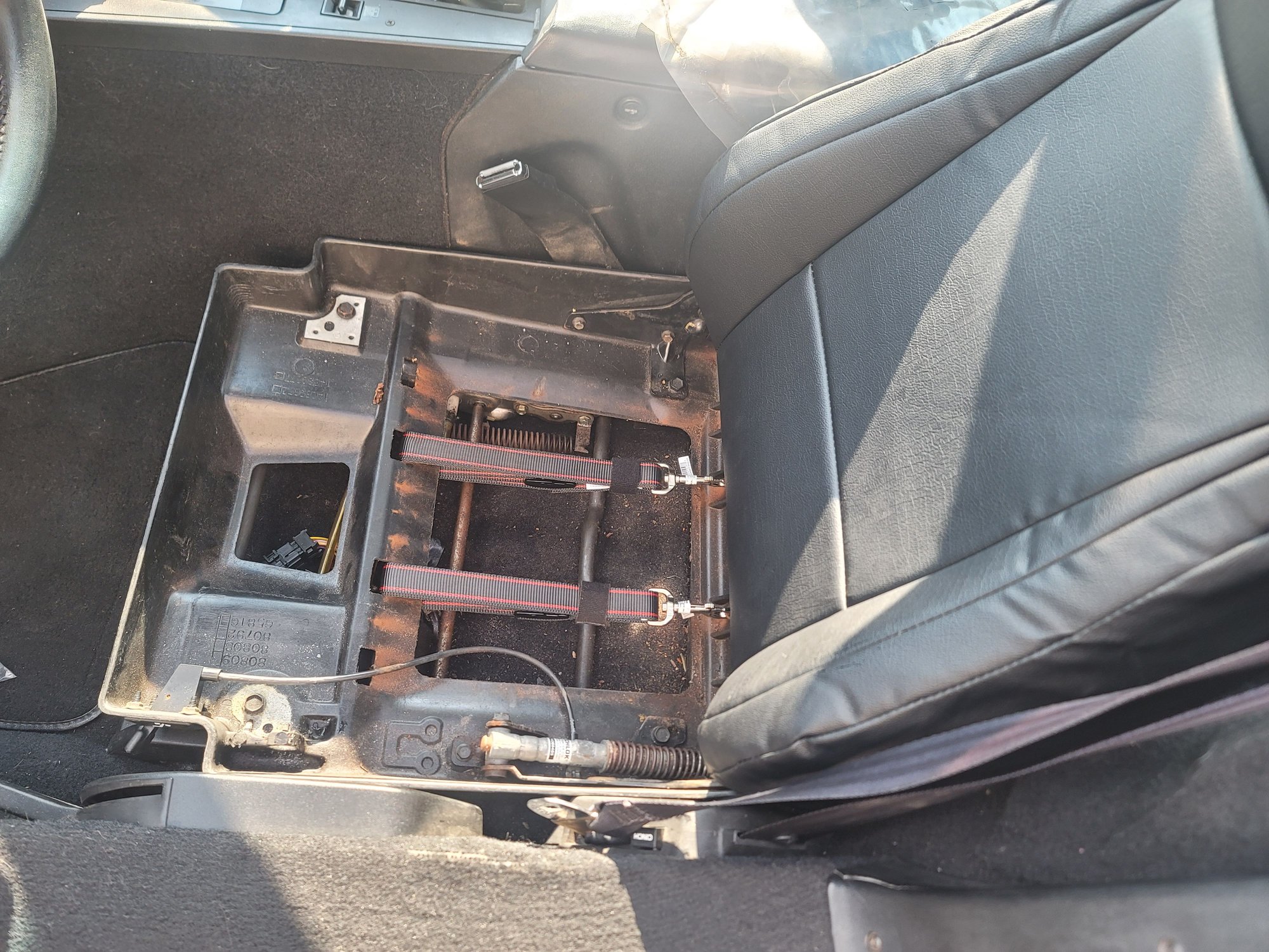

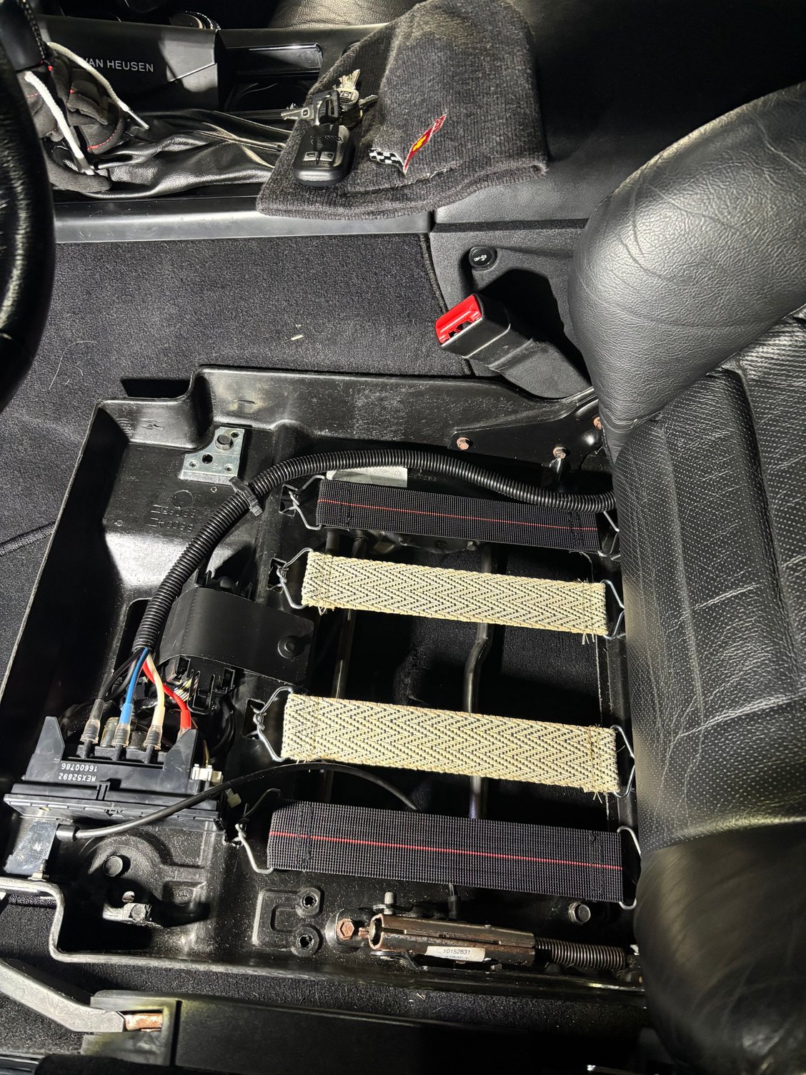

I guess since the C4 seat has space for 4 straps but only has 2 is that the accountants overruled the designers to save 50 cents per seat. Decided to see what adding the other two straps would do. Being 6", 270 lbs I like it.

I added the extra straps to both of my seats and it made a noticeable difference. It doesn’t feel like I sink in as much when I sit down.

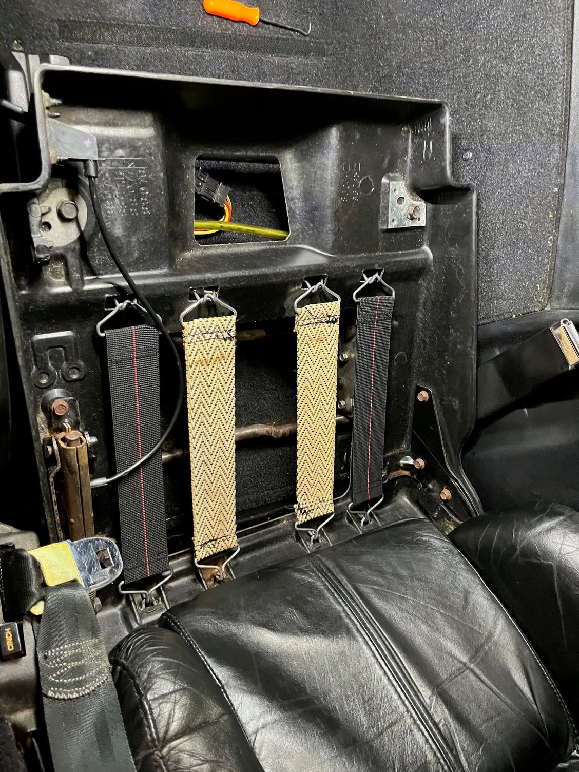

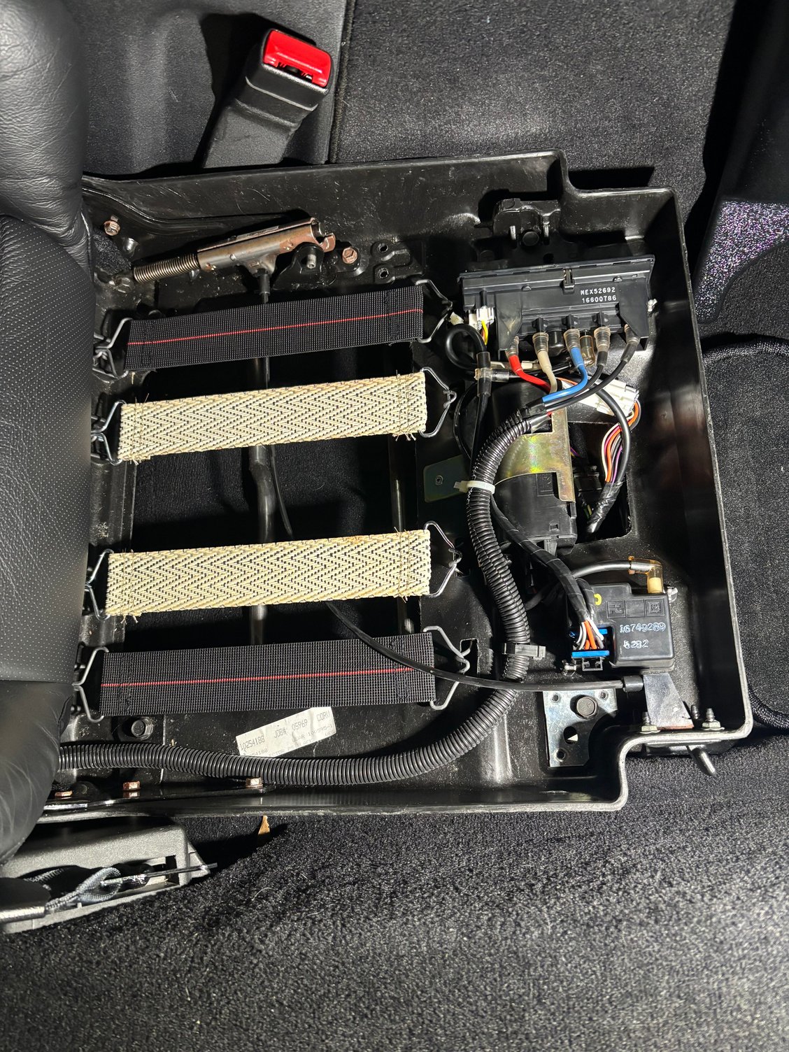

Agree, thanks for the info dburgjohn. I just got a set for both seats and installed them last night. Gonna see how it feels today when I drive it to the office.
Driver side
Driver side
Passenger side
Passenger side

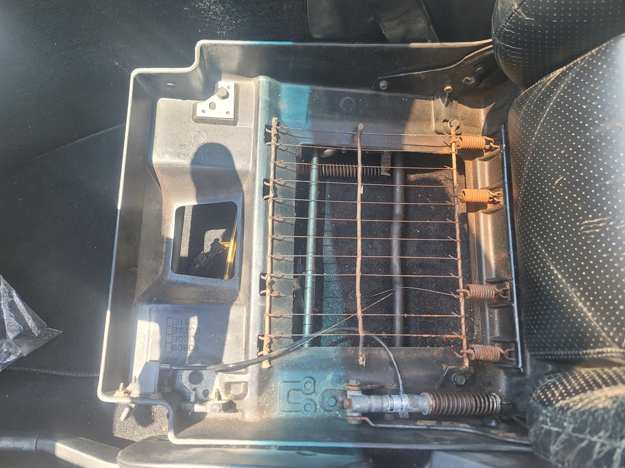

Not sure if you just want to go for a quick fix, but when I was working on redoing my seats I just got some cargo straps and hooks (less than $10 per seat) and figured it had to be better than the rusted grating. Made a HUGE difference in how it felt in the seat and I am at 250lbs.
The straps used in my seats are elastic, guessing the setup you did is quite a bit firmer than mine. I would have tried that first if the thought had occurred to me (have a box full of those). The great thing about this forum is the creativity here. There is always more than one solution to any issue.
