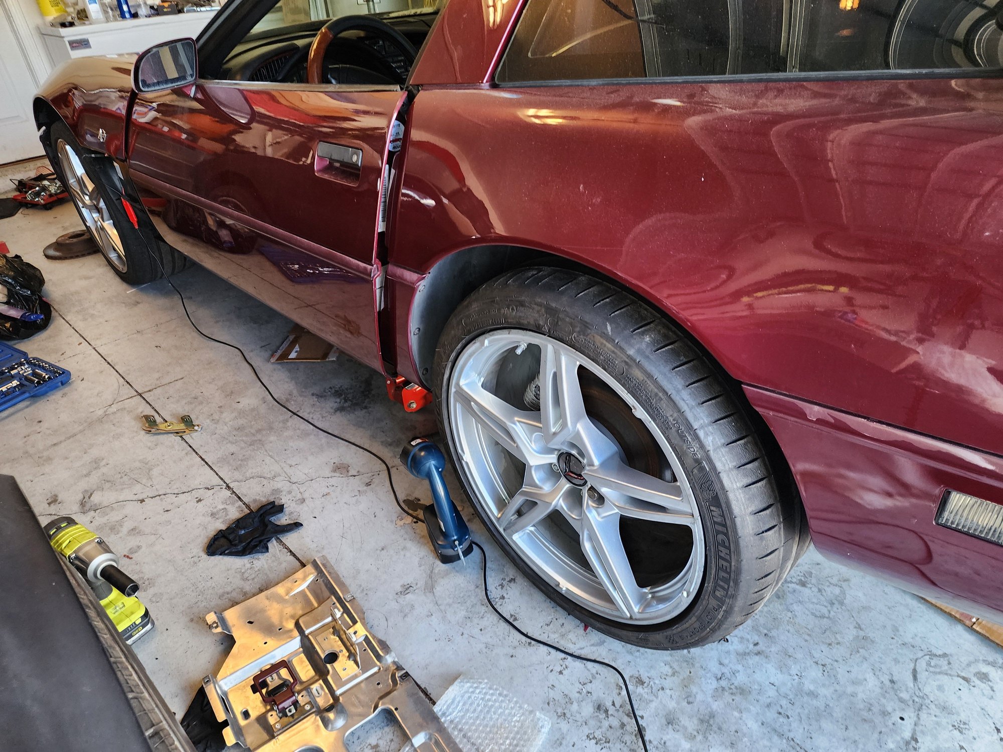

Corvette_Dez's Avatar
Corvette_Dez
Joined: Aug 2022
Posts: 1,507
Likes: 427
From: Ruskin, FL

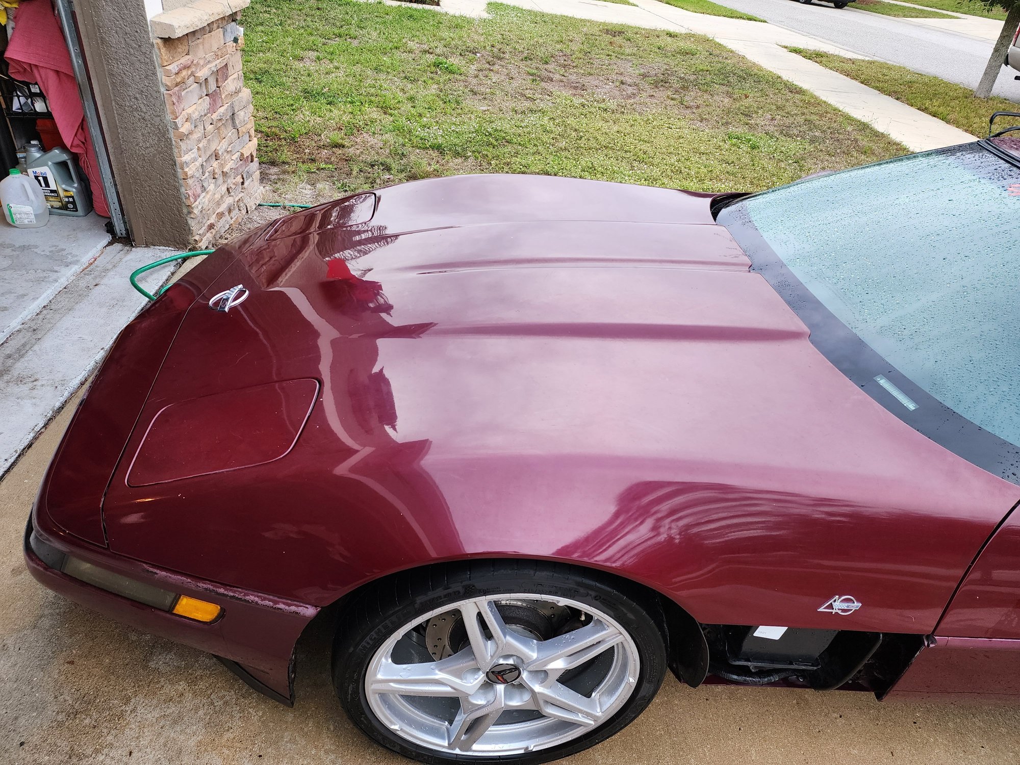

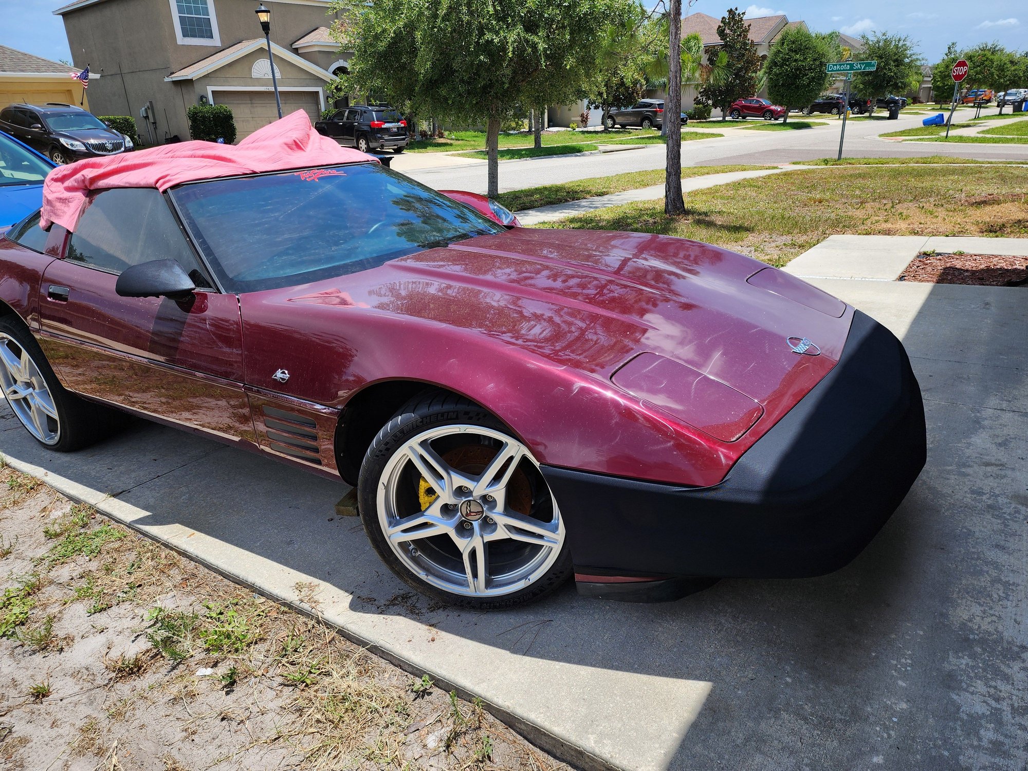

This picture is right off off the jack stands, before full weight returned the car to normal level.

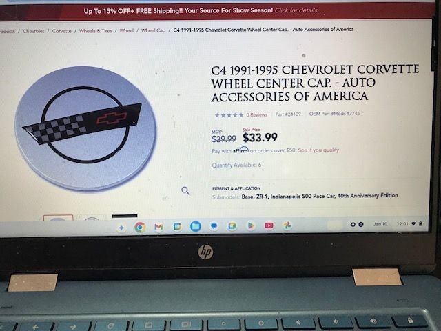

From: Dayton Ohio

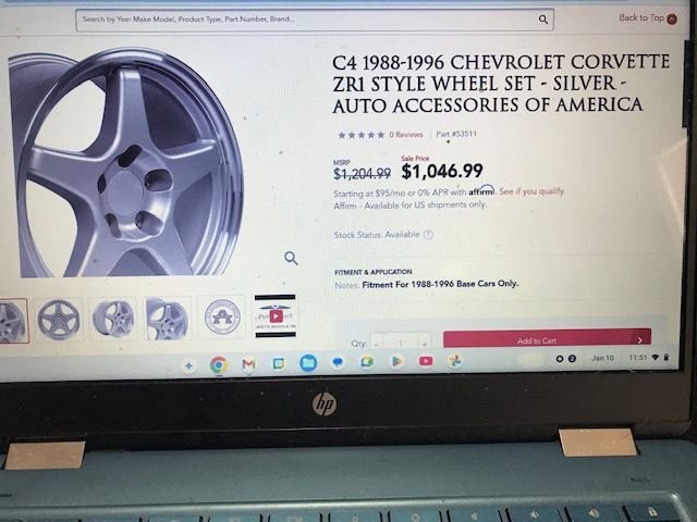

Just pulled the trigger....for anyone else considering these, I got everything above with free shipping and 15% off (promotion until 1-16), so it was only $1,080.91 in total.

https://www.oewheelsllc.com/ZR1_wheels_4
You paid too much.

Yes looks like it....mine are $890 with the 15% off. I wonder if they are the same manufacturer or they are made by different companies, hmmm.
