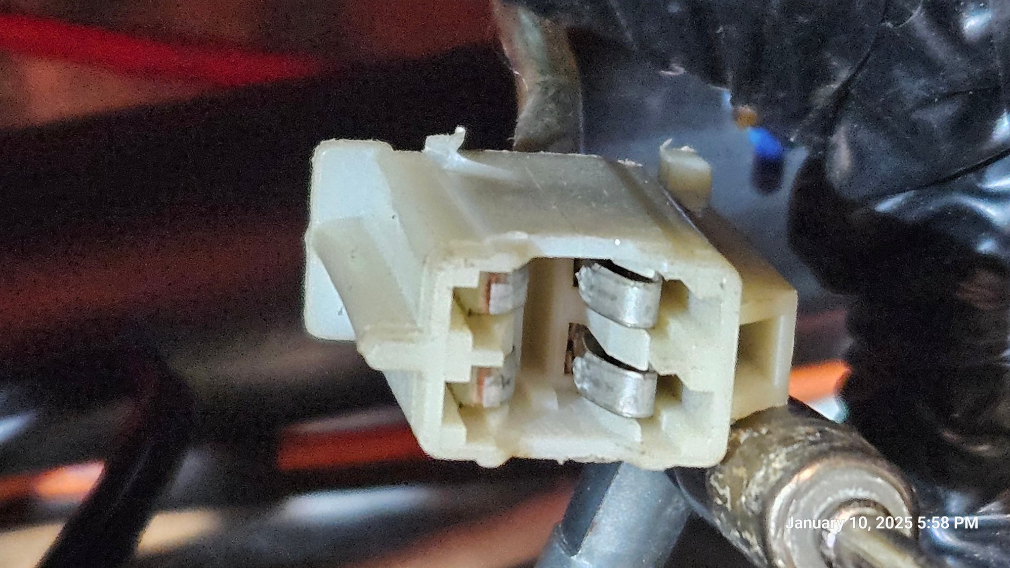

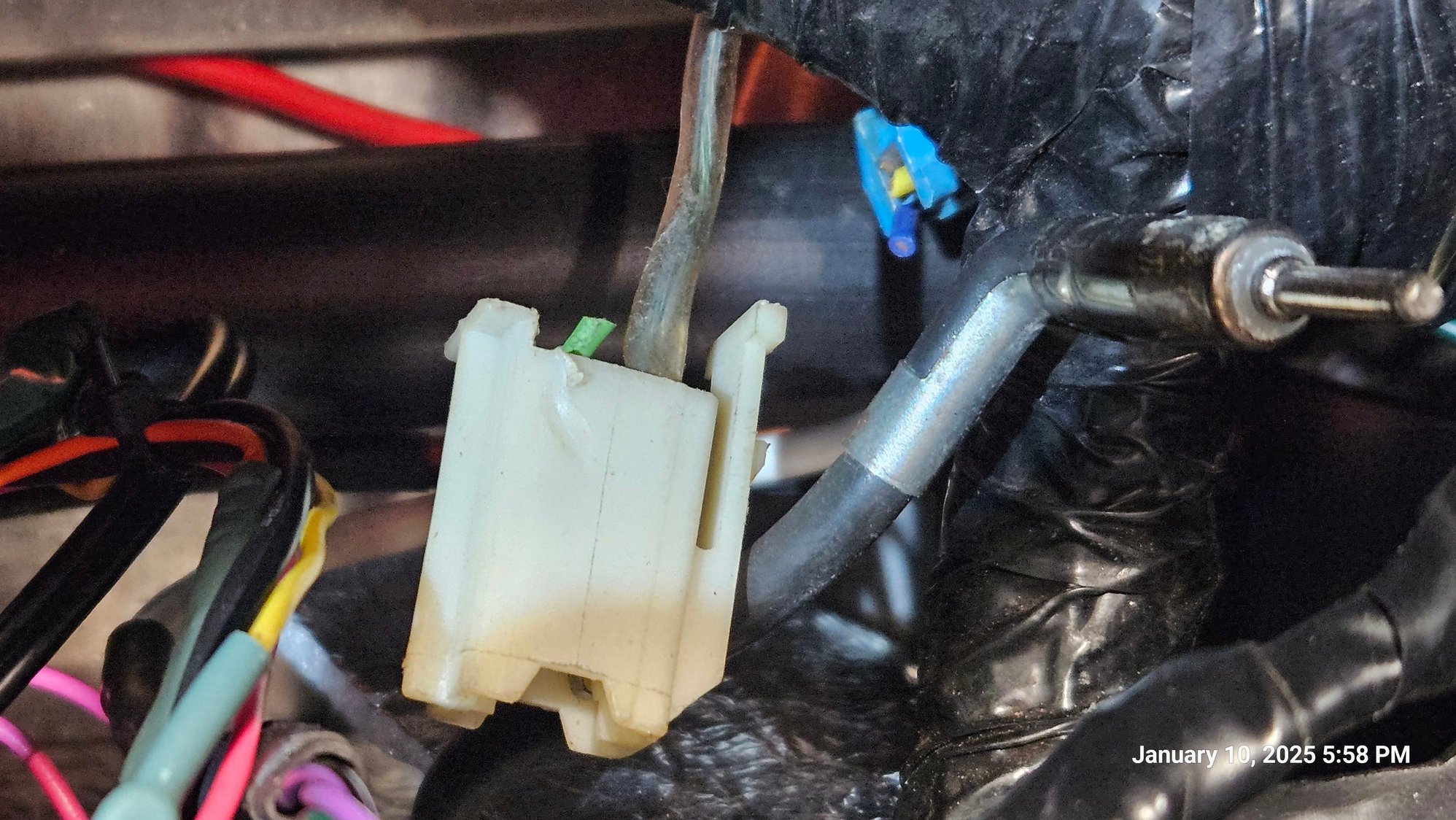

Today i started my double din conversion... while i was in there i saw the remnants of the shielded wiring. Best i can figure there would be 2 pairs of wires shielded coming from this connector... but, if it helps, this is what it looks like.

What are these 3 connectors for?
Old Jan 13, 2025 | 09:40 AM
2011KLR's Avatar
2011KLR
Joined: Sep 2022
Posts: 1,486
Likes: 395
From: Liberty, SC
Since most of my connectors under there were quite butchered or totally missing, I wont recognize anything by the connector.
And, I don't have an 85 FSM.
Looking at this 87 FSM I have, there is a pink wire that energizes the Amp relay for the Bose system. A second pink wire coming from the radio goes to the power antenna.
The only Orange wire i see is an always hot line coming from the CTSY/CLK Fuse.
Black is most always ground.
Use a volt/ohm meter to check things out.
