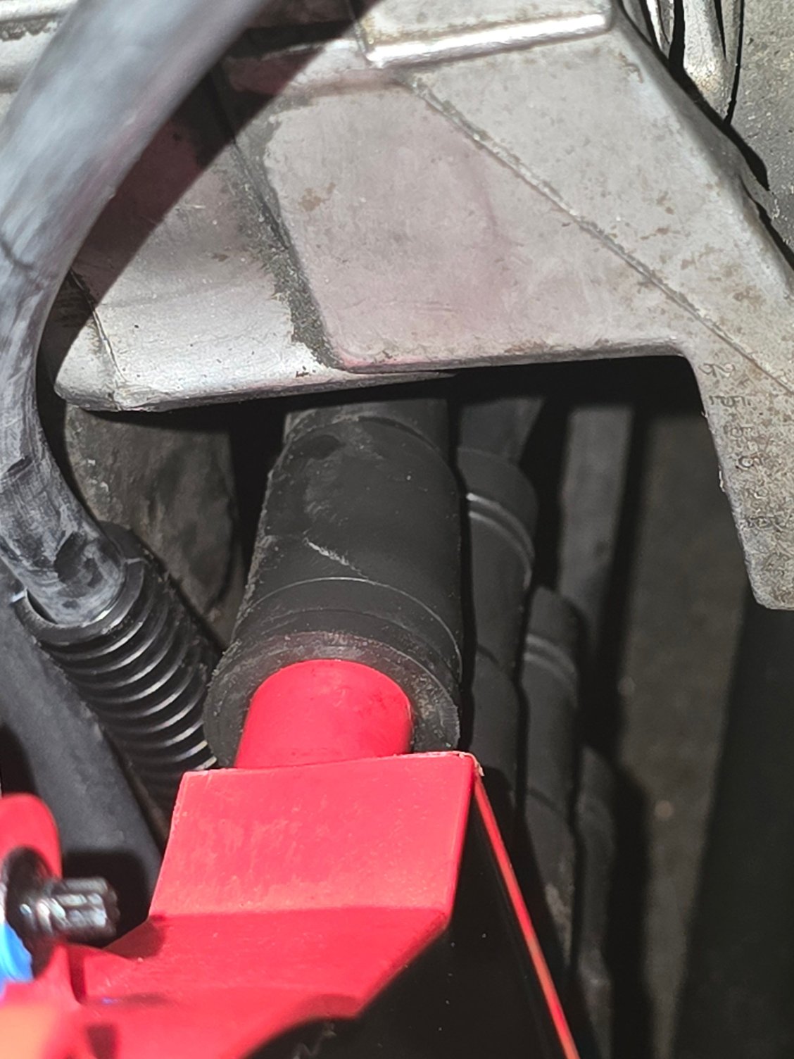

Thanks guys. New opti is on. Will this torn boot cause misfiring? All plug wires are new. But some were a pain to disconnect. I put new ones back in the summer.

Most likely not, the boot is there for protection and weather proofing. Now whether or not the torn boot will lead to the plug wire failing sooner due to corrosion or something like that... Maybe.
