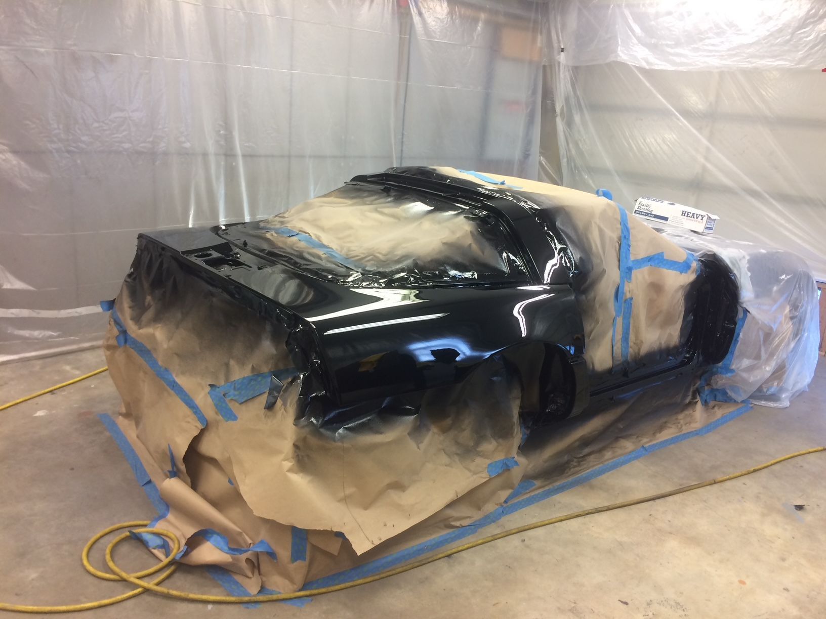

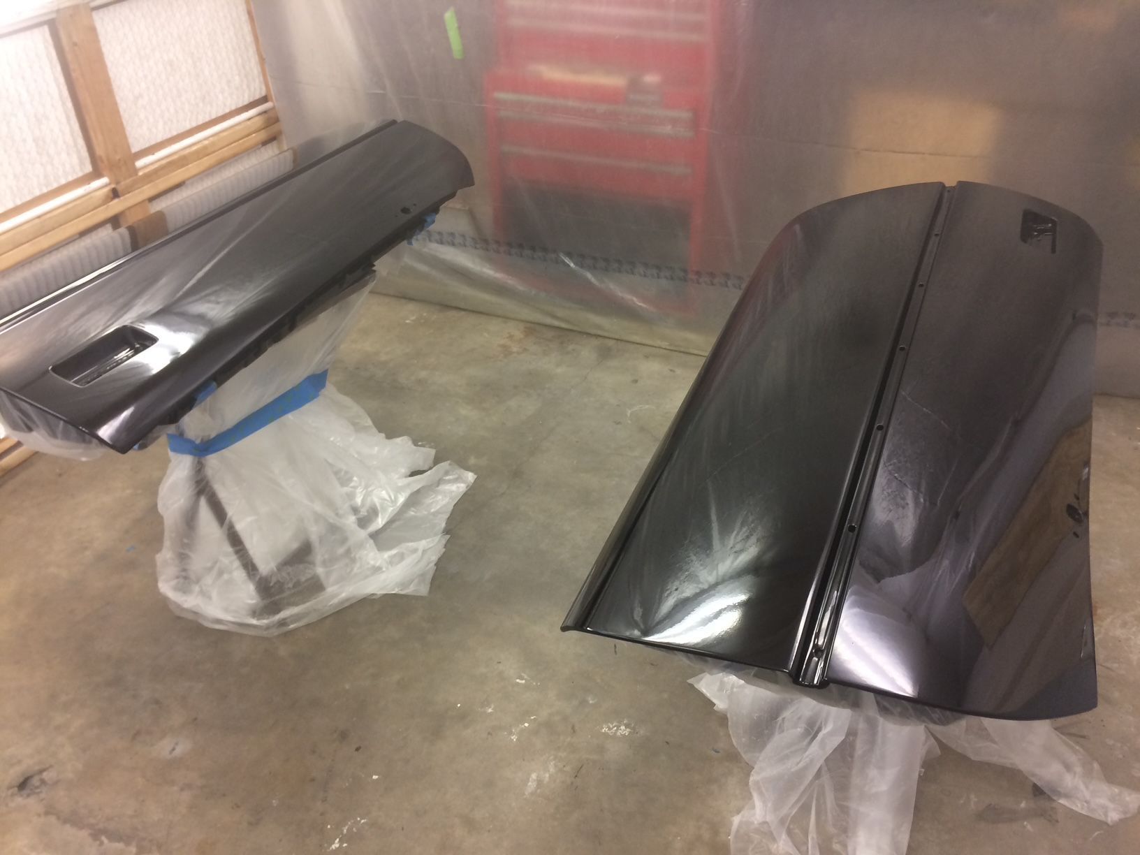

I had five layers of paint to remove and the door jambs were really rough so I had to remove the doors to sand them. I usually work alone so I made a jig to remove and install the doors. I used a padded moving blanket on the jig to reinstall.

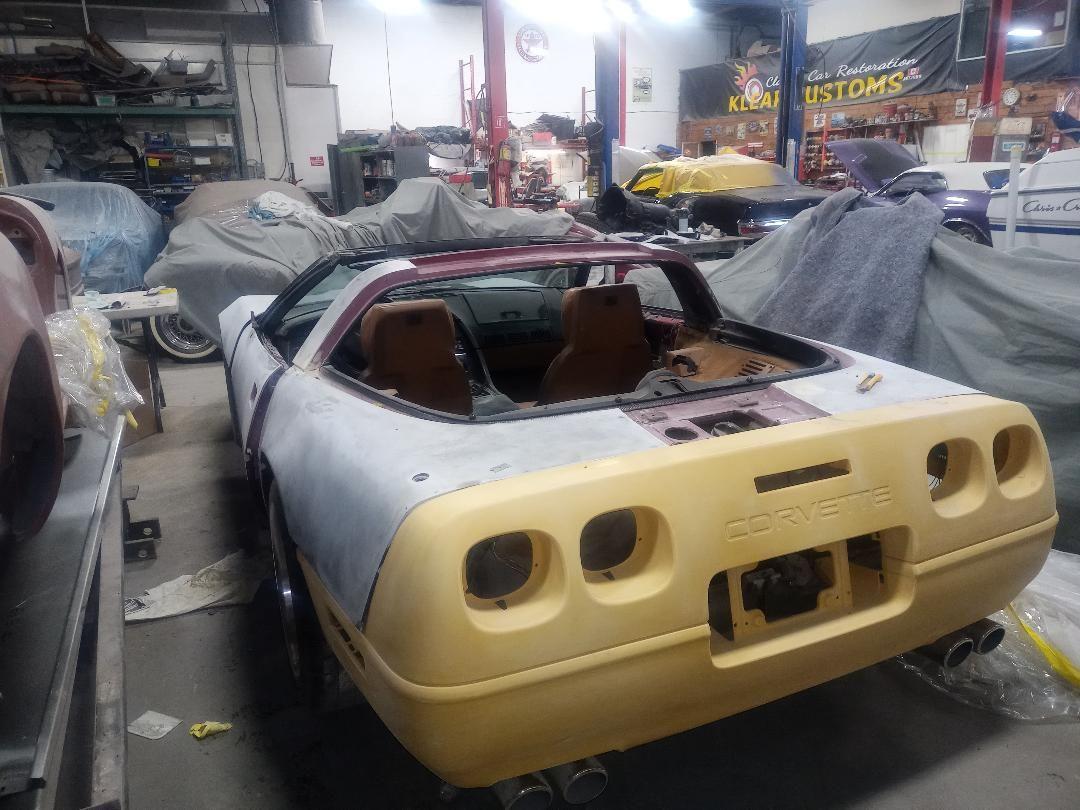

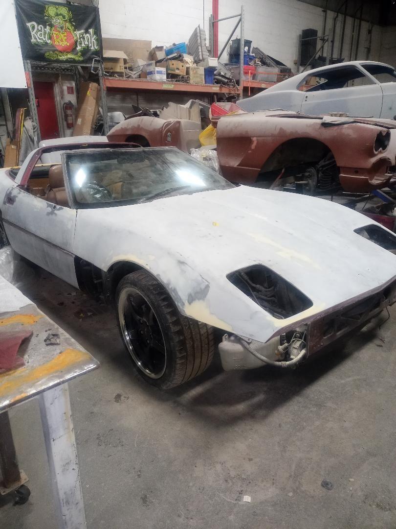

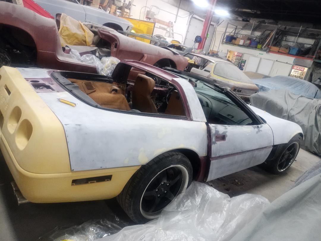

Here are a few pics, car is almost ready for primer, block, primer then paint, going with daytona sunset orange ,i still have to remove the doors, rear bumper is a later c4
