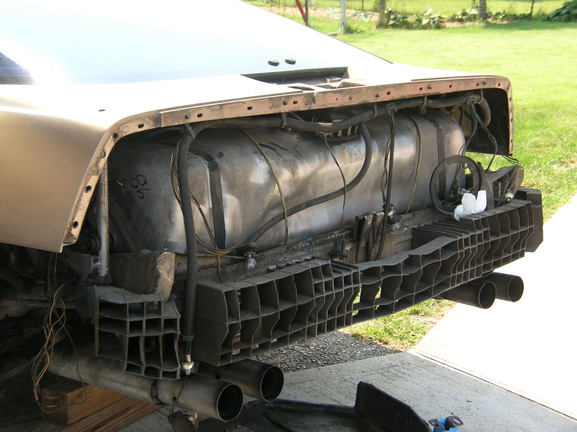

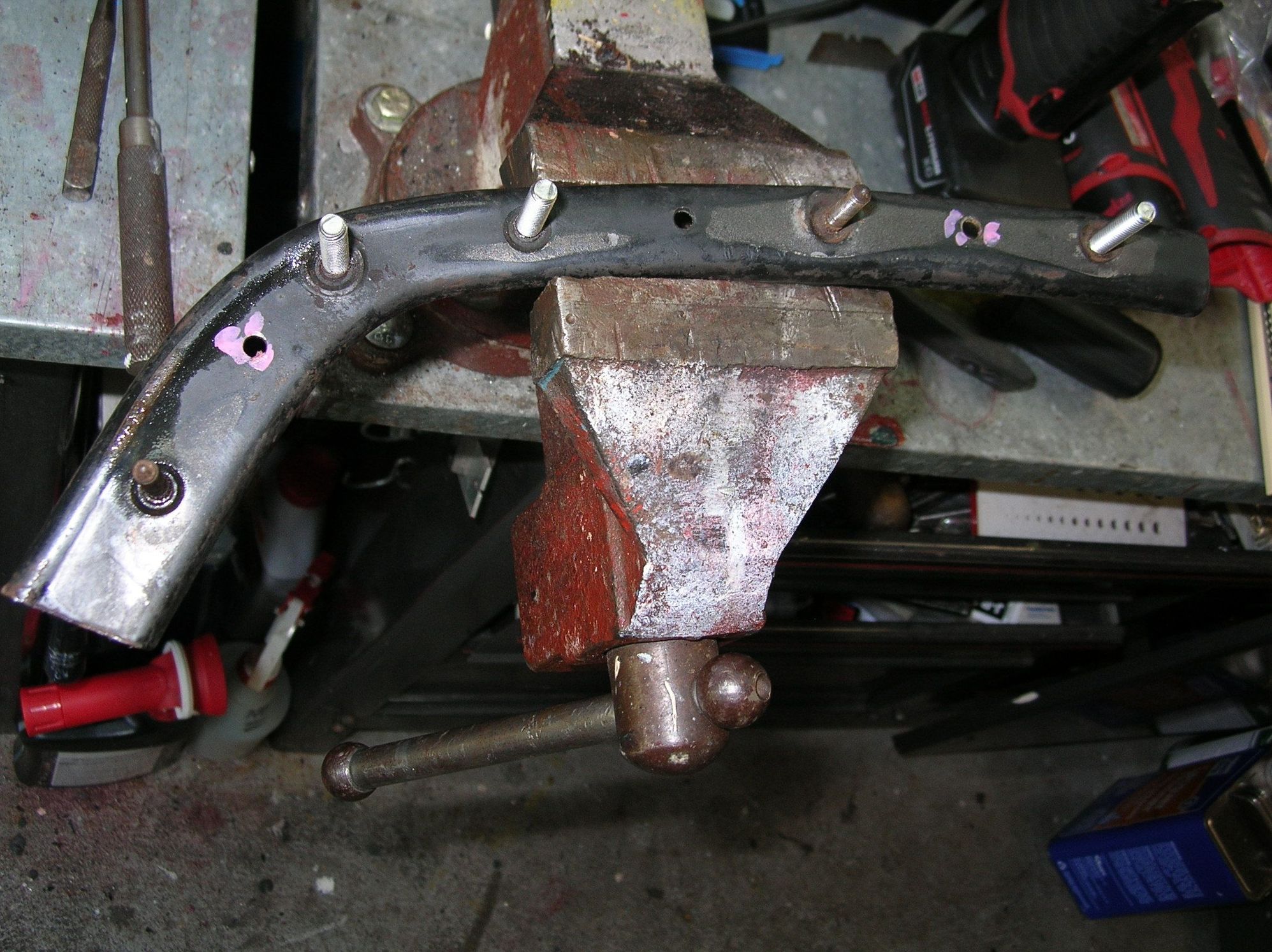

I had to replace the tank when my pump failed. the PO JB ed the access panel to the tank and stripped all the screws.
Thete was also some corrosion and rust on the bottom so I figured do it now. That job sucked as every screw broke.
I used the Walbro and its been great. .
